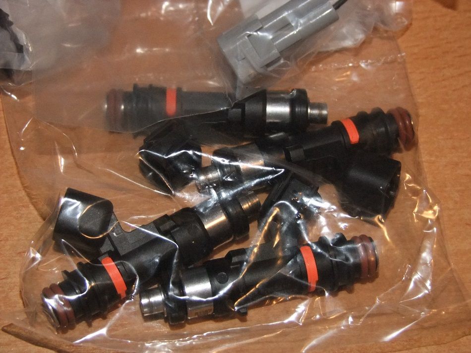

Some parts arrived to help with my quest for more kilowatts, thanks to AFI South, some 1000cc injectors with plenty of head room for E85, they also supplied some adaptors for Denso to GM plugs so I don't have to cut any wires.

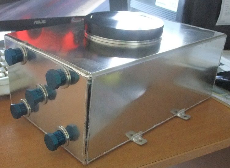

And some more parts turned up today from Frozen Boost.
Ice water reservoir and water to air intercooler pump, this pump is designed by Bosch and Ford specifically for water/air APPLICATIONS and is used in supercharged Mustang Cobras and supercharged Mercedes.

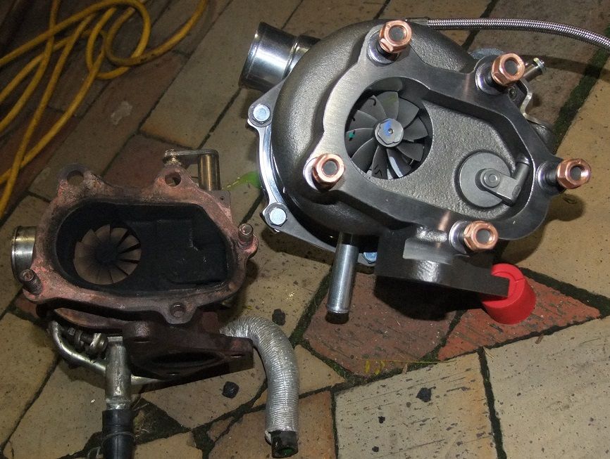

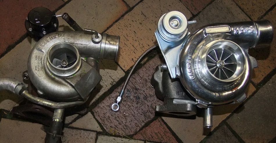

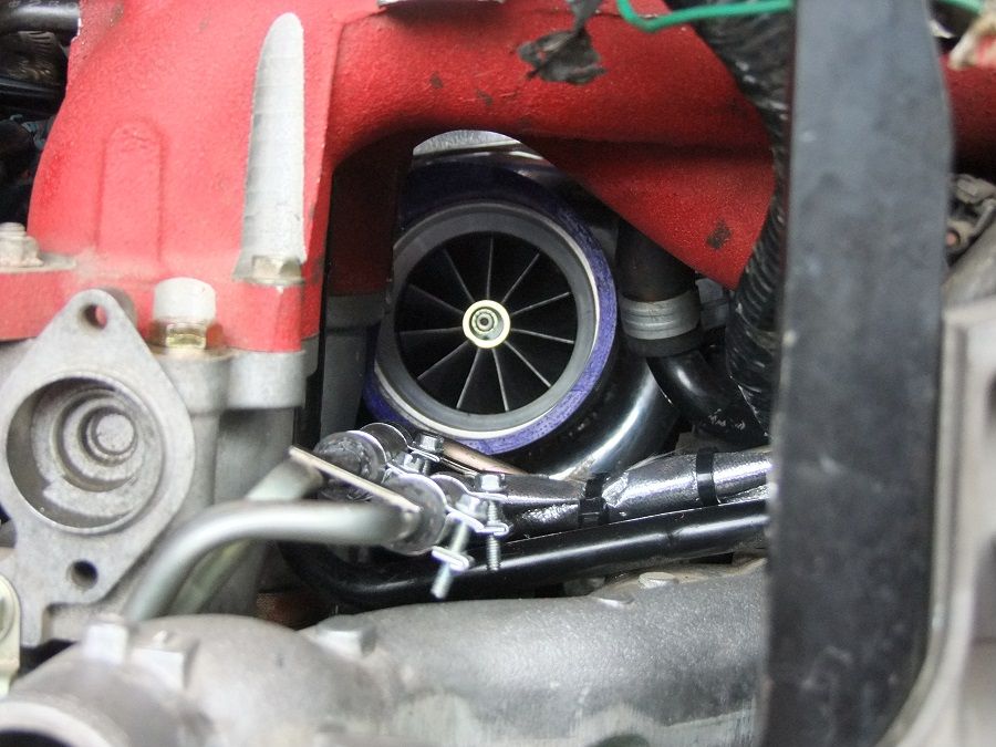

Turbo is on, just need to fit the injectors and some phenolic spacers to the inlet manifold and fit the ice box.
There is a massive size difference between the turbos.
I thought my motor used a VF30, its actually a VF35

Wally September 18th 2014 02:03
Familiar pictures... I had a VF34 and the difference with a Blouch DOM3 (= Garrett GT3076R with a small-ish hotside) looked like that too.

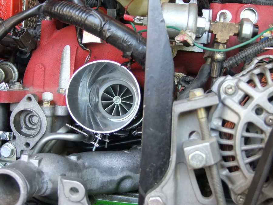

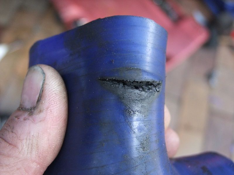

Its nearly back on the road, check of the tune next week.
I think I had a boost leak, I wonder how it would have gone at the 1/4 mile without a split in the hose just after the turbo.
http://i1184.photobucket.com/albums/...7.jpg~original

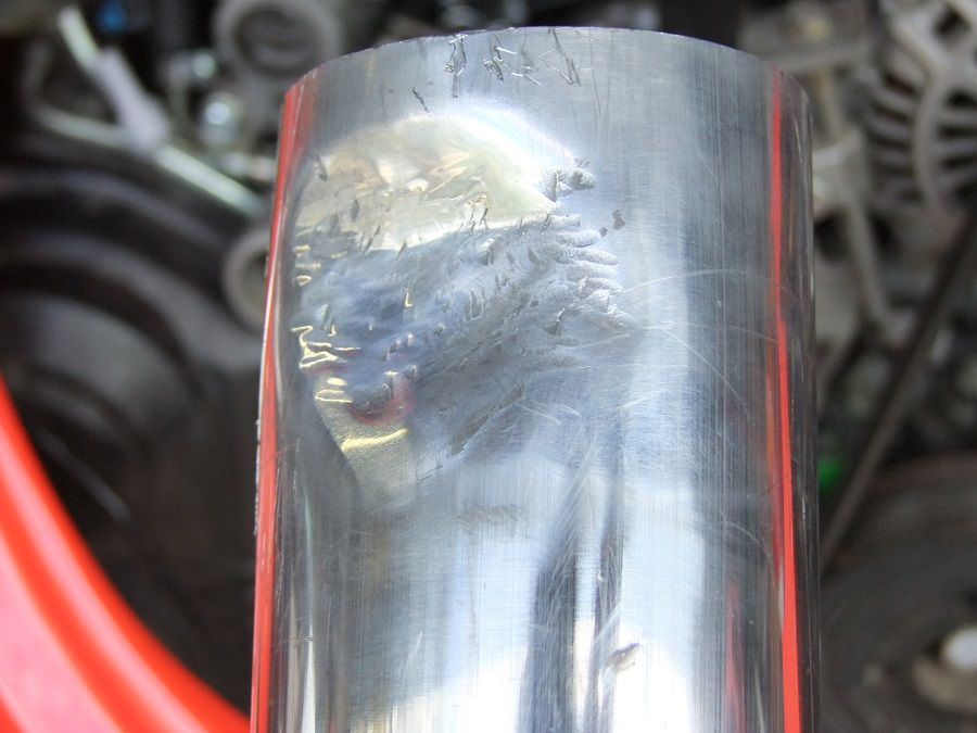

It was a bit of challenge to fit a 3 inch inlet under the Subaru inlet manifold. Needed a bit of hammer work.
