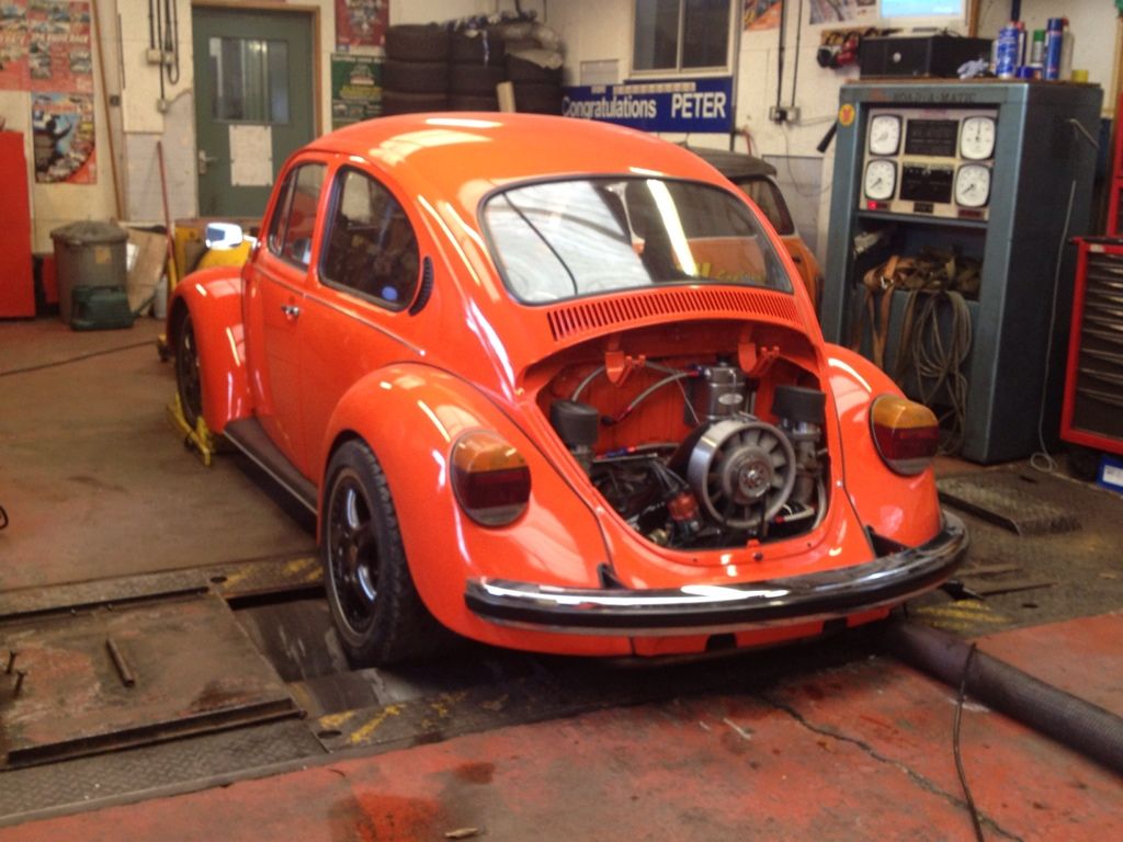

Also I took it to the rolling road as it was a bit rough low down. Went up a size in idle jet size has made so much difference, it's lovely to drive! It also made a very surprising 148bhp at 4800rpm!! Nt bad for a turbo spec lump! Can't wait to get efi and turbo on it!!

Wally March 22nd 2013 08:42
Nice dyno result! Matching with the turbogrind's low duration and relatively high lift.

Cheers wally, very pleased with the result! Thanks go to rob for assembling the motor!
