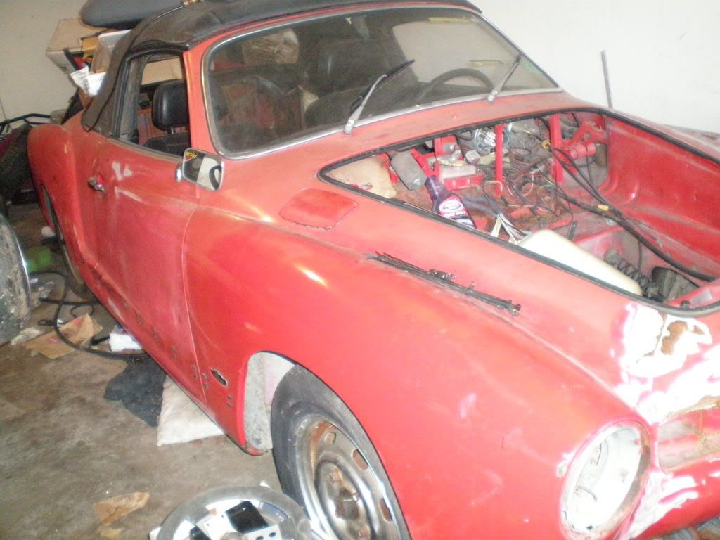

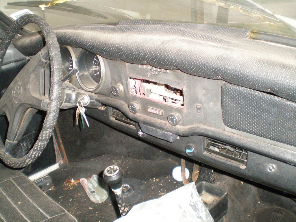

bestjewelgash May 6th 2008 12:07
Where’s Mickey?
Doing the same but with a 1.9 TDI + mods hoping for speed and 45-55mpg.:cool:
http://i293.photobucket.com/albums/m...3.jpg~original
http://i293.photobucket.com/albums/m...6.jpg~original
