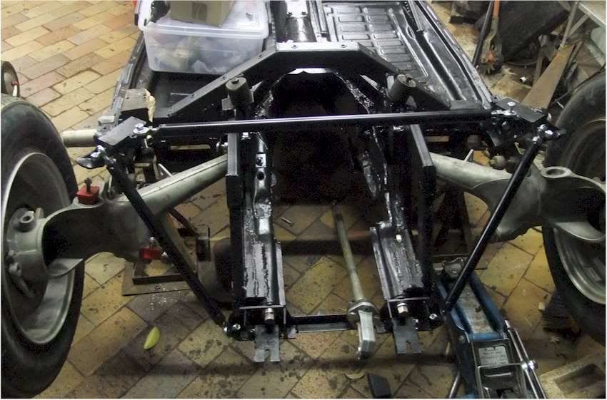

I see your kafer bar but does it have the strut that connects to the frame horn at the inner trailing arm mount? Are you running heat exchangers?
I have been pondering this installation for some time and I sat down with my friendly structural engineer and crunch a few ideas and numbers:
To retain the heat exchangers the strut from the tranny cradle needs to bend around the heat exchanger and connect to the damper top bolt bracket. this bent strut needs to be stiff in bending so a thick wall tube will be required but the loads are relatively light. We did also discuss adding braces back to the cross bar but decided that put the bar in too much bending.
Your arrangement looks suspect from the photo. The tranny strut should not connect to the crossbar as again this will put the bar into a bending stress. Without the forward strut to the trailing arm mount the load from the tranny strut will apply a bending moment to the upper damper bolt that is only 10mm diameter. This load is cyclic and expect the bolt to fatigue especially as a rally car will flex the frame horns unmercifully. The position of the tranny strut on the crossbar accentuates the bending moment. Because of the geometry, the forged damper strut will also be put in lateral bending.
Sorry to be negative and if I have got it wrong I apologise but it easier to discuss this now rather than at servicing on an event.

To me the Kafer cup bar having the attaching points inboard from the shock bolt reduces the triangulation affect that your trying to achieve.
I have one of Lanners bars on my sons bug, fits great with heater boxes or A1s.

Thanks for the comments on the brace. Having thought about it a little further, I think you guys are correct, and will need to rework the brace I have or look at some other options. For much of the afternoon I was thinking about how the factory cars didn't have any bracing...and then it hit me. "oh right, they weren't coil over conversions" :P I think I'm starting to rethink things far too much!
So I guess at this point I should break it down to the basics:
1) I'm going to be running heater boxes
2) Due to #1 I determined that a 3 bar setup was the way to go.
3) Will either need to move the mounts on the current bar or look for another option.
Moving the mounts will likely require longer bars, so I'm heading back into fab-territory any way I slice it.
Hmmmm.

the kafer brace that you have on your car is a poor design, sorry. if your running coil over rear then i would strongly sujest you run a 5 bar brace as the loads that will be fed into the top shock mounts is going to be very high. i would brace the top shock mounts like the class 11 Baja cars do for peace of mind. you dont want to be bending or brakeing them.

+1 on that style kafer brace, but only from personal experience. Don't get me wrong, it's better than nothing, but it doesn't do much for the frame horns. I still have one on my car but I'm going to upgrade to a mendeola bolt in kafer brace.

Don't worry guys, after giving it about 30seconds of thought from the original couple of posts I realized the bar was a no-go. Initially I thought I'd bolt it up for now and fix it once the engine is in, but then realized the oil cooler would be in the way. Thus, I've been digging my engine and heater boxes from storage so that I can rework what I have.
This is one of the reasons for posting up the build in a thread like this, find the problems before I'm committed to them!
car looks great by the way :D
The possibility of a 5-bar brace was eliminated due to retaining the factory heat...but perhaps I'll revisit that now that I'm tossing the engine in and going custom anyways. The class-11 setups I've seen all mount the shock inside the body to the roll bar. Ideal, sure, but I didn't want to cut the body up.

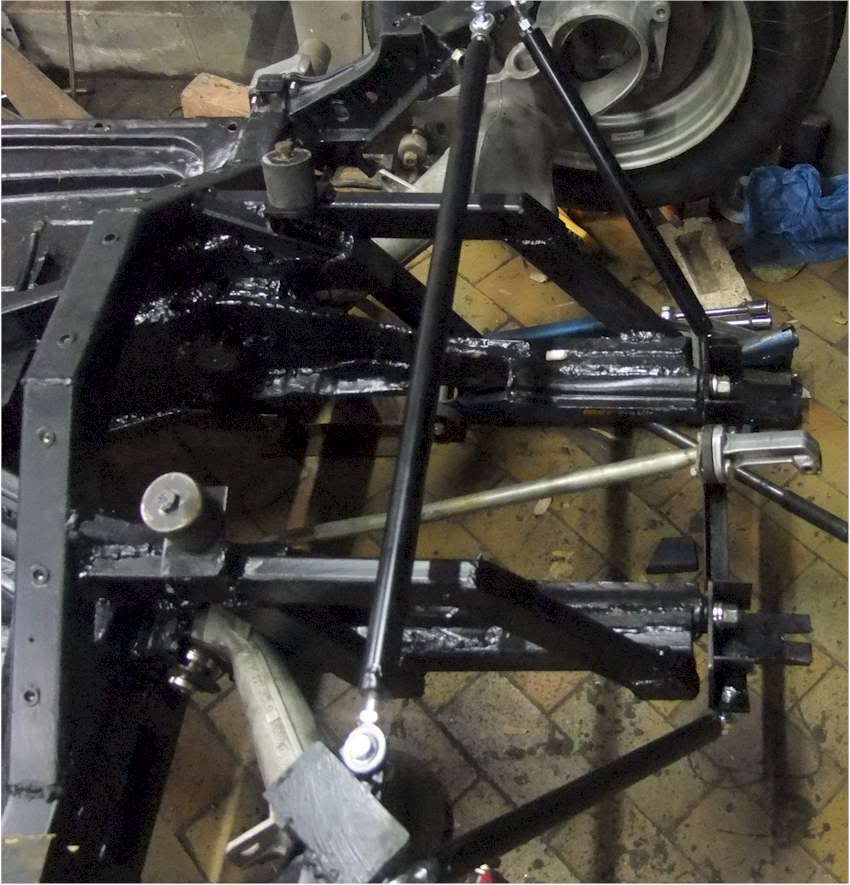

I made a 3 bar setup with some eBay rose joints and a bit of molly tube, the molly tube is much smaller in OD than most conventional Kafer cup bars which is handy when space is tight.

one thing i would check on the kafer brace is clearnace between the bars and the drive shafts at full bump. building it on axle stands and full droop it looks like you have lots of room but with the suspension fully compresed its going to be tight.
a few of the bars i have fitted have had to be reworked for clearance.
