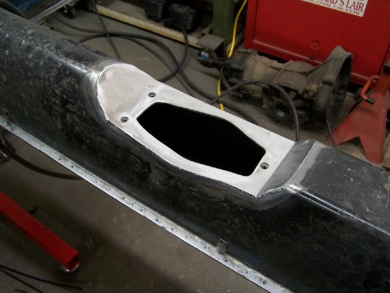

Well, since I couldn't go to eurofest because of some work that came in unexpectedly :mad: I did make some time today to make a new monting plate for the 915 shifter, and TIG weld it in...
http://i52.photobucket.com/albums/g3...8.jpg~original
chug_A_bug October 18th 2009 22:06
Crazy SEXY.....it's like car art
Chris
Bug@5speed(US) October 19th 2009 00:12
That's some nice welding..
Jealous.
NO_H2O October 19th 2009 09:27
Nice job. Keep it rolling.

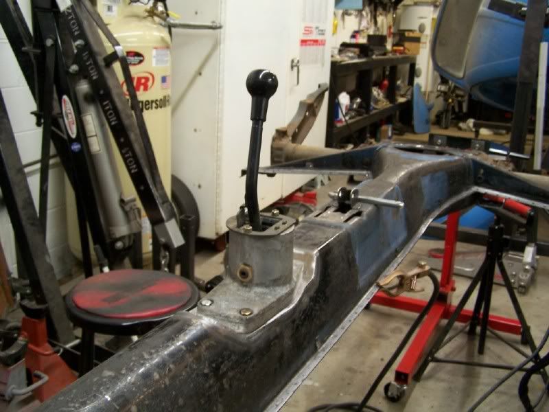

wrenchnride247 October 24th 2009 21:54
Got some more done today. I now have plenty of clearance for the CV's! Also, seam welded the frame horns up.

ricola October 25th 2009 13:59
Lovely welding, but I hope you are putting some strength in elsewhere as those framehorns have been severely weakened...
wrenchnride247 October 25th 2009 21:58
I have thought of that Ricola...ran out of time to do that part (quit rushing me! :) )
The steel I used to "fill in" the part I cut out is 1/4" thick and is fully welded, but will add some material under the frame horns just in case.
Panelfantastic October 26th 2009 09:43
I didn't realize the CVs on the 915 conversion were that much of a clearance issue?
Pretty easy to beef that area back up though. Work is looking awesome!
