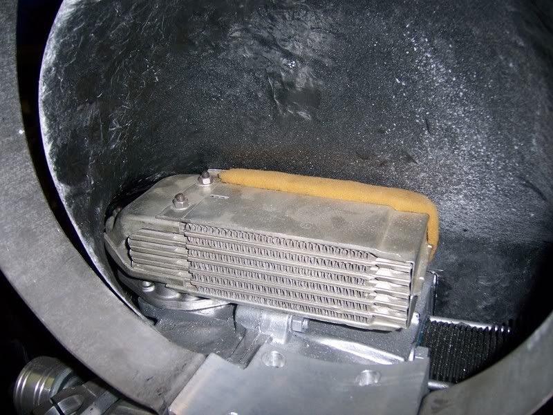

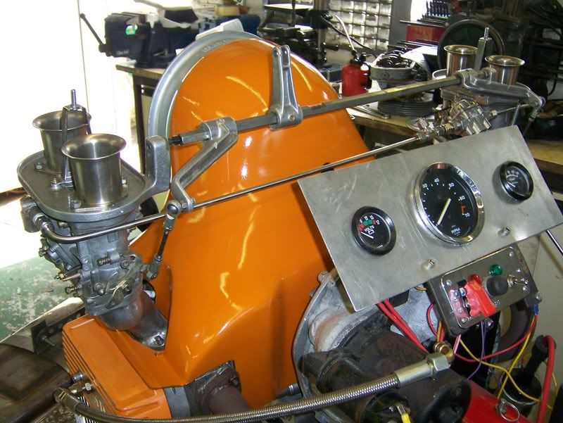

i have fitted an oil cooler in my fan housing type 1 remember without modding the fan housing
wher i live a guy near me flys vw powered planes and he use to make the adaptors which i managed to get one of him to retain std cooler also running thermostat and external cooler with mine just hope it will be ok i have ran it up on my test bed and did seem ok

That's a sweet test bed. Without any shrouding for the oil-cooler, I'd be concerned about airflow. Path of least resistance is around the oil-cooler, not through it.
vdubzack October 3rd 2009 13:21
AMEN Brother!

I have about 2,000 ks on a motor in my daily driver/sons car. Its a 1904cc, stock valve heads, mild cam, twin 40 Dells etc.
I got rid of the stock cooler and fitted a cooler in the front of the car, doesn't overheat on 30 C plus days, highway or heavy peak hour traffic and warms up quick, I have a fan on it for insurance but its hardly ever needed.
Its fitted behind grille in the front apron, but the Kamei blocks it, I'm reluctant to cut the Kamei so the fan is sometimes needed at high speeds.
The point I'm trying to make is if your internal cooler doesn't work to well, make sure you fit the external one in a good place.
old gh bug October 5th 2009 10:11
Hi Steve thanks for advice i do also have an external one fitted with thermostat plumbed in but will be somewhere like above gearbox as dont have option of putting up front like on an 03 model so i hope it will run ok
