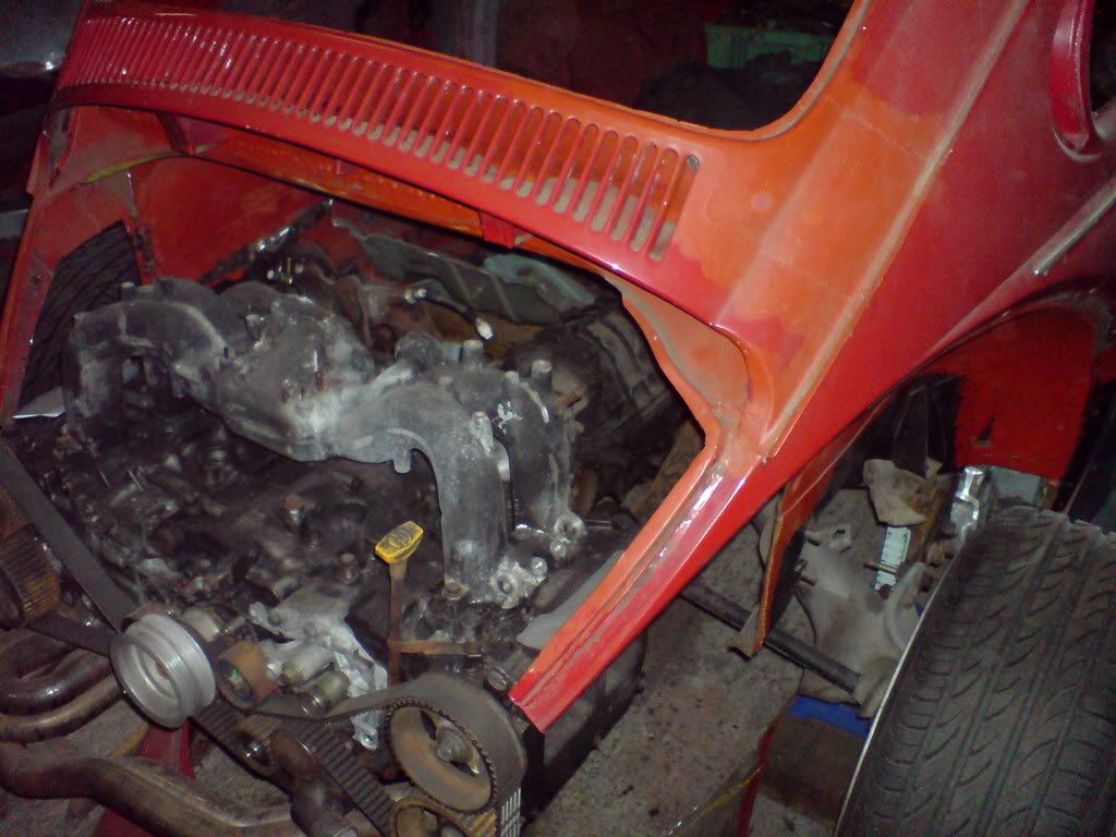

Thanks for your interest and comments guys. All in all i have raised the engine and box 2.5 inches and moved it forward 1.5 inches to keep the driveshafts tru. the cam wheels have come outside the body work but the sump and exhaust are no longer dangerously close to the floor, which was the plan as in gonna run this car low. I will be making a subframe in the rear end which will help with strength but also provide mountings for the coilovers and the rear end bodywork. heres some more pics of how the box sits in the bodywork. Gotta love that rust repair rich ive cut out half the work i did to get my shell solid LOL.:lmao:

what do you mean by the cam wheels have come outside the body work? and also do you have any other pictures of the rear tranny brace you fabbed maybe of it off the car? I'm very interested on any progress you make looks like a nice build. good luck. -John

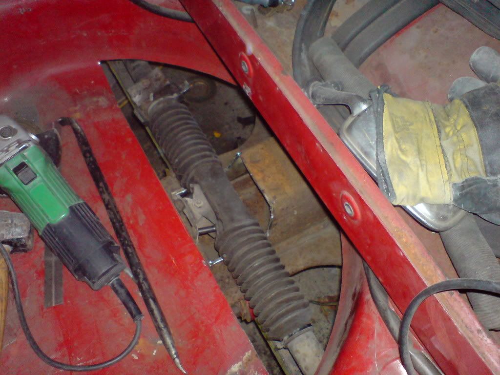

Got cracking on the rack conversion yesterday started taking some step by step photos didn't think i would need to cut so much out but least its in there just got to plate up the chassis now and mount the rack on the body.
http://i178.photobucket.com/albums/w...1.jpg~original
http://i178.photobucket.com/albums/w...0.jpg~original
http://i178.photobucket.com/albums/w...3.jpg~original
mccarthy500. I will need to clearance the wings because the engine is higer up than usual the cam belt pulleys will be outside of the bodywork. When i remove the rear mounting for more bracing i will take some more detailed pictures for you. Thanks for the postitive feed back.
effvee January 19th 2008 02:18
Sub
Hi, if I remember correctly, someone said in order to mod a rack; there was only some dimpling of the spare tire area? From What I see that a whole lot more than dimpling the spre trie area. I plan on doing the same, but I really have reservations about cutting the center section? Anyone have a different method? Or is this the only way, if someone choose to mod for rack and pinion.
JIMP January 19th 2008 02:33
Hello effvee
you should look to your car, depending on the model there is chance that this "cutting" is already there to your pan..actually I couldn't help myself find out how do you seperate the models with the cut from the models without cut, eg. my car (1303) was older than my friends car -we saw the vin numbers- and was ready with the cutting from the factory, so nothing to do, and my friends which was newer -still 1303- (and was more normal to have the cutting as it was closer to the models with r&p) hadn't had and we had to cut and fabricate what you saw, that fact didn't made any sense to me so I think that the only way is to see with your eyes if there is the cutting or not
Hope it helps
Friendly
Dimitrios
1303R January 19th 2008 11:14
did vw change to the clearanced cassis for the steering rack,when they changed to two bolt struts? the mounting for the track control arms was altered then as well. i have an early 1303 which was three bolt strut and i had to mod the cassis as well when i went to steering rack
