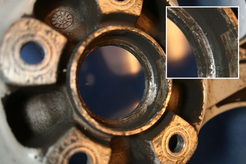

do we know that the hub on all 944 NAs are 71.5 or 71.6, whatever the number is?
Yes. 71.5mm to be exact. All 944 hubs are the same wheel bore. I have 993 cups 2's on my 944NAs on my bus and everything is lovely. If they changed the wheel bore, they did it after the 993's. Also, are we sure it's a diameter problem and not a depth problem?

davetaylor March 1st 2007 23:11
one could maybe call it a depth problem. here's a picture of where it rubs:
http://i91.photobucket.com/albums/k2...3.jpg~original
so the bore is fine until it hits at that point, i guess.
LLVWGL March 2nd 2007 00:50
maybe you could just mill the centering ring down a bit? My 993 cup II fit like a glove!, maybe the later car had a shorter centering ring. :confused:
BTW, a set of cheap dial calipers can't cost more than $10 at harbor freight, that way you can tell the machine shop exactly what you need milled off. Besides, they are so handy!

it appears that if i machine down the wheel center then the hub will stick through, but if i machine down the hub will have have an exposed bearing?
