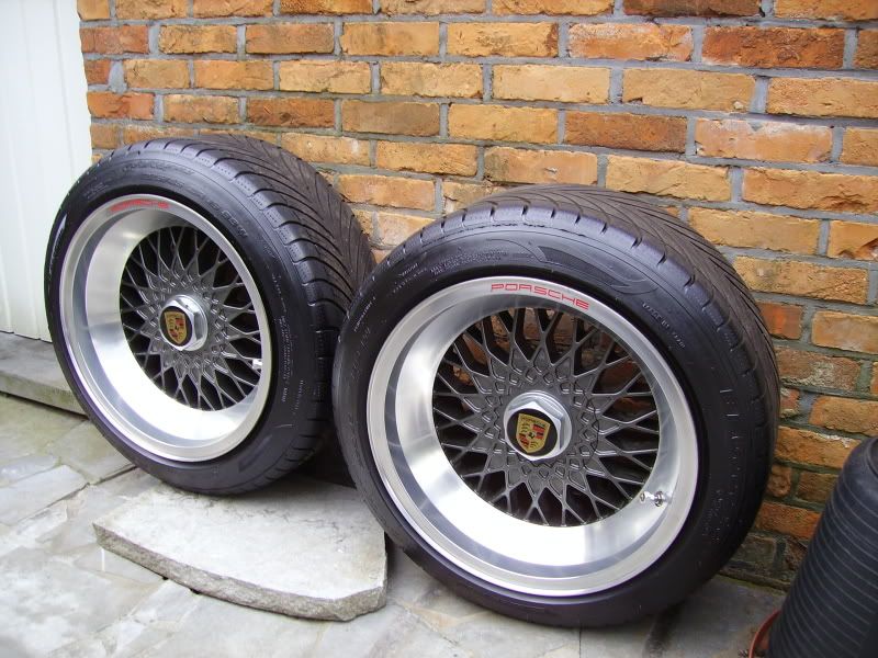

orange b February 20th 2010 20:48
sorry, I can not good write English language, but I try...
I have these wheels under my car...Enkei, produced in 1983, end buy it over 2 years ago, new in the boxes, (found by a porsche dealer)
front: 8J x 16 ET 11. at the back: 9Jx 16 ET 11.
tires : front: BF Goodrich G-force 195/45/16.
Back: BF Goodrich G-force 225/45/16.
http://i109.photobucket.com/albums/n...1.jpg~original
