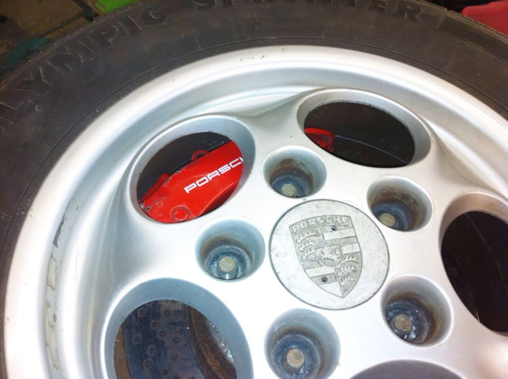

So with a little bit of work the 996 calipers fit BoxsterS rear discs on Steel 944 rear arms inside the 6x15" Teledial :)
http://i357.photobucket.com/albums/o...F.jpg~original
http://i357.photobucket.com/albums/o...3.jpg~original
The mounts I made ages ago for standard 944 rear discs have been spaced & flipped - I may make new adapters or just run with these spaced. This is with a 10mm wheels spacer - hopefully that will clear the bodywork. I'll wait until I have tried it all in the chassis/shell before giving it all a good clean and repaint. I need to do something to centre the BoxsterS disc properly as the centre of the Boxster disc is larger than the 944 disc, so at the moment it just locates on the wheel studs so can move a couple of mm each time I have it apart. I think a centring ring between the two should do it and then drill/tap the hub to use the retaining screw hole in the disc

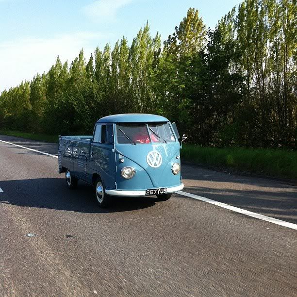

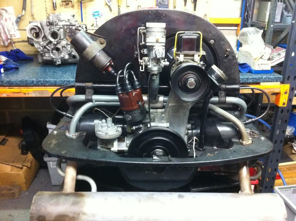

Only 4800miles from new. All the pushrod seals had deteriorated with age, so I had the heads off and gave it a top-end refresh - all lovely and clean inside, with the VW logo still visible on the piston crowns. It was a delight to work on.
Put it back in its rightful home on Monday evening - a '56 Single-Cab - and it ran beautifully. Having managed to then get it registered Tuesday, and the plates sorted on Thursday, yesterday I took it to the Apex Festival at Lydden Hill. Didn't miss a beat all the way there - with an average of less than 85miles a year over the last 57 years, but not turned a wheel in decades, we thought of just having a few local trips in it first, but in the end we thought what better thing to do than a 200 mile round trip to test it? We even overtook a Bay-Window on the way!
While at the circuit I thought it would rude not to put it around the track - no seat belts, very slippery seat, 30hp, Crash-gearbox... Brilliant fun! Managed to hit 50mph on the main straight before dropping into 3rd and braking to 40mph for the left-hander where the back stepped out :lmao: Myself and my mate sliding around on the passenger seat were in absolute hysterics - he reckons it was almost as much fun as his 911! I wonder if the boss will let me build an Okrasa engine for it?

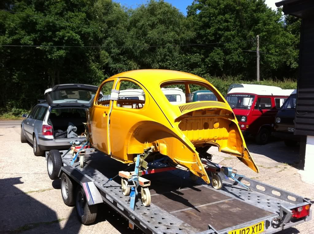

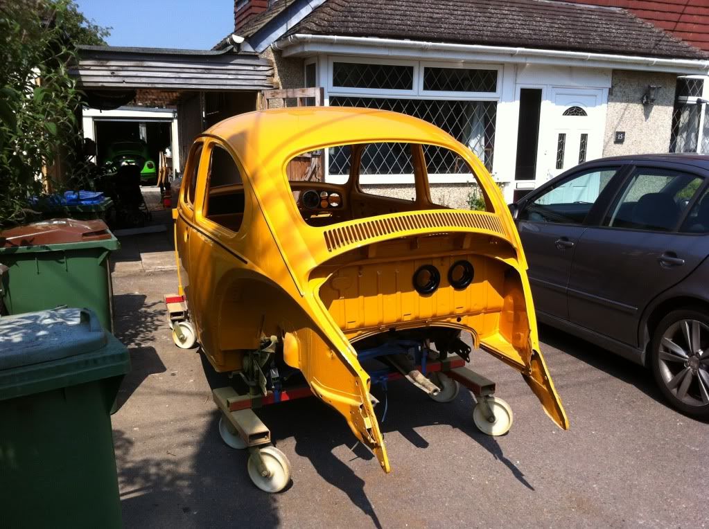

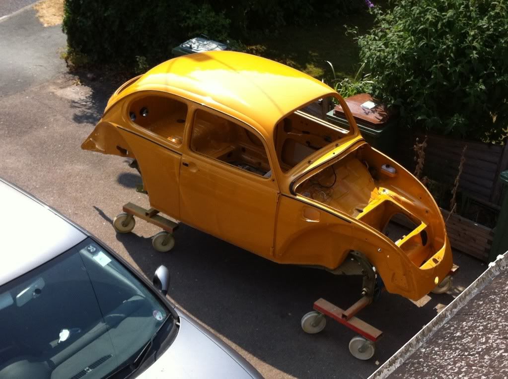

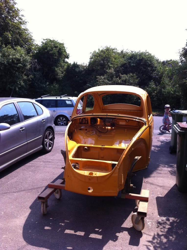

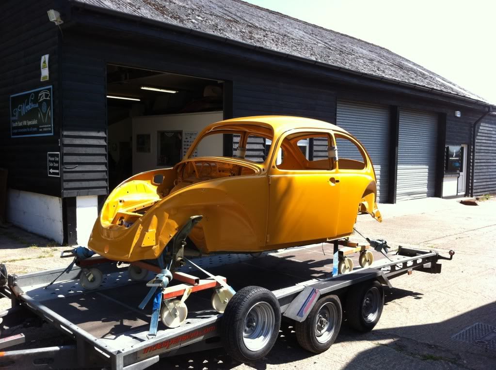

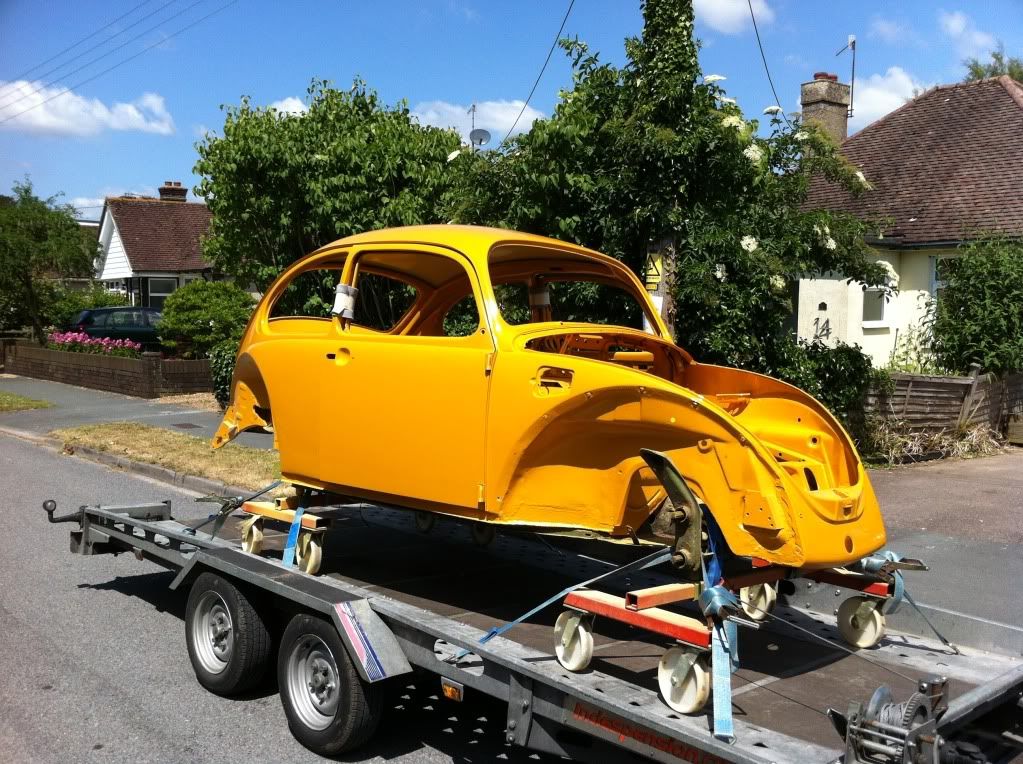

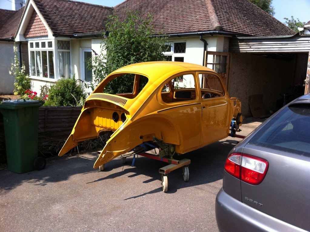

So finally I have it back!
I managed to finally get a day off, up a the crack of dawn, buzzed into town to hire the trailer (lucky to get one with Goodwood Festival of Speed just down the road and virtually no trailers available within 50miles). Off up the motorway again and got to VWorks just before Sam rolled in. The Bug was looking great in the sun, and the RIGHT shade of L16M Tunis Yellow this time.
http://i357.photobucket.com/albums/o...l.jpg~original
http://i357.photobucket.com/albums/o...1.jpg~original
No trauma getting it home, but getting it off the trailer and into the drive on my own was a bit of a mission.
http://i357.photobucket.com/albums/o...4.jpg~original

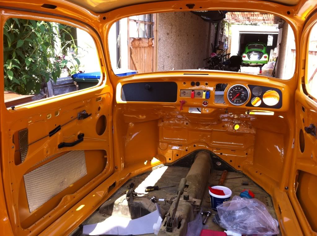

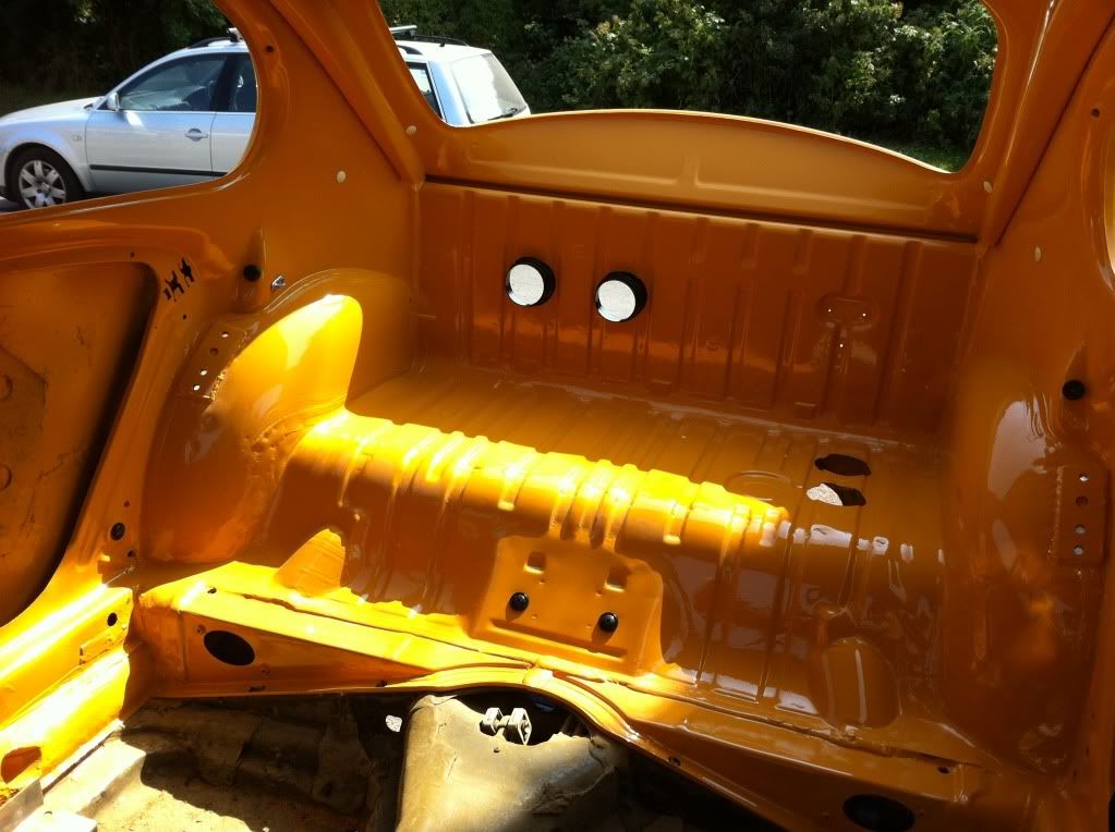

With the glorious weather this weekend I managed to get some time to fit up the doors properly and start fitting up a few trim pieces.
http://i357.photobucket.com/albums/o...7.jpg~original
http://i357.photobucket.com/albums/o...6.jpg~original
Interior looks just as good as the outside :-)
Can't really do much on the chassis at the moment or even bolt the shell down properly yet - weld-in mounts for the Race seat should be here this week, plus a small repair on the battery tray area, before I can get the pan blasted and painted and really charge into it. Looking forward to it :-)
