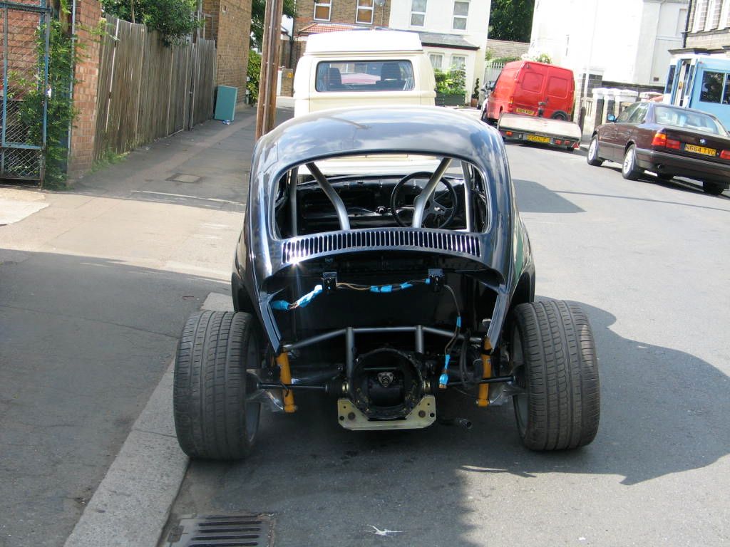

[IMG]http://i291.photobucket.com/albums/l...5.jpg~original~original[/IMG]Ok its been ages since Iposted any pics life's been HECTIC to say the least.
Some pics are old but this is how the build has roughly progressed.
[IMG]http://i291.photobucket.com/albums/l...6.jpg~original~original[/IMG]
After this pic was taken the car went off to have the subaru engine conversion bodged up and thrown in by the UK's so called Subaru Engine Conversion Specialists:angry::angry::angry:.Fast forward and after the interior was fitted and the car was road tested the gremiln's started to raise their ugly heads.And trust me there where tons of them..:angry::angry::angry::angry:......Fast forward again and after some successful legal action and money back my way the engine has been pulled.And all the other crap they fitted has been removed from the car.

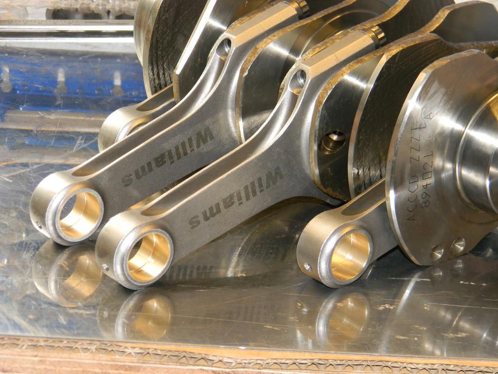

TAKE TWO freshly built 2003 STI Engine[IMG]http://i291.photobucket.com/albums/l....jpeg~original~original[/IMG]

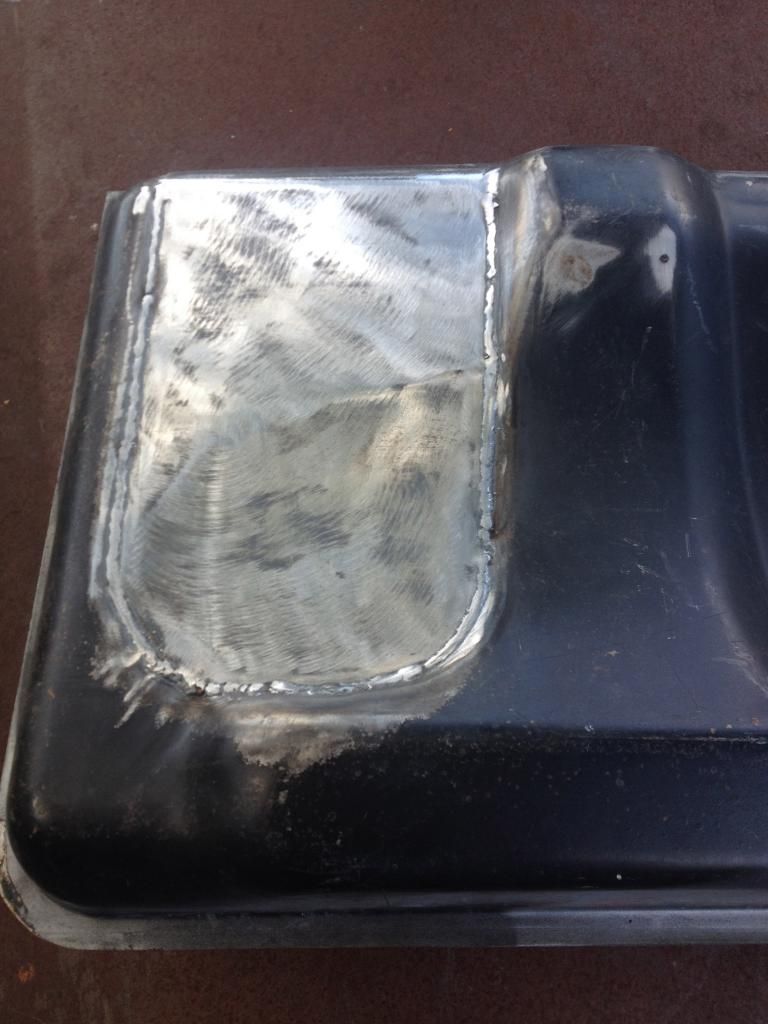

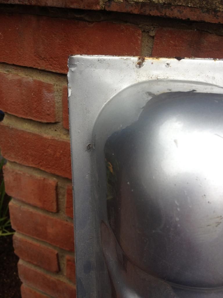

graham October 6th 2014 04:13
My attempt at building GL beetle
a few mods I managed to get done before I went away on holiday.

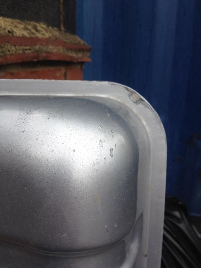

I removed the fuel tank corners as it had taken a wack and I thought they would look neater shaped before[IMG]http://i1185.photobucket.com/albums/...f.jpg~original~original[/IMG]
after
http://i1185.photobucket.com/albums/...e.jpg~original
added some holes prior to welding in plate for added fuel capacity and a 12 mm fuel outlet[IMG]http://i1185.photobucket.com/albums/...d.png~original~original[/IMG][IMG]http://i1185.photobucket.com/albums/...8.jpg~original~original[/IMG]
[IMG]http://i1185.photobucket.com/albums/...1.jpg~original~original[/IMG]
I managed to give the tank a good clean with marine clean,next step is metal ready and then the inside of the tank is having a coat of Por 15 tank sealer.Shortened oil pick up with added section just in case the sump takes a hit
[IMG]http://i1185.photobucket.com/albums/...0.jpg~original~original[/IMG]

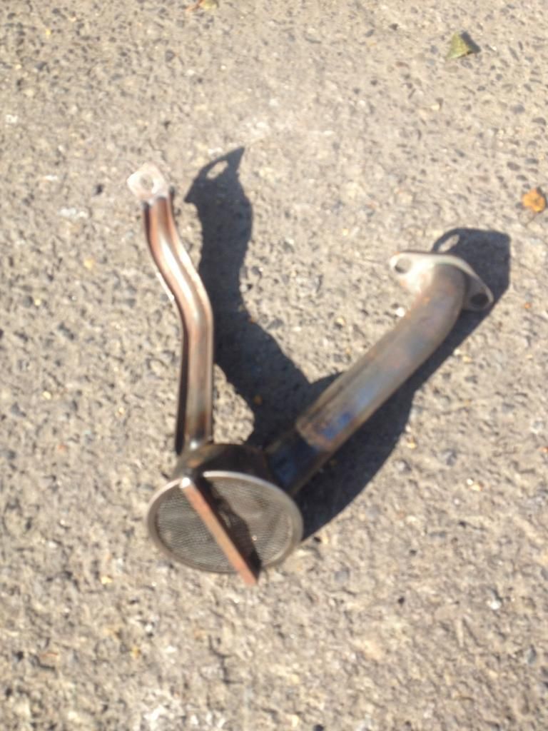

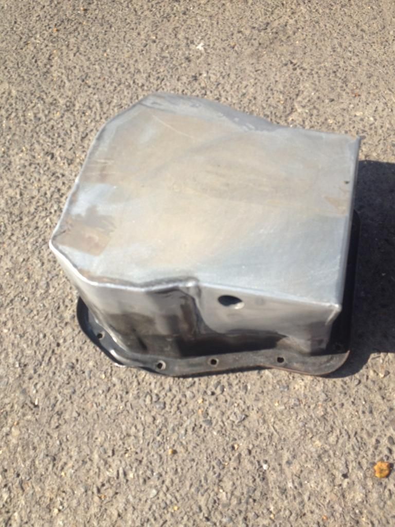

modified sump.cant take the credit for this design as I copied Ricloas idea [IMG]
http://i1185.photobucket.com/albums/...0.jpg~original~original[/IMG][IMG]http://i1185.photobucket.com/albums/...6.jpg~original~original[/IMG]
