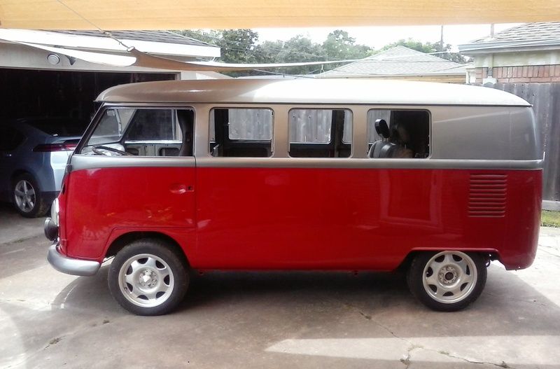

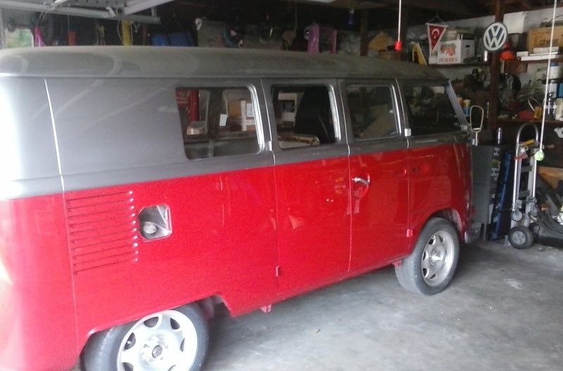

Jadewombat April 7th 2016 21:35

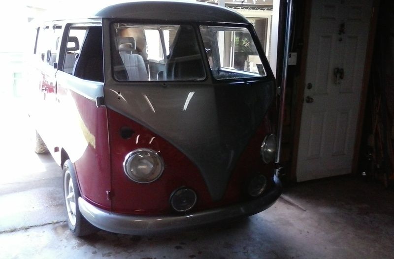

The front glass and seats back in. Cleaned up the front end with a good scrub and some clay treatment.

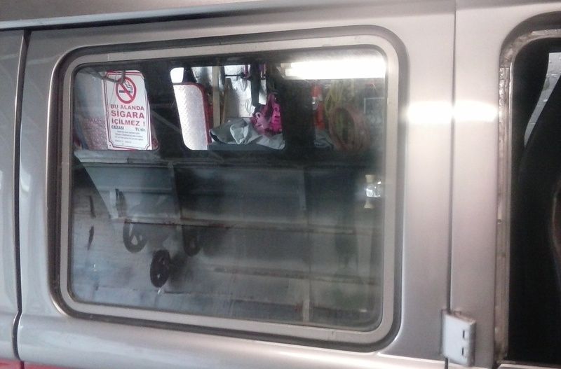

OK, I have a question for you guys. I installed one of the side windows, new seals, etc. It is super tight. As in, I broke one of the latches trying to close it. Eyeballing it, it looks like the alignment is a little closer to the lower edge of the window frame than the upper, but it didn't seem like there is any room for adjustment up and down or otherwise with the tiny screws on the hinge which holds the window frame. Thoughts/suggestions?
Do I need to just let the rubber set in place for a while (days or weeks) until it conforms to the frame, then try to latch it shut? I can't imagine Hanover having to do this, but I don't want to bust another latch again.

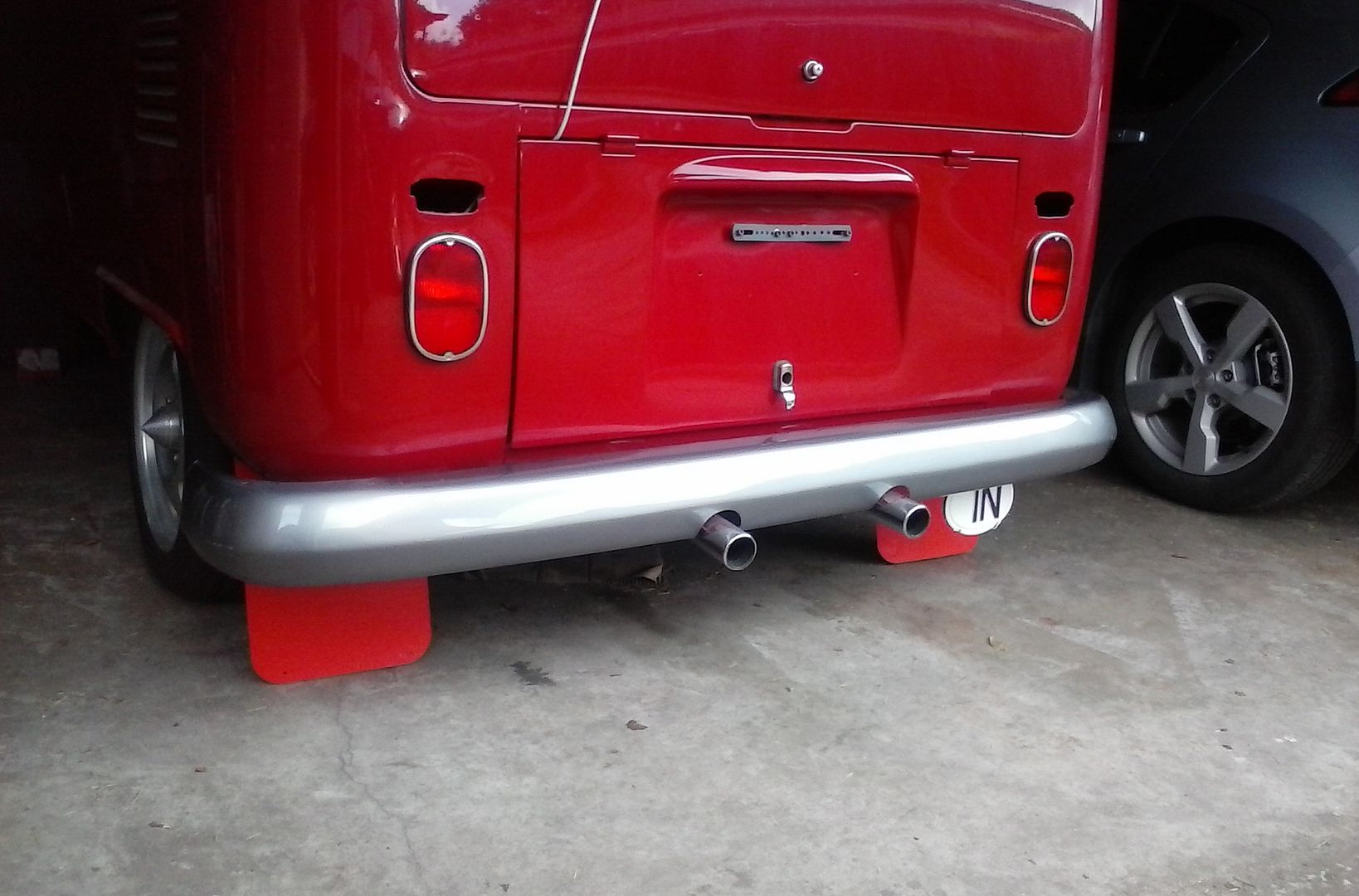

Jadewombat September 24th 2016 11:41

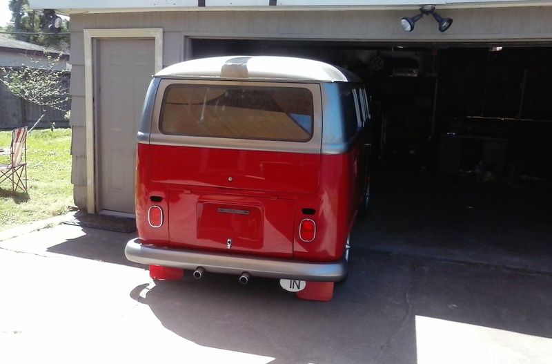

Putting all the parts and pieces back on her still. Got the bumper on and I had to adjust it four times. When I did the IRS swap it shifts the engine down and to the drivers' side about 10mm. I didn't think much of it until the tailpipes didn't line up with the cutouts (those were cut back when it was S/A).
Anyhoo, several "adjustments" to the brackets shifted everything over to where the pipes lined up.

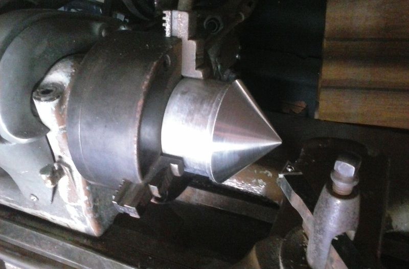

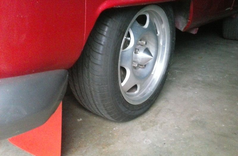

Jadewombat November 5th 2016 15:35

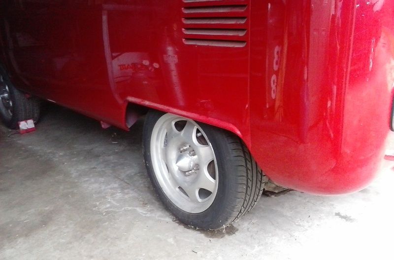

I lowered the front end a little. And by a little, I mean 5mm. I know this sounds tiny, but I'm not trying to slam it just make it level with the rear end. It's almost there I just need to do another 5mm. Also finished the last spike cap. I tried a different approach with the cutter and the finish turned out a lot smoother.

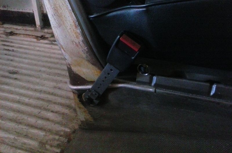

Not too much progress. I got some seatbelts out of a 924 and fabbing up the brackets to get them to work in the bus. A neighbor and his kid helped me get the rear window in also.

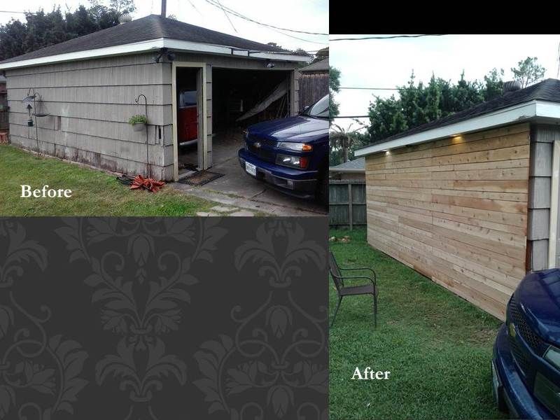

That's a bit better...and a lot cooler inside the shop now with the sun hitting the cedar instead of the shingles on the walls. Going to soundproof the back wall next as the neighbors behind us were complaining. The speakers I put together and the rest of the sound system isn't too big and everything is pointed towards the end of the driveway, but I don't want to piss those people off if they can still hear it in their house.

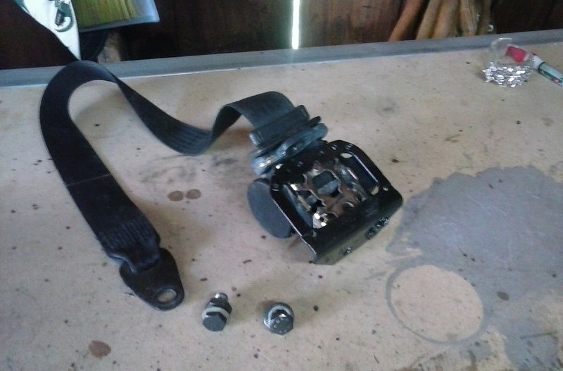

Jadewombat August 1st 2018 21:15
2 Attachment(s)
Got some welding done this week on a bar for the rear seatbelts before I clean up the last of the firewall inside and the floor. Powder coated it today and did a test fit. I ran out of CO2 gas a while ago and have been using flux core wire. Doesn't look quite as pretty, but not bad. Took me a while to put speed holes in the bracket with my bench punch, but of course would've taken considerably longer drilling the holes.
You can see the paws of my helper there up on the shelf, :).
