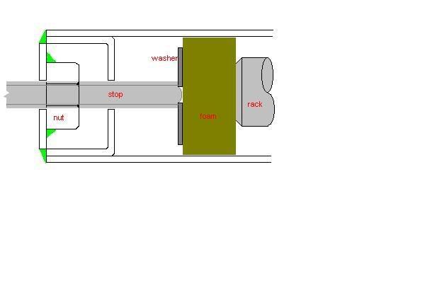

Mat could you draw a simple diagram of how the studs from your steering stop mod interact with the foam bump stops? Kind of like a side cut away of what is going on inside.
MattKab October 29th 2006 17:30
I used stainless steel washers, they were bonded to the stops with glue. The washers are 28mm with a 6mm hole. The studs were filed to have a nipple that turns in the washer, nothing special.
Green is weld. Jamb nut not shown.

The Pirate November 14th 2006 22:40
Thanks Mat. Hope you don't mind but i am using your diagram as a base for a litle something i am cooking up will post the modded pictures a little later. :)
