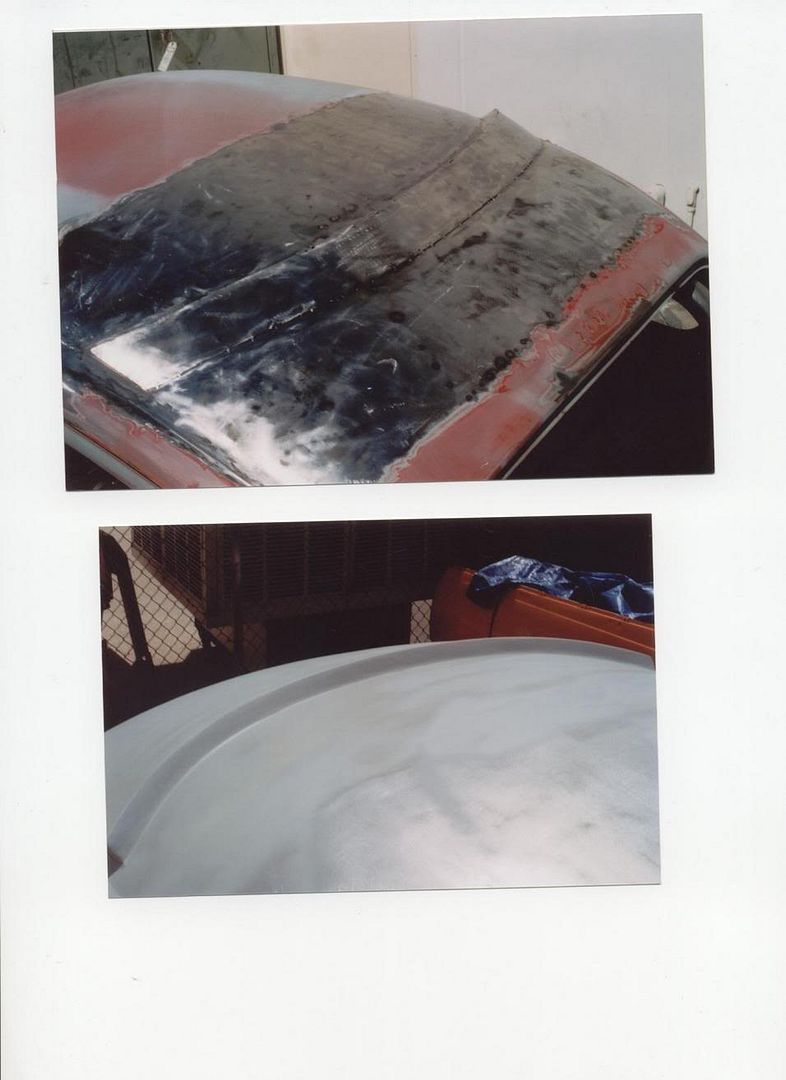

One day I'll have mine running. I hope it helps, my cay to hold the road.
I'm told the Remmele one does a good job, however I don't like the ideal of have something glued to my car, which add safety.

effvee November 28th 2007 00:15
Facing forward

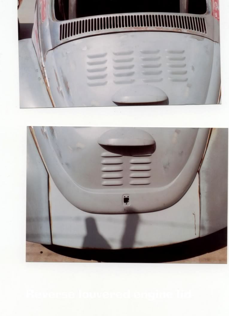

Hi, its facing forward. I have seen many of us (including myself) trying to get it right. When I installed that lip (which is 1" or 25.4mm) height) my attempt is to force the air passing over the roof (heightest point on the roof) to not so much to cause drag, but rather push on the lip. I'm hoping for the force to aid in a down force, yes it will deflect upward, but push on the lip. I don't know what the out come will be, however I'm this works in con-junton with a front air dam. I did not like the ideal of have something glued on at 120mph weather it worked, worked good or just caused drag, go flying off and hit something. If I ever get that car running, I will post what it feels like at 120 going to Vegas.
Not only that, I heard somewhere that as air pass over the deck lid area at high speeds, there is lift of the rear deck lid, something like how a shirt lift up on the back of a motocycle rider. So I reversed louvered my deck lid to catch air and release it into the engine compartment and below the license plate.

Wally November 28th 2007 05:11
I really like the deck-lid idea :) , but not so much the roof lip :o

Effvee, great craftmanship. Im not trying to put you of, i like what u r trying to achieve. Im just giving you a different angle, playing a bit of devil's advocate...
considering the decklid, i have some hesitations... I think the effect will be comparable to just normally opening the decklid a bit (not stand offs), which is a real no, cos the hot air leaving the engine is getting trapped by the high speed air passing over the decklid thats gets turbulent, and because of the low pressure created by opening the decklid it gets drawn into the engine compartment. i wrote the above only after looking at the pics, and using basic thoughts. the other thought is that the air will just run along the inside of the decklid and escape through the lower louvres. If this happens it will be possible to "steal" some of the air going into the fan (stock) because of reversed louvre amount and positioning.
s for the metal lip, i belive it is a great idea, but i suspect that it will cause too much drag, and stress on your mechanicals to reach and sustain high speeds.
