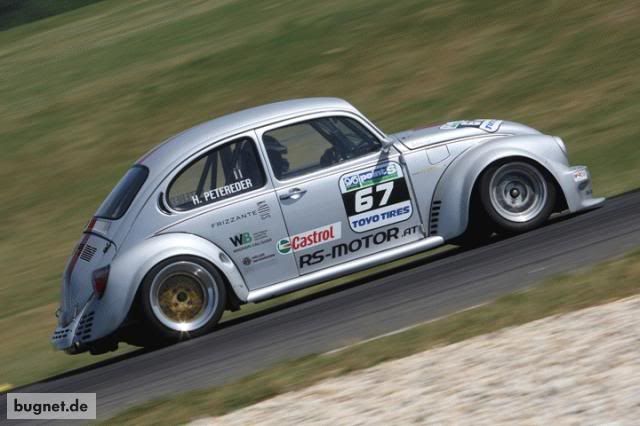

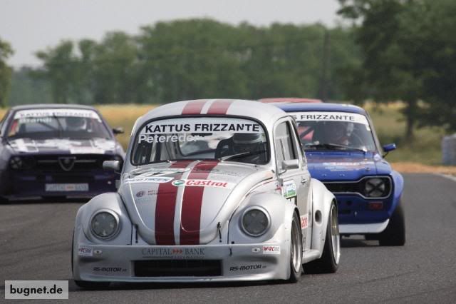

beetle1303 December 17th 2005 09:34
2 Attachment(s)
in order to get the best of the ground effects i would go with parallel bottom instead of inclined. See both pics to understand what im saying. Also i would go for the same depth for the venturi and the difuser (side view). From what i understood the rules doesnt give you enough space to play with ground effects... :( so i dont know if the venturi would have enough meaning...
Chris
judgie December 17th 2005 09:46
in hill climbing and the class that i'm in i can pretty much do what i want,apart from fans and the wing angels have to be fixed.also have to have a min of 40mm ground clearance. will be a learning curve in what will and wont work on the humble bug but it will be fun trying.
cheers rob
