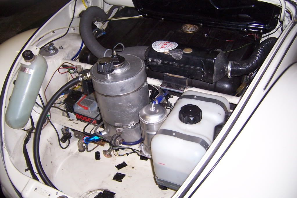

Wally November 7th 2010 13:44
Coming friday 12th November I will enter a driving instruction on the Nurburgring and as its half November, it might get cold then and its a 3,5 hour drive for us.
So, I have installed heating now in the form of a B1L Eberspächer petrol heater. It works and gives off a LOT of heat!
Sandeep November 8th 2010 12:45
Great news on the driving instruction. Is this the first course you've taken ?
70Turbobug November 8th 2010 12:50
You´ll never want to miss that heater..trust me! Especially at your age ;) LOL :D
