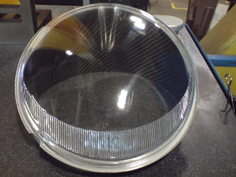

What are your opinions of the yellow 911 lenses above?

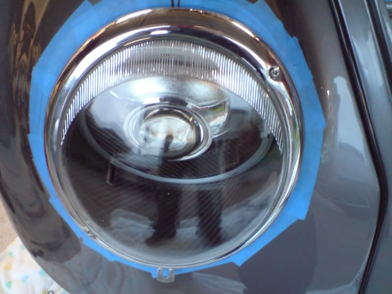

Got the replacement headlight buckets. I hacked out the top mounting tabs. Used some more of the other bucket to make plates that will be used to sandwich the carbon fender with the mounting tabs. Tab and inside support plate are in the middle of the pic.
Did the carbon treatment to the inside headlight bucket:
Need to install the headlight wire conduit, drains, wire the ballasts/high beam solenoid, and trim up the tabs/plates above for final install.
Here it is mocked up, ignore the reflections:

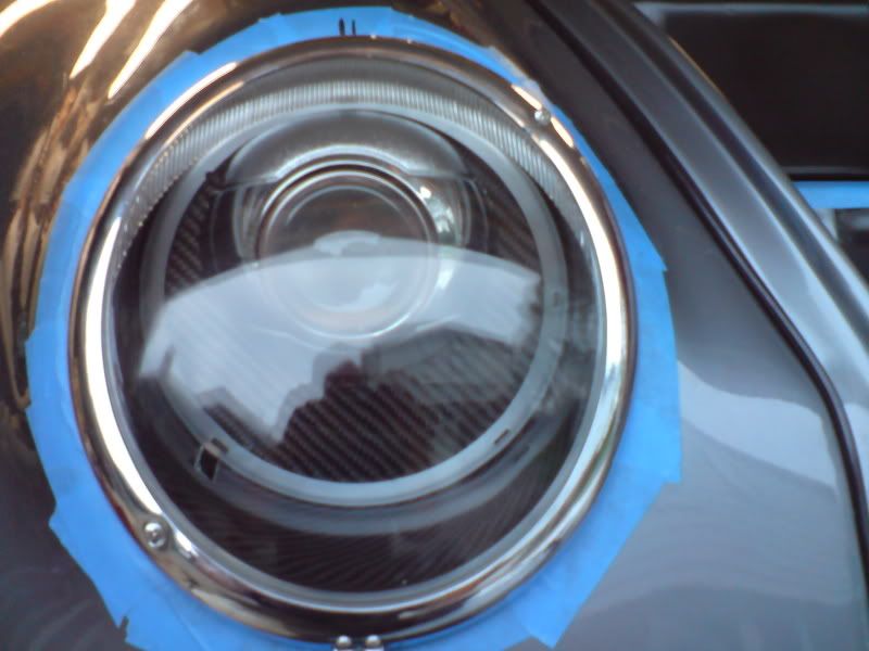

Hey Steve,
I didn't cut the headlight bucket. It still looks like this:
Those self leveling lights would be pretty cool.

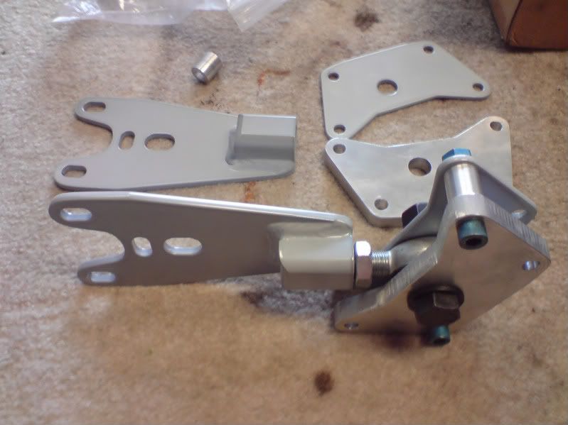

The uniball plates got powdercoated, haven't installed them yet, but they finished up like this:

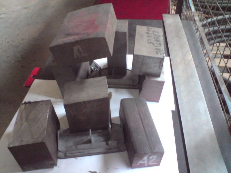

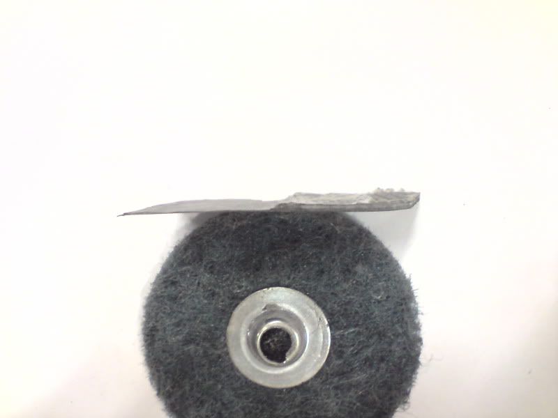

Cut apart a Carbon Joe panel for material. It was too thick so shaved/sanded down the 2 layers of fiberglass behind the carbon fiber. Was left with the one layer of carbon fiber, that was to my surprise, pretty flexible.
Now i needed to find an adhesive to get it to stick to metal really hard so i can sand it. Tried different quickset epoxies, instant adhesives, and some Loctite gel stuff. None worked well. Some had a weird reaction with the resin in the carbon, and others dried all rubbery. Gave JB Weld a try, and it was perfect.
A little oversize, and some extra gunk, to allow shaping:
Sanded:
Time to try it out for real.

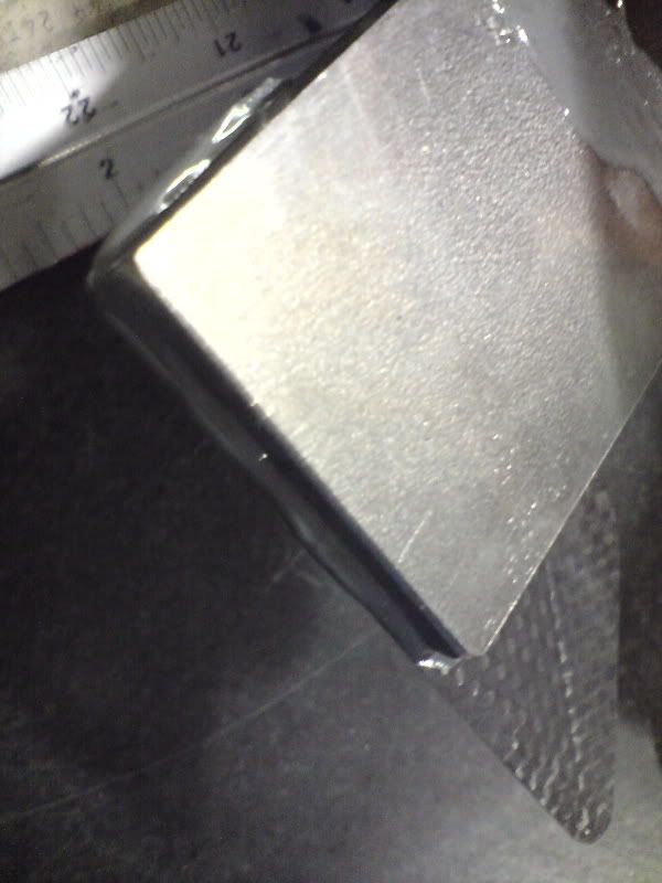

It's now drying under the weight of some A2 steel, nice and heavy :lmao:
I'll give it a couple days to get hard, before touching it. We'll see how this turns out. :shocked:
