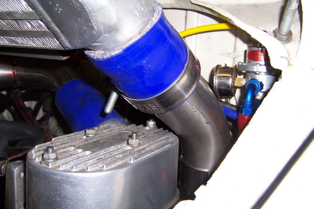

I also wanted to redo the piece of 2" pipe just after the intercooler (2,5" exit) and the T-split. The individual 2" pieces to the pressure hats can easily remain 2" imo, but making the intermediate bend from 2,5" just seems more logical:

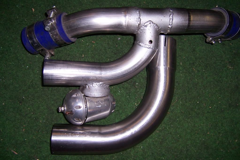

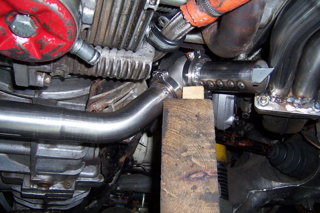

Meanwhile, some progress on installing/trial fitting the Tial wastegate, trying to outsmart the system by just using one WG by dividing the uppipe ;)
Divided pipe is now visible, of course needs to be shortenend and connected to both up pipes to turbine.
New wider pipe to the intercooler fits well too now, almost straight shot from the turbo :)
70Turbobug January 13th 2011 06:37
Looks like it´s getting tight in there now :shocked: I suppose there´s no way of locating the WG further upstream?
Wally January 13th 2011 07:40
Just for the WG there would be room upstream just under the rear valence right after the 4-2 sections, but I saw no routing of the neccesary slicencer anymore then.

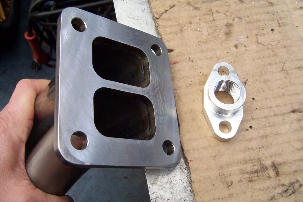

Yeah, coming saturday I hope to get the oil return outlet for the turbo and have the flange machined flat again as it has warped a bit after my welding...

Wally January 15th 2011 16:18
Flange machined flat again after it warped after welding and the neat oil return flange:
