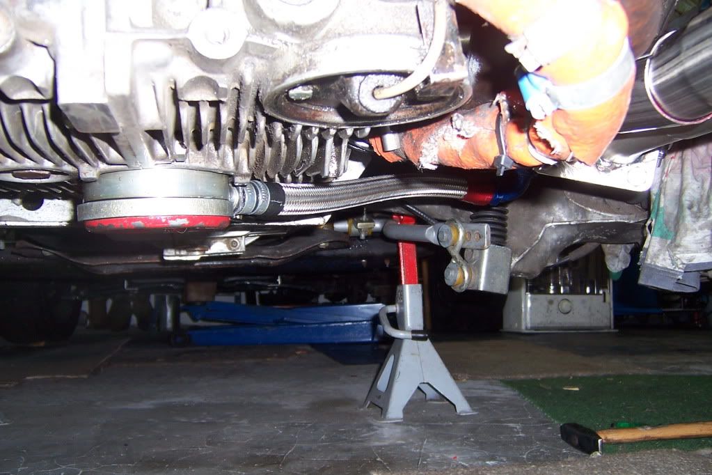

Sandeep January 19th 2011 12:59
Hi Walter,
I noticed a fitting on your sump extension ... I know which DS pump you are running :cool: so am guessing that this is the return for your turbo ? If not, what is it for ? Are you still using the Tilton scavenging pump ?
I'm trying to eliminate as many support systems as I can in my build right now, and this looks like a great solution for the turbo drain ... considering the 38mm scavenge circuit in the DS pump.
Unfortunately, I also have to upgrade the DS pump feed from a -8AN (12.7mm ID) to either a -10 (.625" / ~15.9mm ID) or even a -12 (.69" / ~ 17.5mm ID). More fittings .... more hose :mad:
Wally January 19th 2011 13:55
Of course :D
Its a -12 hose I use, same as I use for DS pump feed from the front trunk. Better safe then sorry. I bought the Tilton, but have still never even used it...
Just today I did some work making the wastegate feed tubes from both pipes and still keeping them separate. Hope to have some updates at the weekend.
