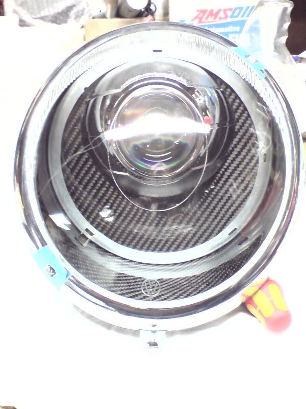

Headlights are FINALLY ready for install. I've nicknamed them....The Million Dollar Headlights. :lmao: I've spend an unbelievable amount of hours to build/fab them.
-OEM FX45 projectors are now modded with clear lenses. Really nice cutoff and colour!
-Ditched the generic clear Oval lenses, and sourced early Split clear Hella glass. Had a local Crystal grinding shop grind a pair of notches in each lens. Notches are to clear the trim's adjusting screws like the later glass, so it can all be assembled.

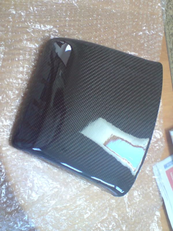

Got my gloveboxes done. Really happy with how they turned out. No more cardboard.....they are carbon. :eek:

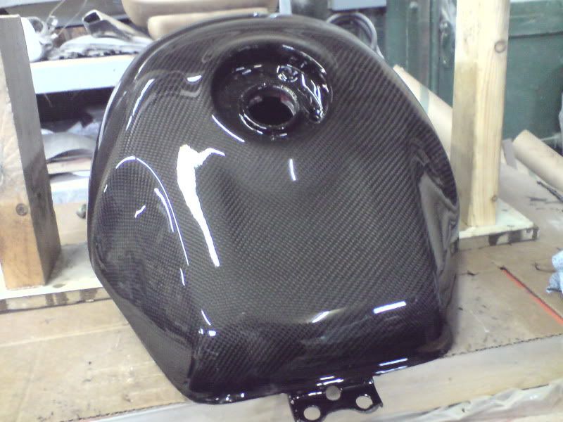

I went to pick them up, and he showed me a Kawasaki gas tank he was overlaying in carbon tucked away in the corner of his garage:
So stupid thoughts started racing in my head.........Do the same to the split gas tank? What do you guys think?

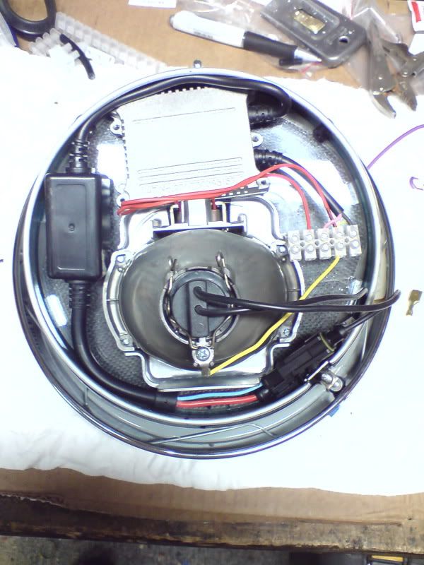

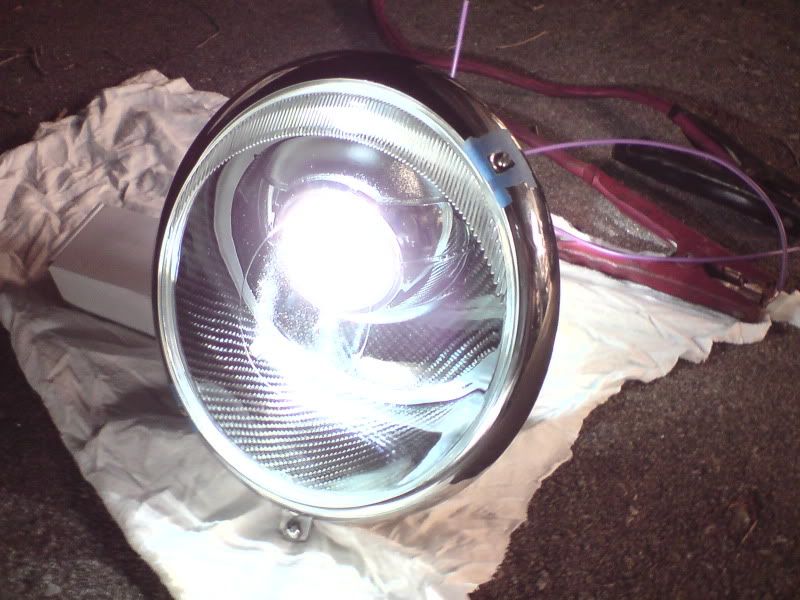

Got the headlights together. Opted for the early Hella glass, and had the 2 notched ground into them to fit my housings. Grinding was done by a local Crystal grinding shop.
The slim ballast\igniter\terminal block stuffed in the back of it.
Fired up:
