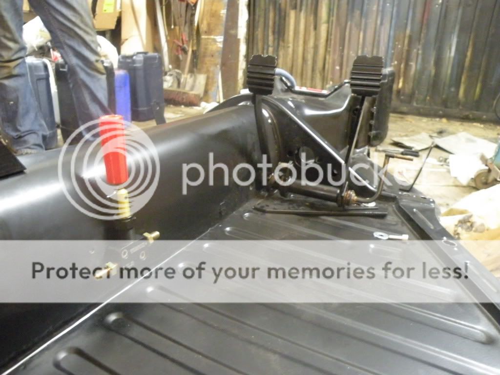

Then started on the Hydraulic clutch. Got an adapter t piece from npt to jic for the Goodridge lines im fitting.
http://i591.photobucket.com/albums/s...5.jpg~original
http://i591.photobucket.com/albums/s...4.jpg~original
http://i591.photobucket.com/albums/s...8.jpg~original
Which was then coupled with the pedals – kinda hard to get a pic of it
http://i591.photobucket.com/albums/s...0.jpg~original
The line exits out the clutch cable conduit
http://i591.photobucket.com/albums/s...3.jpg~original

The Tilton piece, mounted on the tunnel by the shifter, it's a staging brake?
owdlvr January 9th 2011 23:45
That would be a brake-bias valve. Used to adjust the balance between the front and rear brakes.
