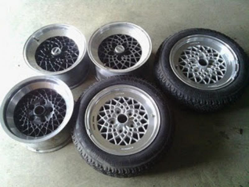

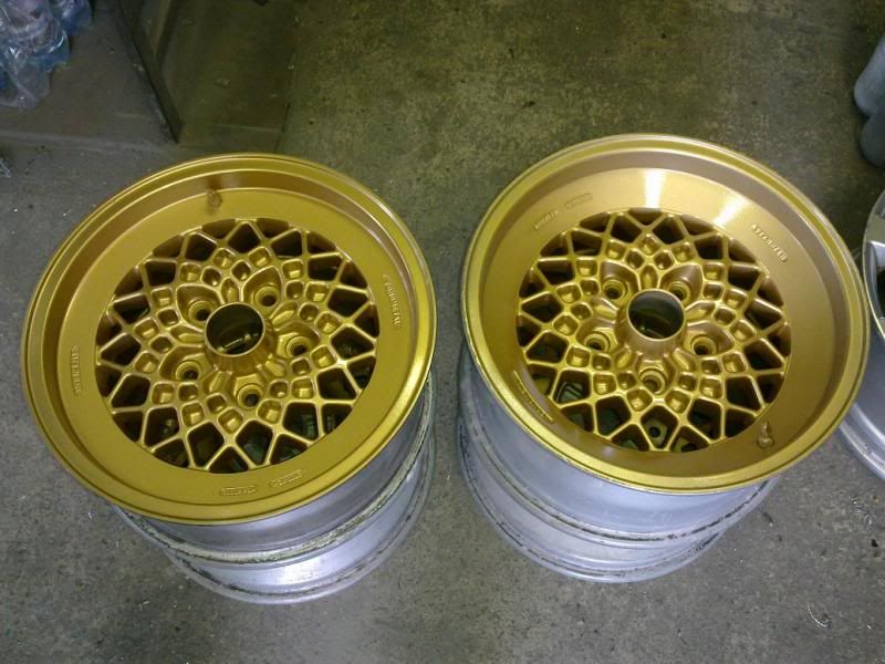

Wheels refurbished
http://i110.photobucket.com/albums/n...6.jpg~original
http://i110.photobucket.com/albums/n...f.jpg~original
http://i110.photobucket.com/albums/n...1.jpg~original
http://i110.photobucket.com/albums/n...b.jpg~original

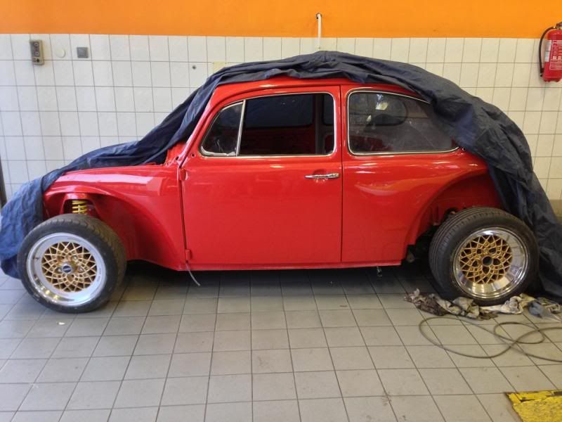

Bogara_ZO August 10th 2013 07:15
Fitted
7x16 - 195/45
8x16 - 215/45
I think i will go with 205/45 on the back
http://i110.photobucket.com/albums/n...5.jpg~original
