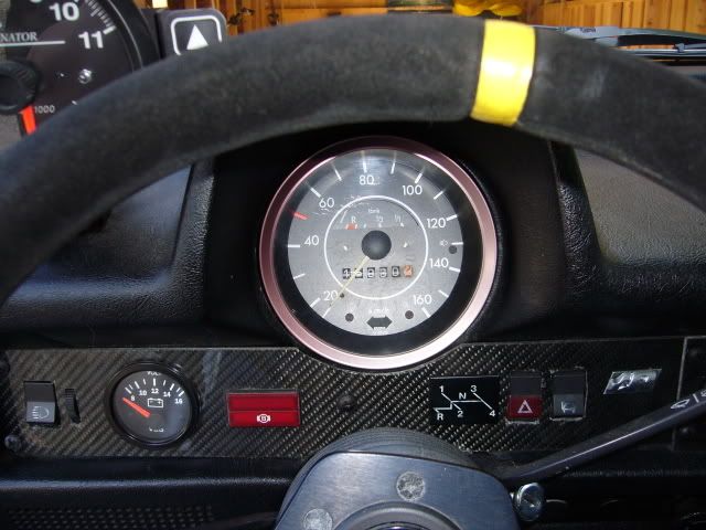

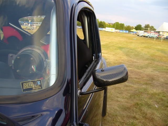

Since my old mirrors were stolen, I had to get some new ones. :bawling:
This time I went for a pair of CF APR mirrors.
boblebaard August 3rd 2006 14:24

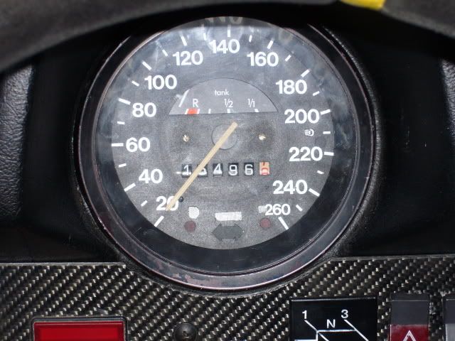

I also found out that my old speedometer didn`t go far enough....
So I installed anew one! Unfortunately it`s not in MPH... :rolleyes:
