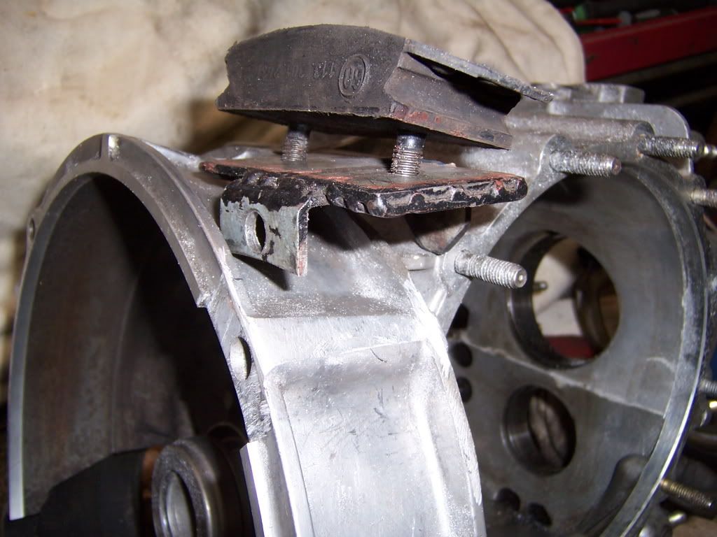

Quick question about mounting the G50 to the Beetle transmission cradle. It looks like the OEM rubber mounts are used, and then a metal plate with a tab, to connect the rubber mounts to the G50 bolt holes on the bottom of the transmission.
Is this plate custom, or is it from an OEM rubber mount (the bottom plate)?
Wally July 22nd 2016 15:56
I think it was a custom plate I fabbed up, actually just a piece of scrap metal ;-)
