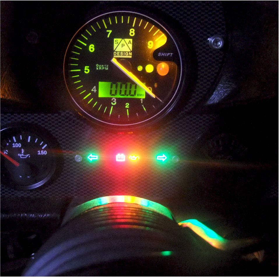

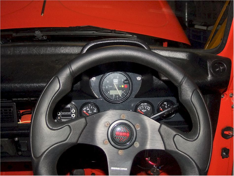

Hi, did I just see a heads up display (HUD), speed-o? If so, way cool:D
Steve C September 17th 2014 00:44
It's a HUD, I really like it. I bought from these people http://mypolaris.com.au/hud/ but might be able to source one locally

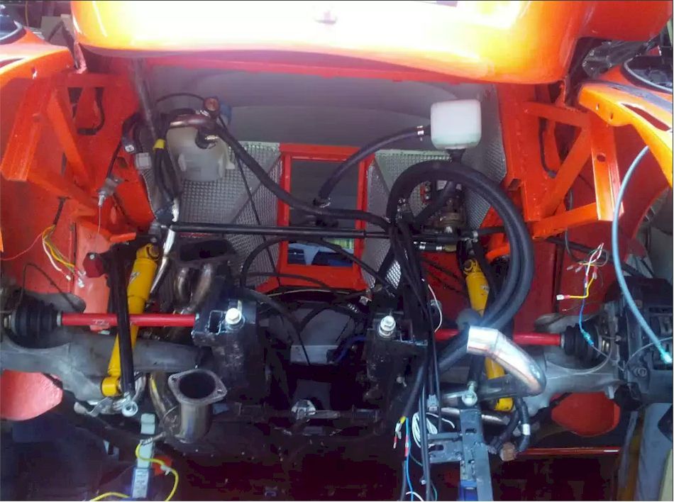

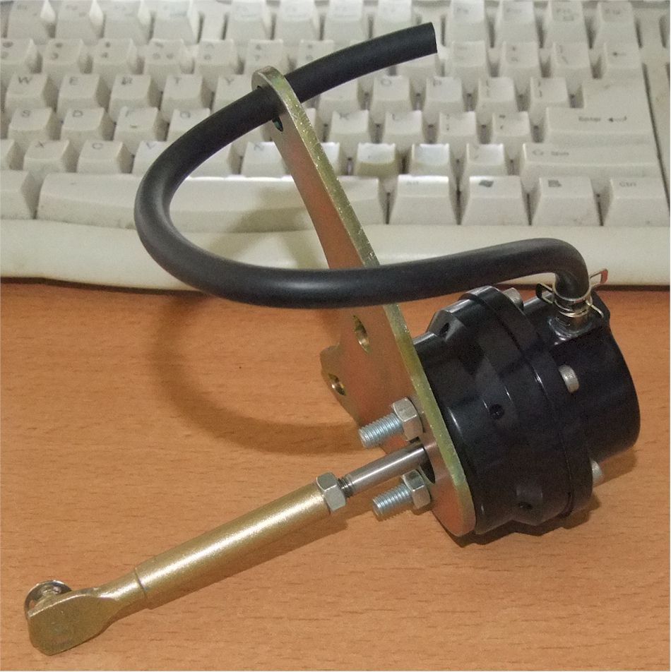

Steve C September 17th 2014 21:00

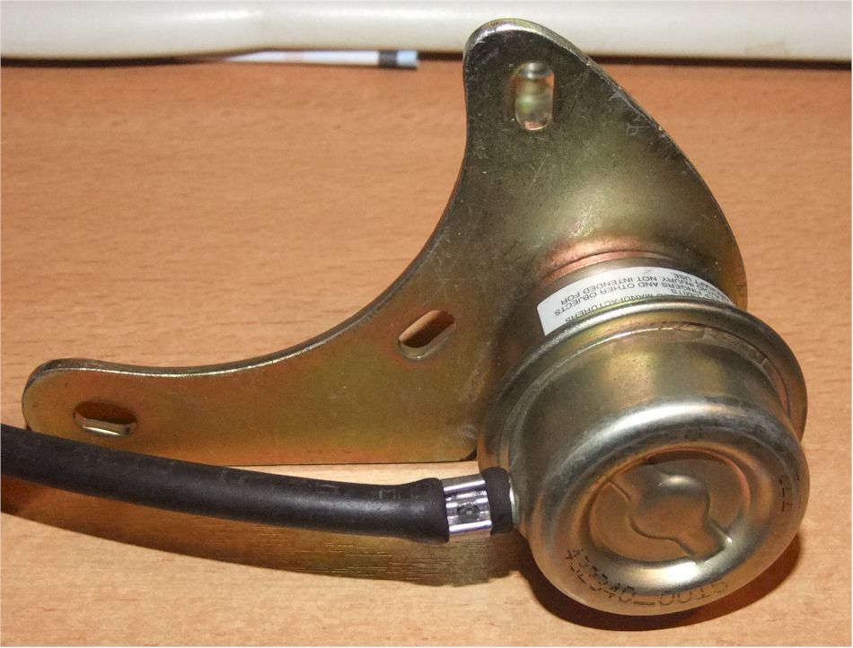

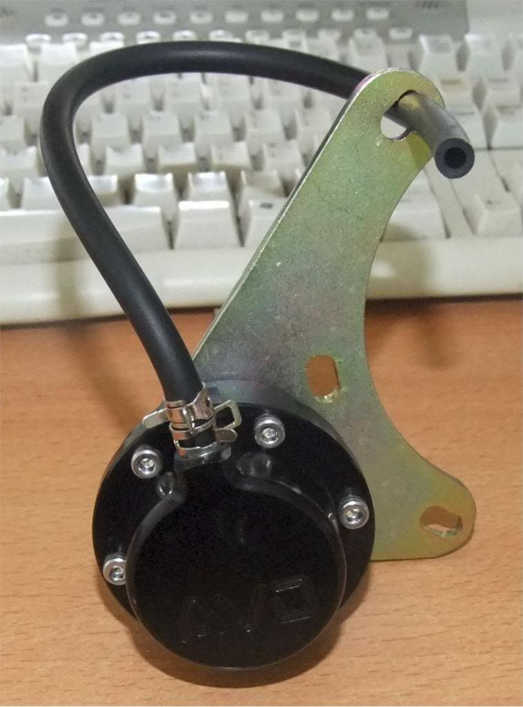

Turbo is on, just need to fit the injectors and some phenolic spacers to the inlet manifold and fit the ice box.
There is a massive size difference between the turbos.
I thought my motor used a VF30, its actually a VF35

Wally September 18th 2014 02:03
Familiar pictures... I had a VF34 and the difference with a Blouch DOM3 (= Garrett GT3076R with a small-ish hotside) looked like that too.
Steve C September 22nd 2014 07:27
Its nearly back on the road, check of the tune next week.
I think I had a boost leak, I wonder how it would have gone at the 1/4 mile without a split in the hose just after the turbo.

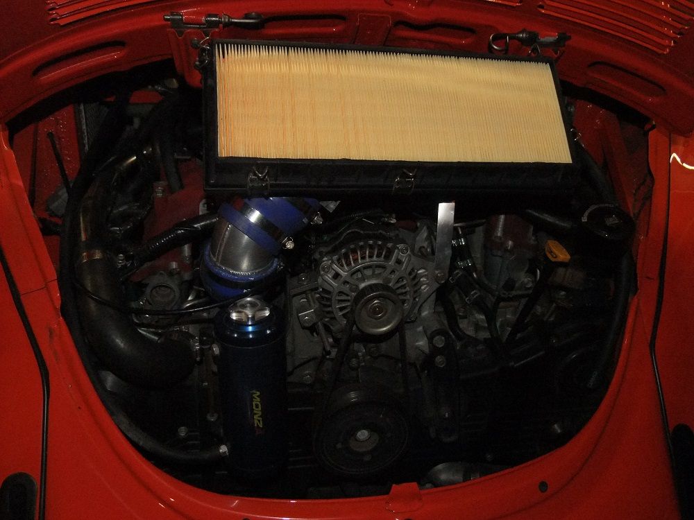

It was a bit of challenge to fit a 3 inch inlet under the Subaru inlet manifold. Needed a bit of hammer work.

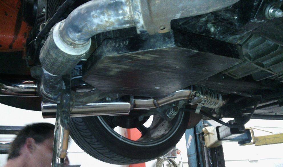

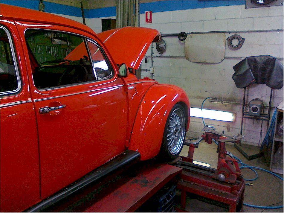

Steve C November 17th 2014 06:45

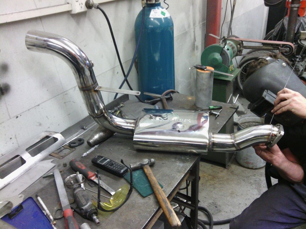

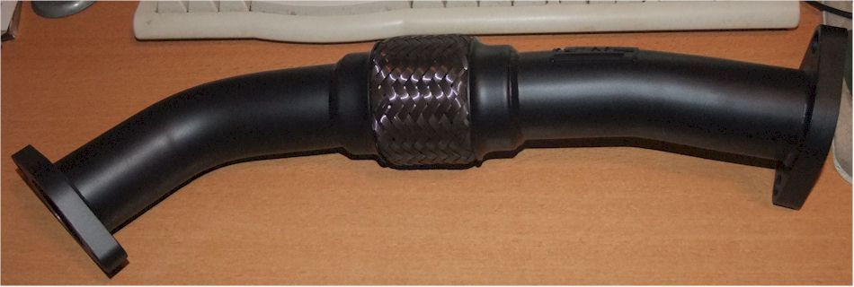

Went to see my friend Westy and he made new less restrictive exhaust for my Beetle.
http://i1184.photobucket.com/albums/...1.jpg~original
http://i1184.photobucket.com/albums/...0.jpg~original
I'm using a Mondeo (3/95 - 04) air box with the lid removed, it sits near the engine lid vents and suck air through there, its 397 x 150.

Just got back from a 7 hour each way road trip to Shepperton, Victoria in the bug. I'm really happy with how the car performs now with the new turbo. It comes on at 4200 like you just got hit up the bum by a train.
So cruising at 120kph its off boost at about 3,000 rpm so its very quiet, it picks very nicely in 5th at that speed with a few psi of boost, if I stick it back to 3rd at that speed its nuts.
After stops for fuel etc you could really see how the new intake setup dropped temps back down again after some heat soak from the stop and something that I haven't seen before is the intake temps varying depending on load, so if I boot it intake temps would rise slightly and fall back down again when cruising.

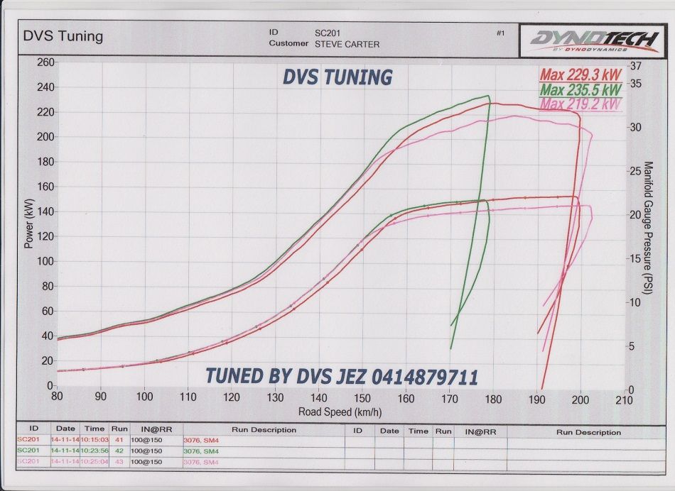

I had another tune to compensate for the new exhaust and air cleaner, it was another **** day for a tune, very hot.
I've reached the limit of the current set-up now which is what I wanted to do, next cams & E85.

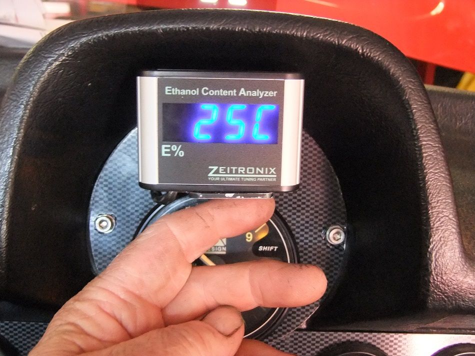

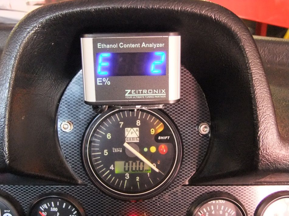

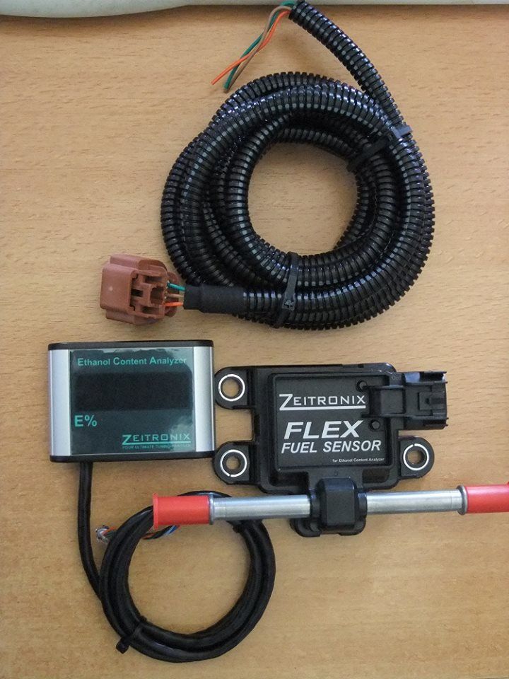

Another piece of my quest for more power arrived today, its a sensor to tell my ECU the percentage of ethanol in my fuel, I can then run my car on the street on regular 98 RON fuel and then when I'm competing in an event I can fill the car with E85.
When my new cams arrive next year I will be getting the motor retuned a bit more aggressively on E85 fuel

volkdent January 3rd 2015 13:40
Great pics and I love the E85 sensor plans!
Steve C January 3rd 2015 18:42
Thanks, E85 = more timing & boost = more power
70Turbobug January 4th 2015 10:35
http://i1184.photobucket.com/albums/...2.jpg~original
I have purchased one of those also not a Zeitronix though. Where are you going to install it? After the fuel tank between feeder pump and main pump? Or just after the fuel tank?
Love your car and the videos btw!

Steve C January 4th 2015 18:30
Thanks, I like the work your doing on your car
I'm going to put it in the return line as close as I can to the motor, low pressure less dangerous. I think all the sensors are GM just re stickered.
When I get it tuned it will be on 98 RON and then blends from straight 98 to straight E85 and then mixtures of both. Its an expensive tune but the results should prove worthwhile, just waiting on the Tomei pon cams now.
70Turbobug January 6th 2015 06:21
Thanks! I was thinking the same about the pressure, but figured it would be more logical knowing what the ratio is before it enters the engine? However,come to think about it I guess that would only be an issue during cranking for start up. Expensive is right, I checked the price on the Zeitronix stuff. I bought a Siemens/Continental Flex Fuel sensor new for $70 US dollars,which is what GM uses also.I have an MS3 ECU from Autotune.fi. All I had to do is add a jumper wire. It was this simple mod that convinced me to go flex fuel. I am eager to see how well it works.
Steve C January 6th 2015 23:35
I'm running a Autronic SM4, it needs the Zeitronix gauge to send the correct signal to the ECU.

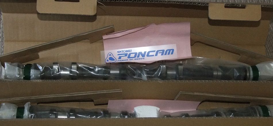

Tomei pon cams arrived today, thanks to jessestreeter.com
So now that I have everything I started looking deeper into hooking up the ECU to see the flex fuel sensor.
The plug n play Autronic SM4 is showing its age and its not easily configurable to run a flex fuel sensor, I need to fit missing pins into the stock ECU plugs.
So Haltech do a plug n play but it needs an upgrades MAP sensor as the one fitted only goes to 22 psi, its $1975 + $129 for a 30 psi MAP sensor.
Adaptronic do a e1280s stand alone unit for $1990 that has some better features than both the Haltech and Autronic but it needs to be wired in.
My tuner prefers Adaptronic http://www.adaptronic.com.au/product/e1280s/
So I will need to do some thinking

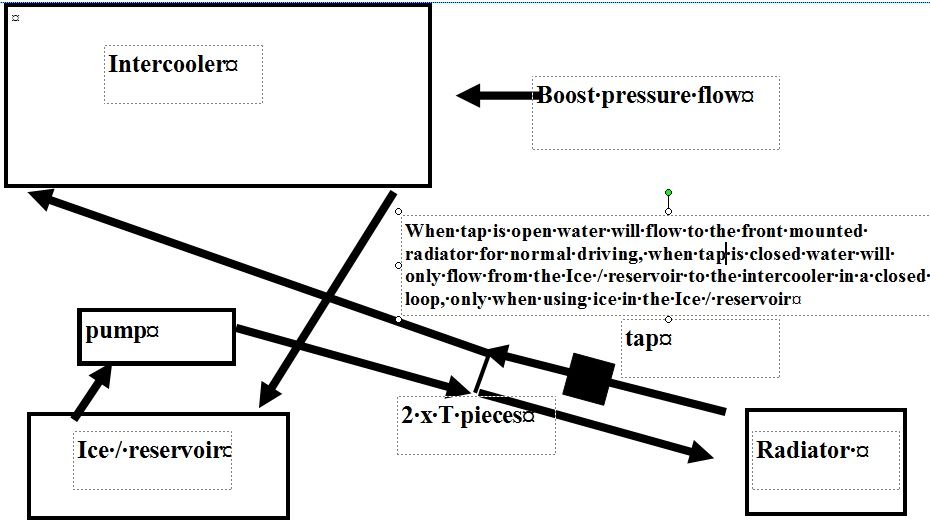

I've been rethinking the water line layout for my ice box & intercooler. I only use the ice box for drag racing and tuning on the dyno. I was sending the ice water to the intercooler radiator at the front of the car after it had been through the intercooler which was was picking up more heat. With this new arrangement I can recirculate the chilled water in a closed loop which I think should make it last longer
http://i1184.photobucket.com/albums/...8.jpg~original
Steve C February 18th 2015 05:29
At the suggestion of Ricola I fitted another tap in the intercooler plumbing to close of the H, so when not in ice cooling mode all of the water goes to the front cooler.
