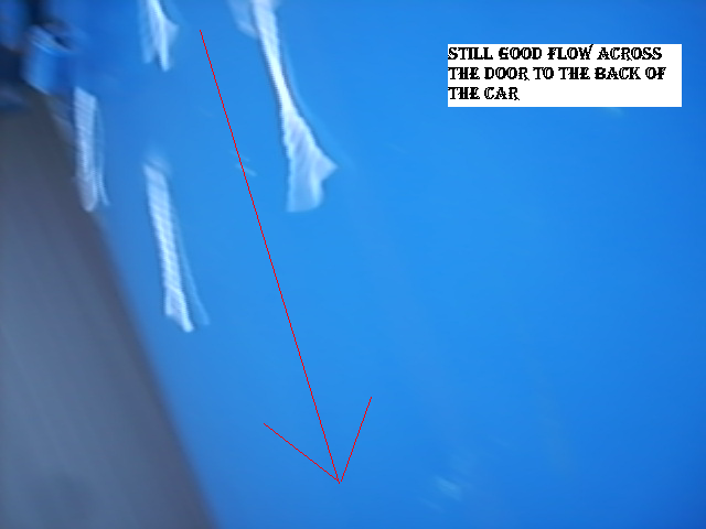

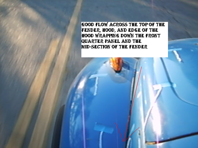

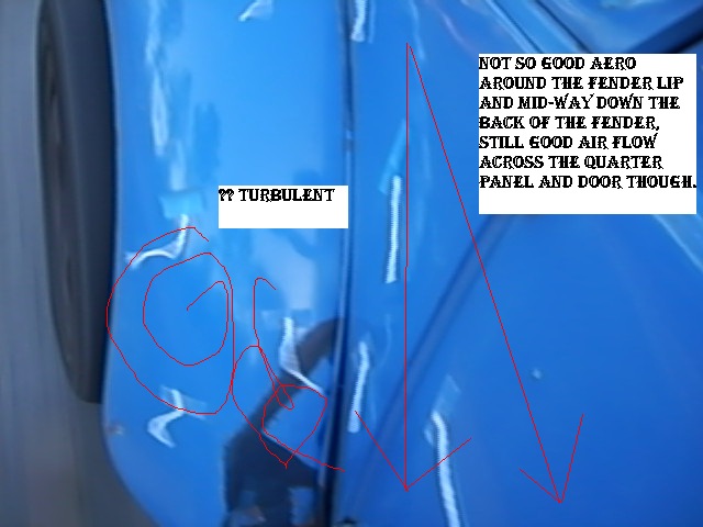

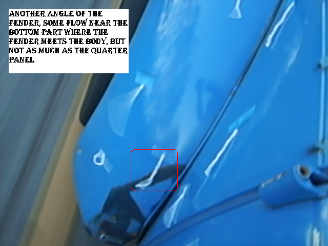

Did some testing with the car just a little while ago. No one could help me film the outside of the car so I just stuck my arm out the window to video the left front part of the car. This is all in anticipation of drilling some holes along the back of the fender. So, thoughts?
http://i52.photobucket.com/albums/g3...8.png~original
http://i52.photobucket.com/albums/g3...5.png~original
http://i52.photobucket.com/albums/g3...6.png~original
Where should I drill the holes, would it help aero flow or not matter? This racer from a few pages ago has holes along the bottom back of the front fenders. I also plan on running some fender flares to match the fender edge with the tires better.

Wally October 15th 2011 03:10
Great testing! Kudo's to you!
I would make some vertical slots in the front fenders as near to the body as possible. Might do some to mine.
The overpressure on the inside of the fenders will not show with the wool on the outside though. Still, you'd think that the flared fenders will grab more air then original ones.
For some reason my car seems to have huge drag at speed. Part might be the air grabbing fenders (and wide tires) is my reasoning.
Gerrelt October 15th 2011 07:32
Nice test work Jadewombat!
Like Wally said, you're talking about two different things. Your tests show how the aiflow is over the fender.
The slots in de fenders are for relieving air "pressure" in the wheel wells.
BTW, the airflow shouldn't be attached all the way to the bottom of the fender. Turbulence behind the fender is good, that means the airflow is de-attached from the fender. The angle of the rear of the fender is too steap for good airflow.
I think you could improve the aerodynamics of your beetle by installing wheels that fall inside the fender. Or install wider fenders. Your wheels stick out a couple of cm's, that can't be good for aerodynamics.
Again, nice work on the wool tuft test! I hope more people do this!
Bruce. October 15th 2011 16:47
Are you using running boards? If not try them.
Otherwise the air flow as it passes under the rear edge of the wing might create a turbulent area as seen in the photos. Also the wheels out in the air flow also tends to create turbulence and drag.
Jadewombat October 15th 2011 22:06
Will try both of those things, thanks. Also been experimenting with a CF cover I fitted to the front underside with quick release pins, mounted just in front of the sway bar where the factory A/C would be normally. Did some tests on it yesterday with and without. Definitely some change but I need to do more tests moving the tube to the top of the bulkhead to see what through the vents and over the cover.

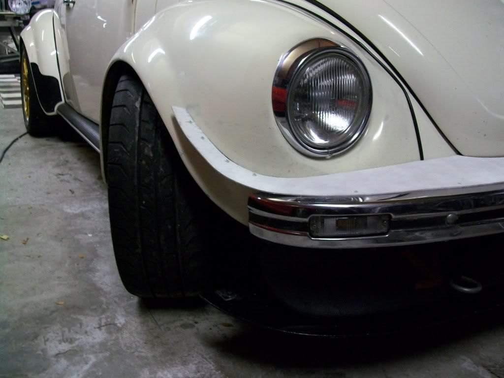

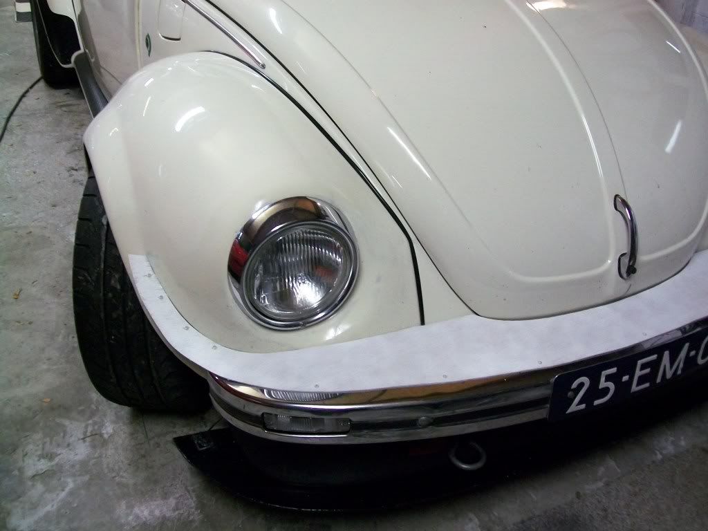

Those flaps along the back of the front fenders have got me curious as well. A picture of my car attached. Thinking maybe I could do something similar to this Elise, smooth out the area where the running boards would normally attach to the car (circled in purple) so it's flush with the door lines and some small strips of material to smooth out the transition between the fender corners and the pan (circled in red).

Regarding my front fenders, I kept the wholes large and close to the body to fill the void behind the fender. The fender is curved like the body and is is a high pressure area, both good cause for lift. After venting the front fenders I had to add a little more angle on the rear wing for high speed cornering stability. If I did it again I would (and still might) create a larger vent, same vertical size but a little wider and closer to the body.
For the running boards, I've mentioned somewhere before creating a wedge shape much like the ones on the Jeffery's race bug. Sizing them right takes some work and you can be more aggressive on a track car vs. a street car, but ideally they should be as close to the road as possible. Its common practice to use sheet metal or fiberglass moldings and rivet a rubber curtain to it.

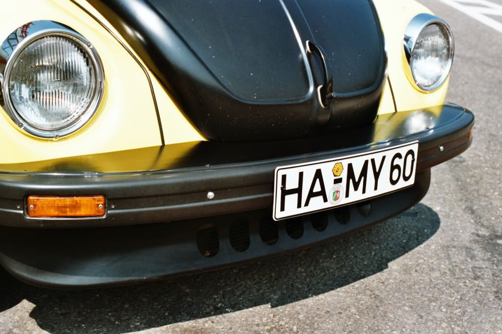

beetle1303 October 24th 2011 14:12
1 Attachment(s)
Wally, after u posted the Bernd Rummenholl's 1303 Gelb-schwarzem Renner's pic i remembered that i had found something similar a long time ago. cant remember if it was through a forum or randomly over the net...
If any one knows more then please comment.IIRC its from one of the scandinavian countries from the 80's
If u look closely the fender cover extends high between the front bonnet and the headlights.and the bonnet is different maybe a hoffman product?
Also note the front splitter with rubber lower end that extends to the front wing's leading edge...
Chris
Gerrelt October 24th 2011 15:34
Google image search resulted in this norwegian thread: vwnorge thread
The third picture shows the same front spoiler, but now from an angle.
I thought it looked pretty good from the front, but I don't like it from an angle.
Or is the yellow-brown color?
edit: the yellow-brown beetle has a different spoiler.
This is a better view on the gray one: LINK
