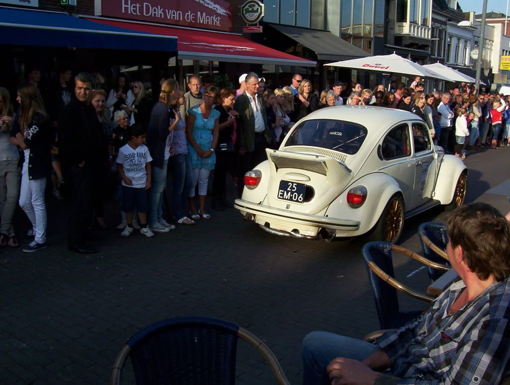

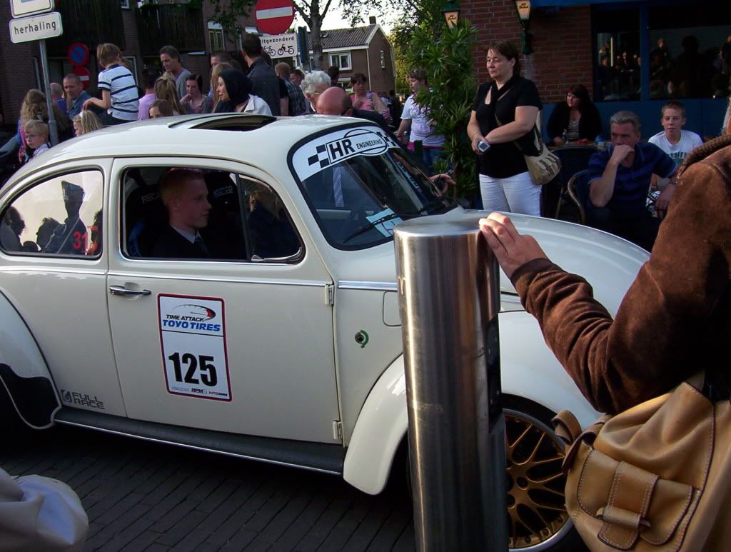

Wally June 16th 2011 14:40
and the very next day/evening I was on 'drive-my-friends-to-be-graduated-son-to-pram duty' :
running at idle for over half an hour in queue...he was happy though :)
