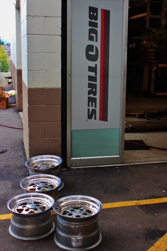

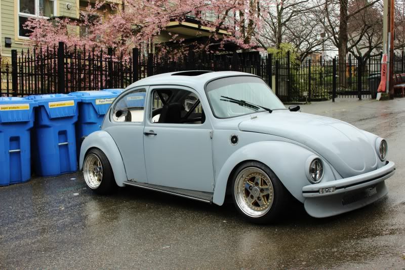

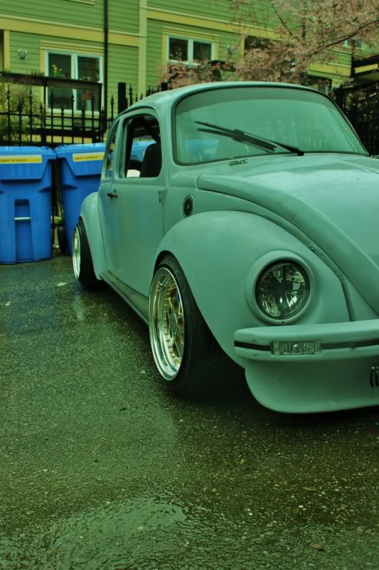

Yeah got tires mounted.
http://i7.photobucket.com/albums/y25...0.jpg~original
http://i7.photobucket.com/albums/y25...5.jpg~original
Getting the rear tires on was something else. Lets just same there was fire involved.:D
cookvw March 31st 2012 23:34
wheels are awsome. i also posted on your fb as well.
owdlvr April 1st 2012 03:58
The ol' modified-propane-tank trick to mount the tires...or ether and a lighter?
Always fun!
Wheels look great.
Xellex April 1st 2012 06:08
the first time I had that done on a set of wheels, it scared the crap out of me :))

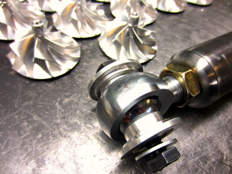

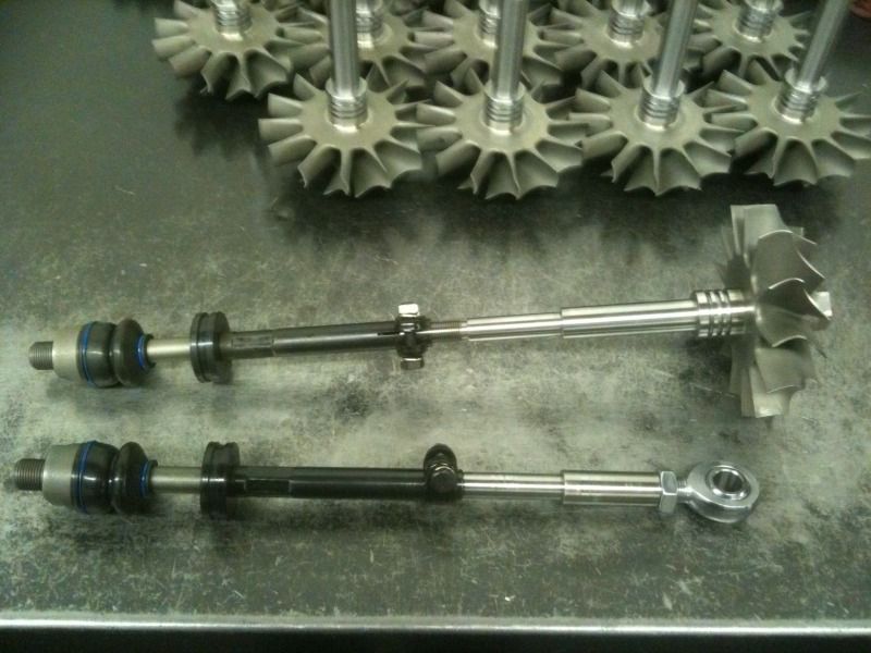

I happen to stumble across these turbine shafts in the machine shop that suited my needs:D Material is 4140 and so it will be plenty strong enough and then coupled to that is a 5/8" Chromoly Heim Joint.

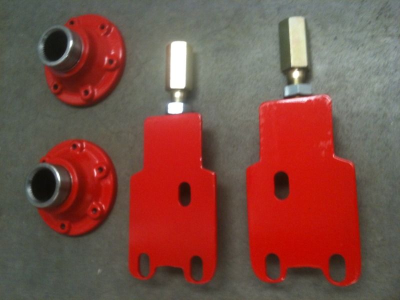

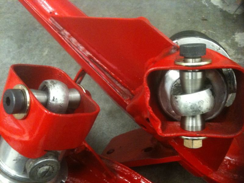

Sneak Peek at custom lower control arms. This is the inner. Outer will also be heim joint with a roll centre correction spacer for the spindle. Also need to figure something out for the sway bar attachment. These will be a bolt on unit.:)

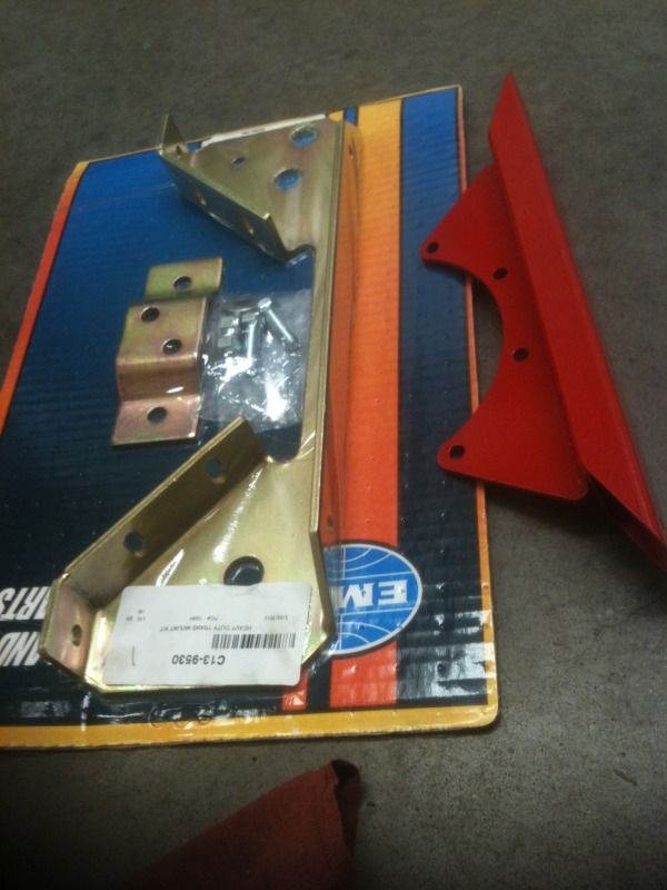

vw1303 July 6th 2012 18:39
After some clutch chatter issues and wanting to keep things in place better I'm switching to solid mounts. I'm also going to reverse the rear cradle and mount the gearbox forward a few inches. Ditching the front rubber mount and going with a mid mount. I'm going to get rid of the urethane piece that the midmount came with and use aluminum and drilling through the frame horns to secure it.
