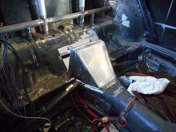

graham February 6th 2016 05:39
Ok time for an update,
For those of you that know about the f___ing Idiot who previously installed the engine it will come as no surprise to you that nearly every part of there work needed ripping out and binning. Including the water pipes and fire wall. What more can I say, Professional W__ker....
THANKFULLY Darren Coleman over at http://www.dccustoms.co.uk now has the car now for the engine install and finishing.( Check out Darren's Facebook page to see what he is capable of )
Darren also gives a f__k and also knows what he is doing :D so heres a few pics of his work and the progress.[IMG]http://i1185.photobucket.com/albums/...z.jpg~original~original[/IMG]
[IMG]http://i1185.photobucket.com/albums/...2.jpg~original
[IMG]http://i1185.photobucket.com/albums/...b.jpg~original~original[/IMG]
Its getting there :D:D
