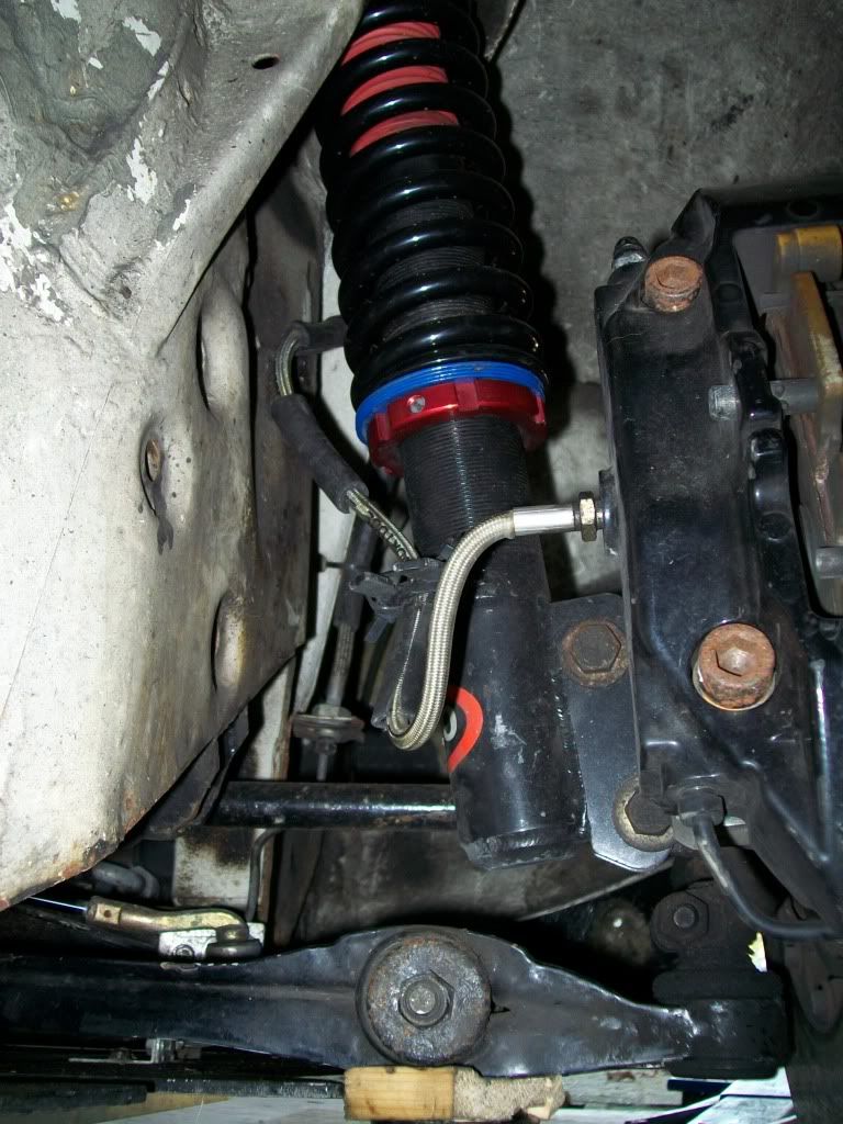

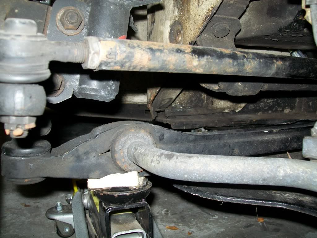

Looked at my suspension geometry this weekend and as I remembered, the tca is almost parallel with the steering rod (good thing):
Futhermore, for the camber to get more negative, the tca must become rectangular with the imaginary line through the top of the strut and the ball joint, right?
It seems I am still pretty good with the current angle, even when fully suspended inbound (this pic is taken with the wheel/tca-end supported, so in resting position):
My idea to use a ball joint extender will probably give more bump-steer since tca and steering rod won't be parallel anymore and isnt needed from a camber point of view, so I think I don't want to do that after all.

Steve C October 23rd 2011 20:04
Hi Wally
Do you have any issues with the tie rod touching the chassis rail / inner mudguard?
Wally October 24th 2011 03:12
No, but... I have squared the spare wheel well (for easier battery placement and such) and the tie rod could hit the edge or so it seemed, so I made a recess for it.
The tie rod never hit anything fortunately and now with the stiffer springs even less chance.
ricola October 24th 2011 05:33
Wally: I'm in the process of correcting poor scrub geometry. The high offset porsche wheels make the scrub radius massively negative. I was desperate to try and avoid wider wings but the compromises just weren't worth it. From memory my scrub offset measured about 38mm -ve. A quick test with the rear 944 wheel spacers have made the steering feel much nicer and more confidence inspiring, it isn't to far off stock now I believe. Most RWD cars have +ve scrub but some late (including 2 bolt strut supers) are designed with -ve.
Rich
Wally October 24th 2011 06:33
I hear you Rich; I run the 21mm spacers up front as well, but more because I couldn't fit the high ET wheels; this was before I ran the slimmer AVO struts. Now the spacers help to have full steering without hitting the inner fenders...
My theory is that the 944 spindles are bad for scrub radius. I think their tie rod ends are located further outwards then the originel VW 2-bolt spindles, which curve more towards the inner side of the car? Not sure though. Whats your take on my theory?
ricola October 24th 2011 08:28
Sounds like you should just measure yours, I did it by jacking the car as you have done above at ride height and holding an edge as close as possible through the points after having marked off the width of the tyre (before I took the wheel off) to get the centre line. Tie rods shouldn't affect scrub radius, just the affect of the scrub, their effect is more too do with ackermann & steering effort/speed.
