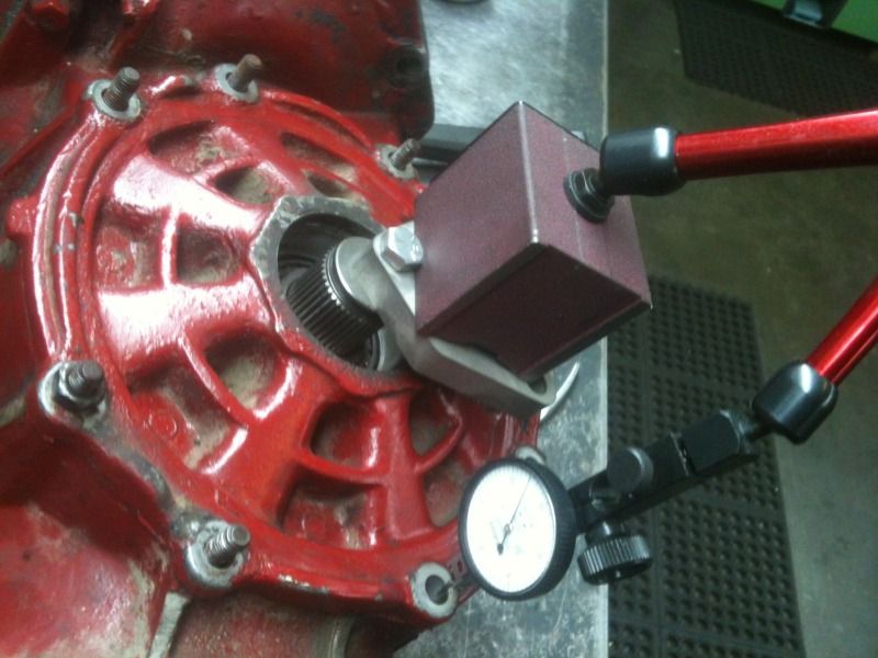

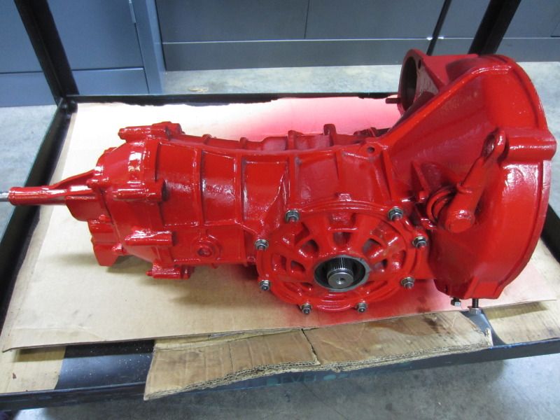

Flipped the rear cradle and mocked up the gear box. Going to make a solid front mount and also use a mid mount. Pulled my shift rod and found out it was bent. So I ordered up an adjustable end and am going to shorten it by 2". Also started setting up the spool differential. I installed my original ring gear and torqued it down. Then plopped it in the gear box. It seemed too tight after installing the diff cover so I removed a shim out of it. Now it seems pretty good. I measured .015" of play while rotating the diff using this method however I am a little unsure of it as this is the first time I have setup a rear end. Factory settings from the manual say .006"-.010". Any pointers?

vw1303 August 20th 2012 12:02

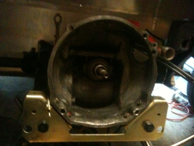

http://i7.photobucket.com/albums/y25...3.jpg~original
Gearbox is ready to go. Bearing preload and backlash are set on the spool.

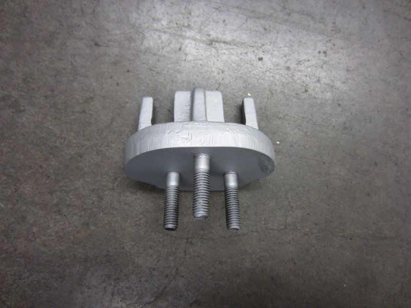

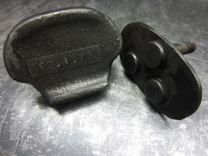

I "deconstructed" my OEM front mount and found the date of manufacture was cast into the piece:shocked:. I am going to mill down the face and resuse this piece as a solid front mount.
vw1303 August 29th 2012 12:02

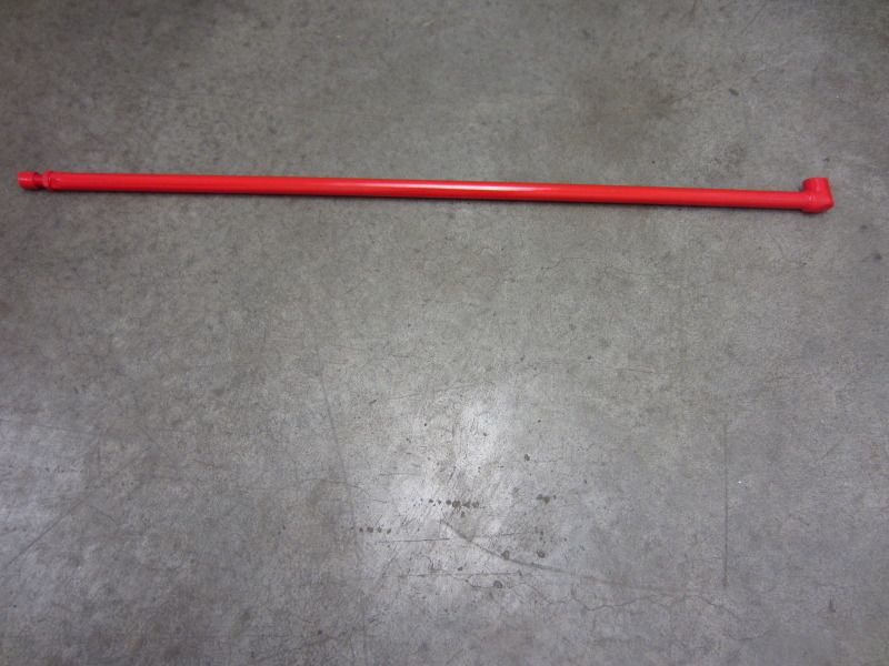

http://i7.photobucket.com/albums/y25...8.jpg~original
Solid front mount.
Shortened and adjustable shift rod made with slightly heavier wall tubing than OEM.

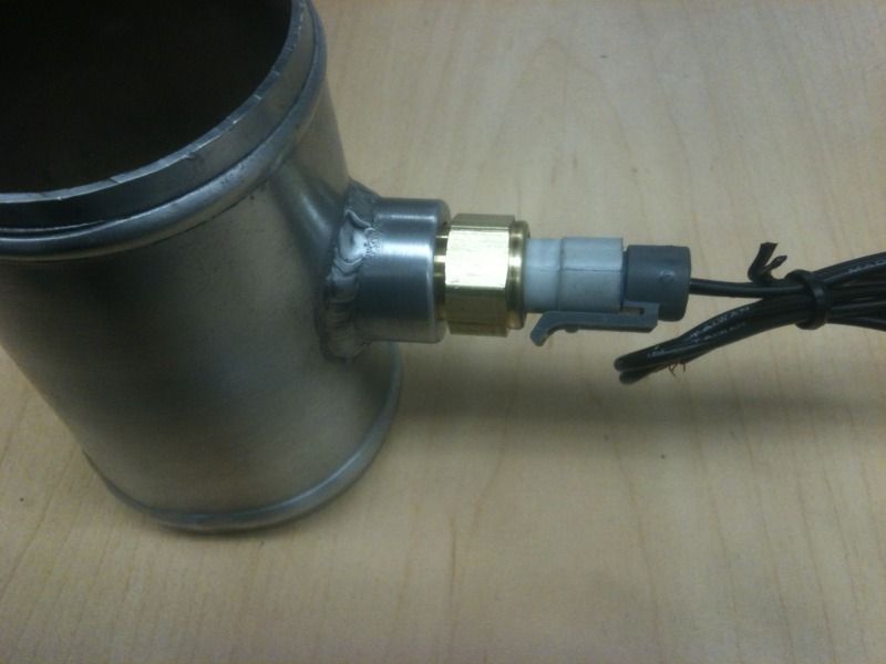

Added an GM Intake Air Temp Sensor. Going to see how effective the NACA ducts in the window routed to the intercooler are. The solid mounted engine and gearbox aren't as bad as I thought. Everywhere on the internet said it would rattle my fillings and shake bolts loose but I like it. Less wheel hop more rocking of the engine. Now to take advantage of the country roads around my place. Ft. Langley has some awesome twisties:D

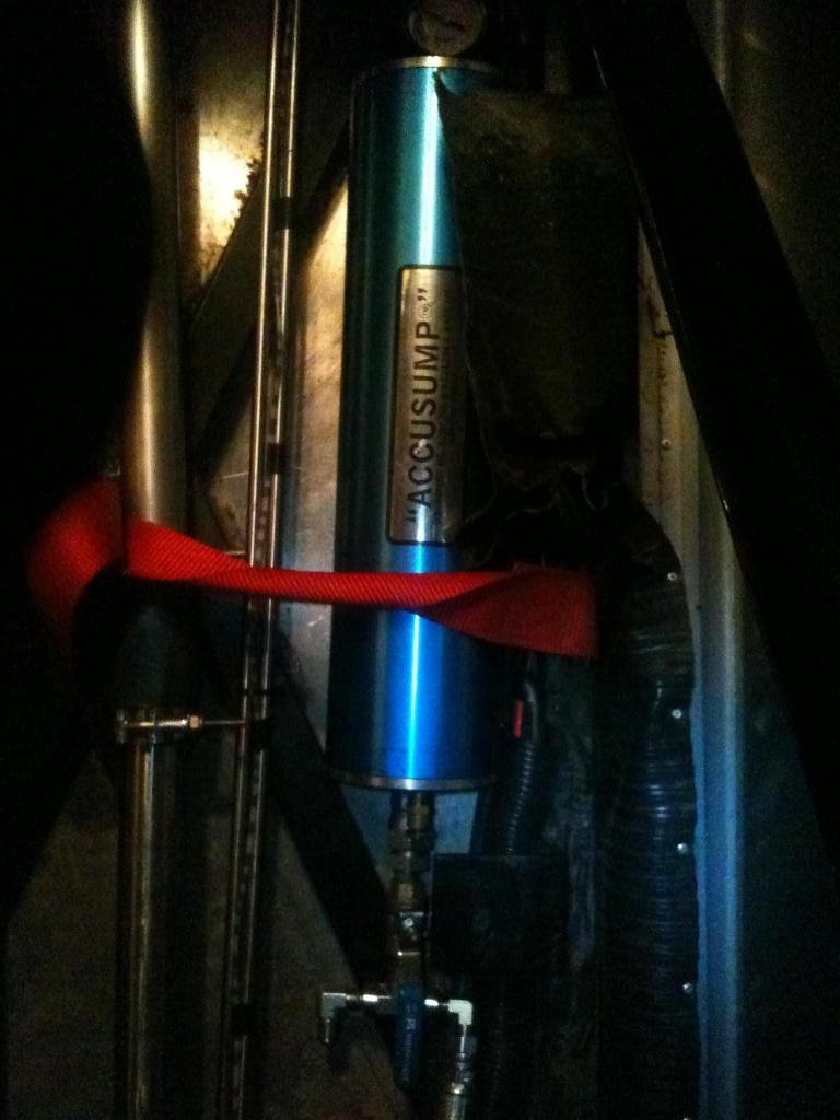

http://i7.photobucket.com/albums/y25...1.jpg~original
Was going to install this accusump but stripped a brass ball valve so need get a new one of those,:angry:

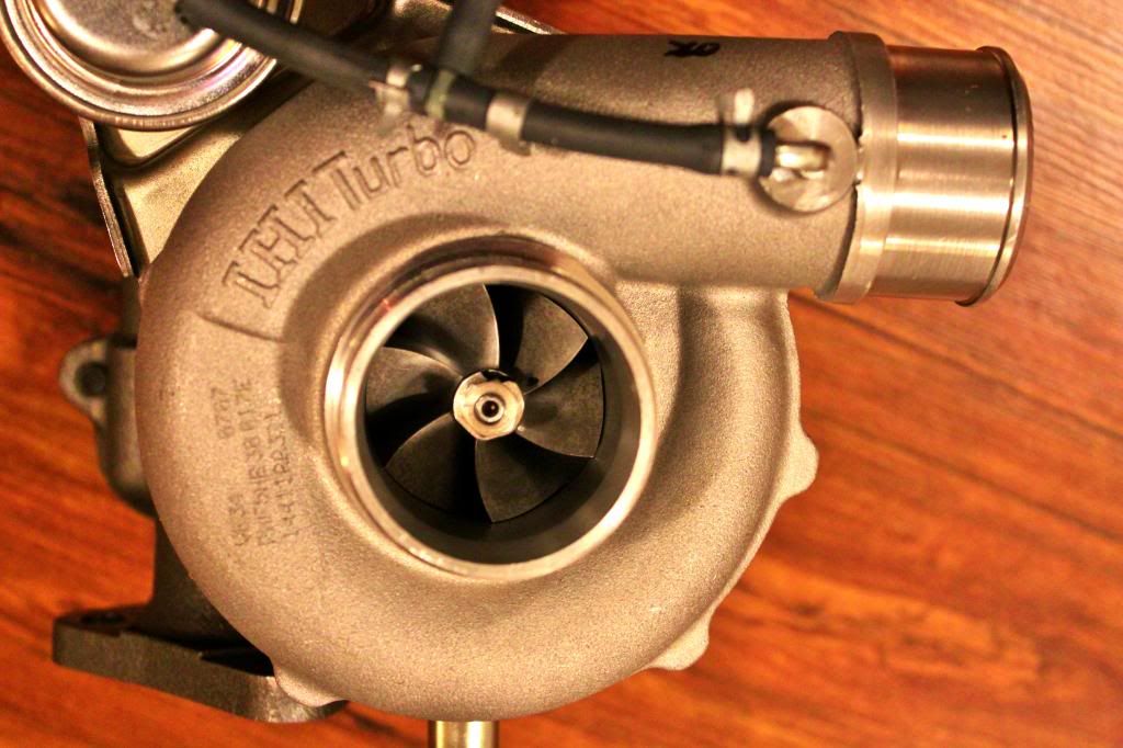

Also finally got this bad boy together. A VF34 ball bearing turbo from JDM STI's.
These little ball bearing units are very tricky to put together especially when you
dont take them apart. Lucky for me I found one disassembled in a box. This is one of the best "bolt on" turbos you can get for the EJ20, very responsive.

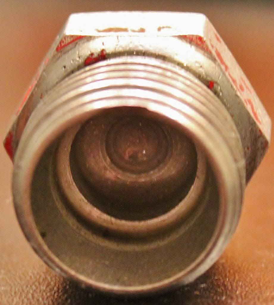

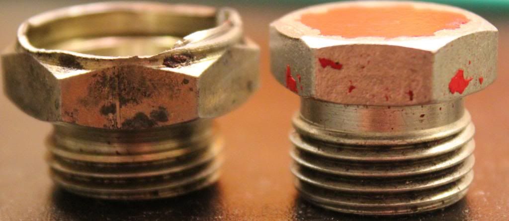

So here you can see the stock reverse light switch and an M18 Plug I got to block off the reverse light portion of my gearbox when I was moving it forward 2". Turns out the 3mm longer in length was causing me a real headache trying to get the car into reverse. It would move back a few feet then start grinding. Ahh!! I had no idea what to do so I contacted Bruce Tweedle who knows his stuff when it comes to gears and he had heard of a problem like this when someone forgot to install a washer on the reverse light switch.
http://i7.photobucket.com/albums/y25...0.jpg~original
You can see on the top of the plug I installed that there is some wear in that area. So I was confindent when making a new plug using the orginal plug that it would solve the problem. Turns out it did! I would have had no clue and probably tossed the gearbox. So I am pretty stoked that this problem was cured quite easily. Let this be a heads up for anyone moving there gearbox forward that this plug can be no longer the OE one.

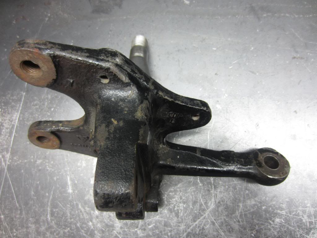

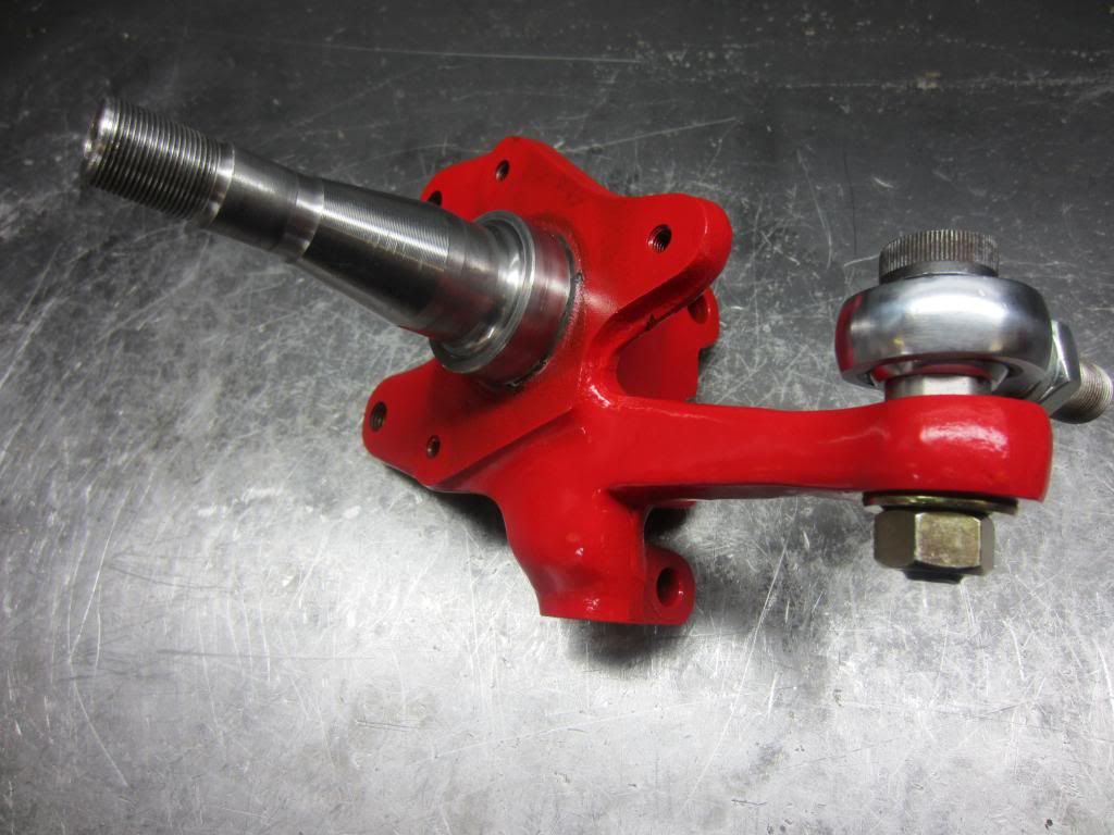

Modified by steering knuckles for for steering angle. I cut 25mm out of the Porsche 944 knuckles and drilled and reamed a 5/8" hole in them. I noticed with my BMW steering rack it requied alot of input to turn the car. Shortening the steering arm will give quicker response and allow for more steering angle. Before doing this the wheels would point about 35 degrees now the wheel will go almost 50 degrees. I will need to "massage" the inner fenders to make room for all of this steering lock.
Stock knuckle.
http://i7.photobucket.com/albums/y25...4.jpg~original
Modified knuckle.

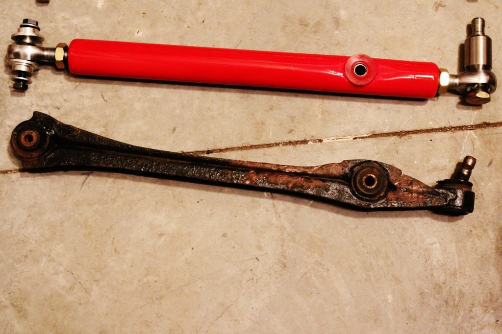

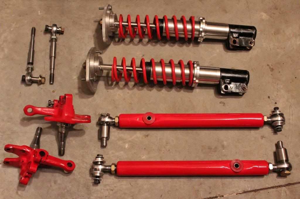

Finally finished my tubular front control arms.
http://i7.photobucket.com/albums/y25...6.jpg~original
Stock vs. Prototype Tubular
This version allows for 25mm roll centre correction. Made in Chromoly.
Length is adjustable from 0-+50mm wider than stock.
3/4" Chromoly Heim joints at both ends.

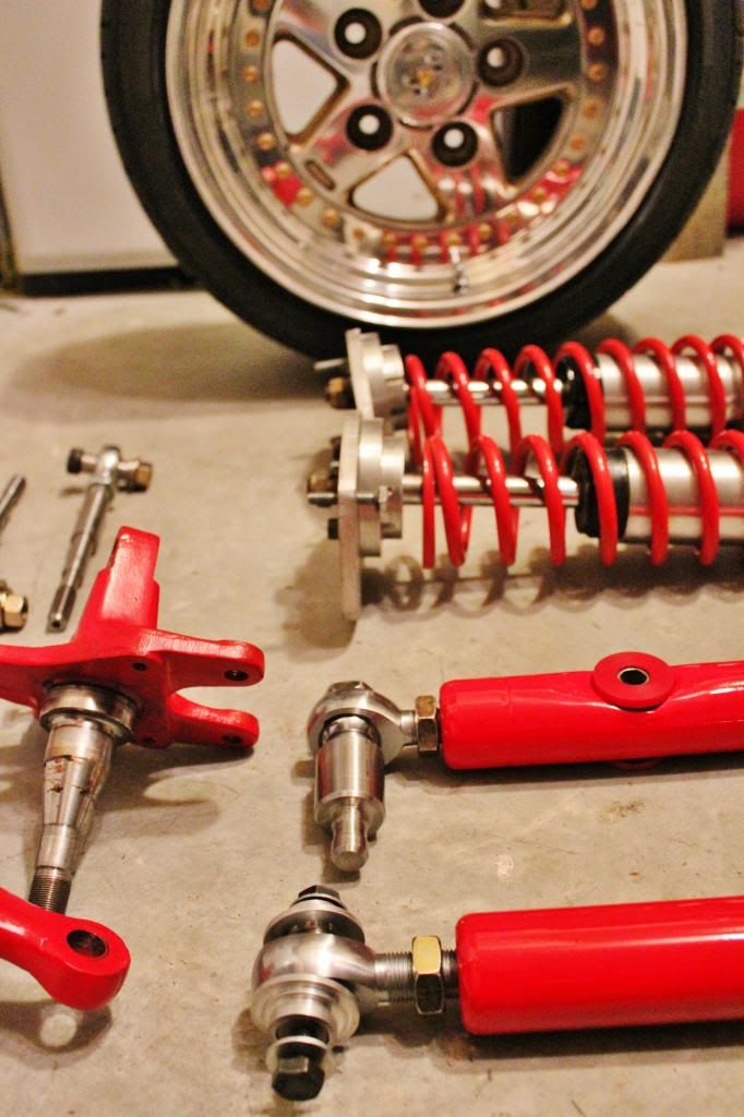

http://i7.photobucket.com/albums/y25...c.jpg~original
More front suspension goodies.
