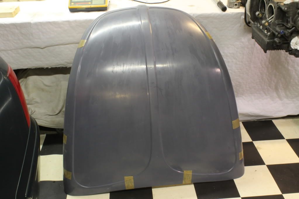

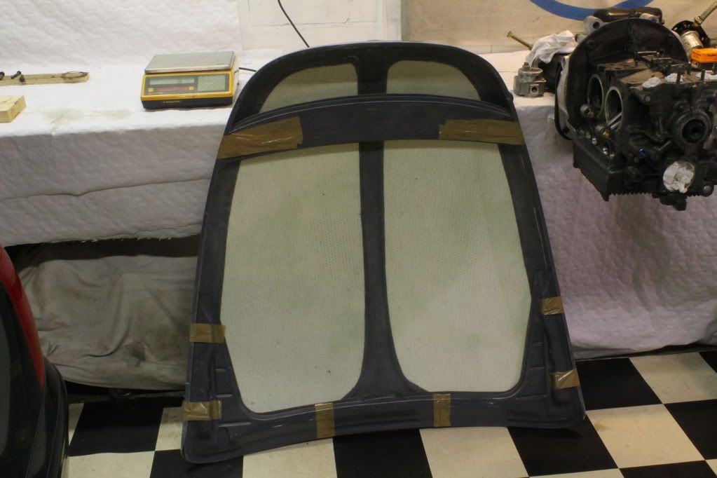

Wally December 1st 2011 15:30
Steel front hood is 8.8kg, this Kerscher 'super leicht' 1303 hood (this light weight version is not on their web-site) weighs 4.9 kg, but needs some adhesive and hood handle, so more like a 3,5kg difference.
At least it won't rust anymore :D
