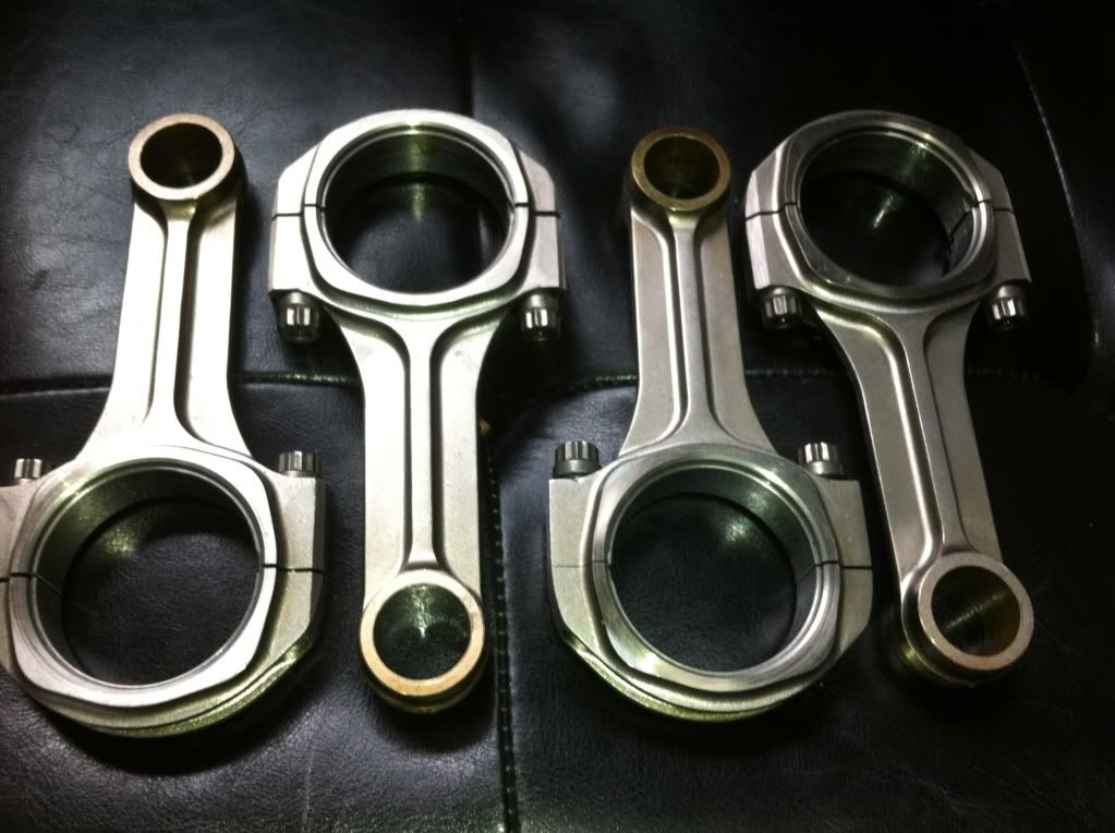

Last week I took the engine apart as I wanted to have the case machined for a different cooling system (more of that later when its all worked out) and another cam to try out.
Good thing I did as all bearings and heads, pistons, cylinders were still in tip-top shape, but the rods were surely not!
One has had a movement is 2 directions, but two others were just bend one way :D Before discussions start if this was the limit of stock rods: NO, its not; this was all caused by boost-cuts of the ecu causing huge back fires that even snapped two rockers if you can remember ;)
Fortunately Jake still had a set of slightly used Pauters, so those are underway :D

Does this mean that you got another set of 1.7-1.8 spec rods?
Or are you going to be getting a crank upgrade?
I look at those "stock" rods,
ANd there sure was a lot of nice work put into them.
Nice trophies for sure!:D
Wally February 10th 2012 17:03
Not yet, but these are underway :D
http://i174.photobucket.com/albums/w...s.jpg~original
The nice thing about the 74mm stroker I still have is that its got the same big end journal as the 1.7/1.8 ltr 66mm crank :)
The problem is the cylinders had to be cut back very short so its doubtfull 8mm more stroke is seen as still safe for how far the pistons will come out then...
But I am sure you know what would have my vote :lmao:
You got that right: LOTS of work went into them ;)

wow, I can't believe the rods bent so bad, that it's very visible in the pictures.. and still nothing failed.

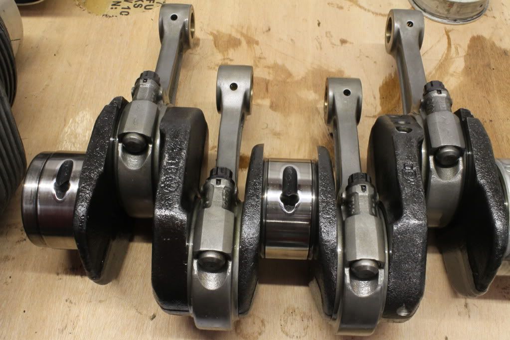

Bradey Bunch February 10th 2012 21:38
Is the crank still straight?
Braden
Wally February 11th 2012 03:41
Braden
Don't know yet as I haven't got the sort of equipment to measure that myself, but crankshaft is spotless and must be straight as all main and bearings were super nice as well:

Wow. Looks like you caught those just in time. They are wall hangers for sure.
hotsauce February 11th 2012 19:54
That coulda been messy! Good thing you tore it down!
