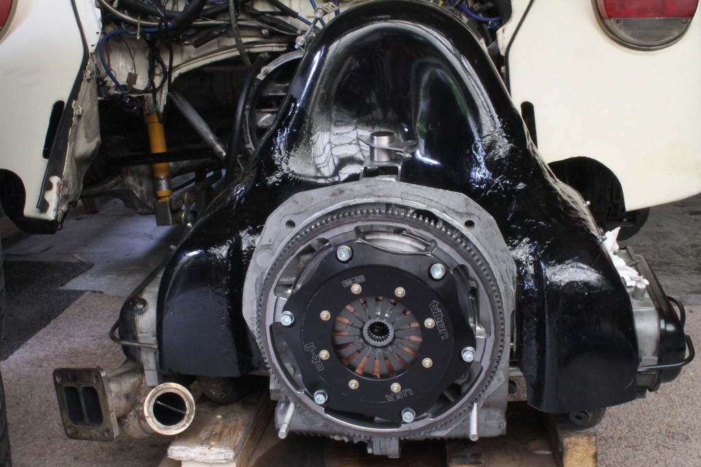

Anyways, I finally remembered a little thing that was almost forgotten: maching the flywheel for the central pinion bearing...:o
Got that done today, so finally the flywheel and clutch are on the engine.
Also bought a set of new CV's for the outer sides only as these Lobro/GKN ones are quality but 4x as expensive as chinese Empi ones (assuming those are the cheap ones).
Hopefully I can finally put the engine in later this week and finish the install over the weekend.

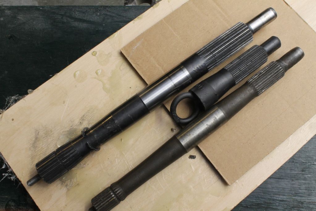

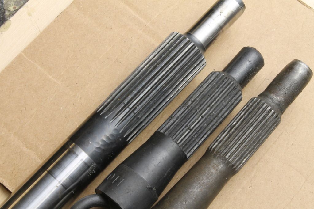

Engine finally in after I was able to lend a 930/G50 shaft to align the dual plates..
FYI, type 1, 915 and 930/G50 splines next to each other...Guess which is strongest ;)

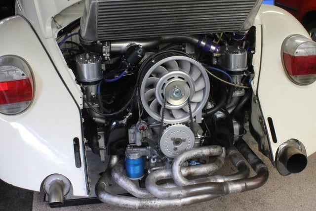

PS I just installed the last bits of my rebuild engine. Hope to start it tomorrow evening and have it running this weekend.
I'll try to take some pics tomorrow as well.
