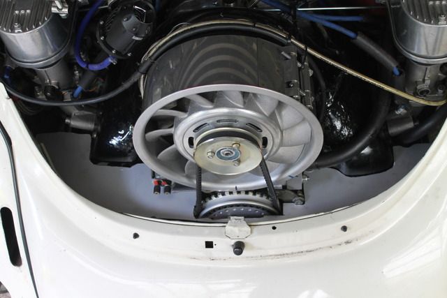

Also made a new rear apron-engine sealing plate:

One quick question: where did you get the degree decal for your pulley? From MSS? I have the same pulley and would like to have the timing marks/ degrees on it also.
Wally June 18th 2012 06:40
Good eye!
I think I had one still lying around from Ahnendorp. Its 145mm and probably a US item (buckpack or similar) originally?
vdubzack June 18th 2012 12:59
Gene Berg makes one that use. Is of really good quality, and easy to install.

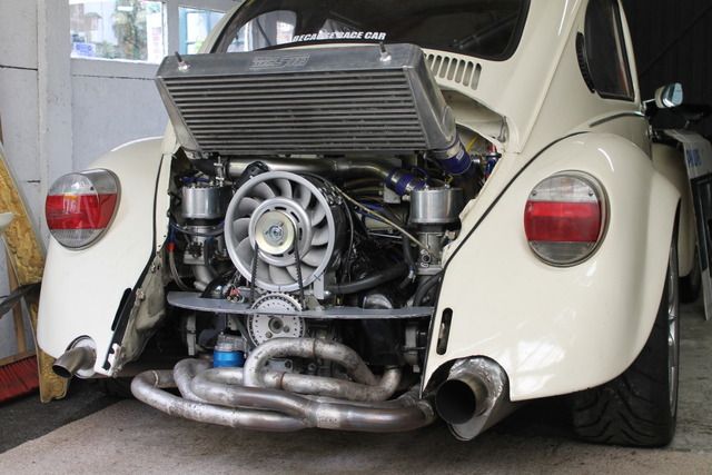

Wally the monster looks great and you will have the time of your life. Just a question really. Is it possible for your intercooler to be tucked inside the engine space. I saw this http://www.turboboxer.de/ and I was really impressed because you cannot really tell just by looking at the car if it has a natural aspirated engine or a turbo monster in there.:cool:
Wally June 25th 2012 08:30
Sure, but it will be less effective.
Functionality over form/looks and all that ;)
