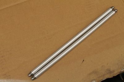

Some testing at 23-24 psi showed the limit of the straight acn's pushrods for me now:
