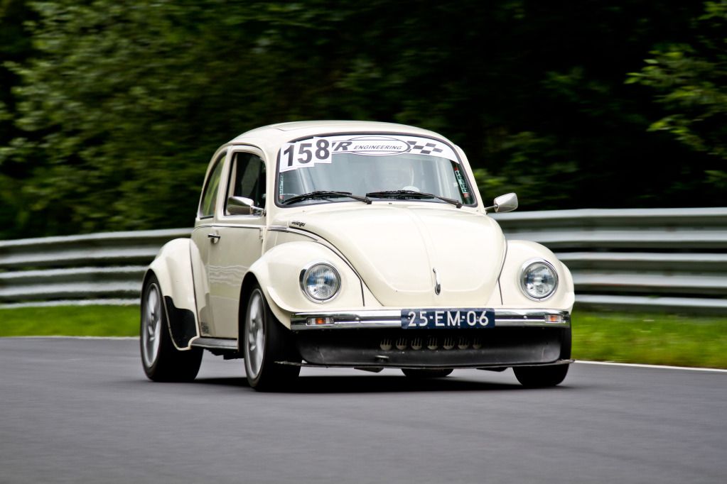

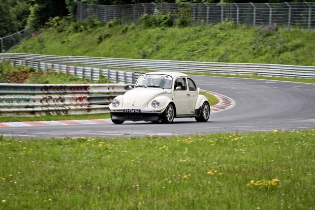

Wally July 11th 2012 05:09
70Turbobug July 11th 2012 12:59
Nice pics! How did it perform with the new turbo?
Wally July 11th 2012 16:34
Quit well. Smaller turbo in combination with the new cam and light flywheel/clutch is very responsive, but generator wiring issues (my fault), some handling issues (loose steering joint I just found out) and lack of driver skill/experience didn;t make that track the ideal opportunity to fully experience the new lower-end powerband.
Coming friday is a trackday at the Assen circuit (famous for its TT event (motorcycles)) and we get lap timers issued there. I have adjusted the rear yellow Koni's almost full-in, reinstalled the front 400lbs springs and took care of the other issues. Plus I know my former best time from last year, so hopefully it stays dry weather and I can do a little better comparing ;-)

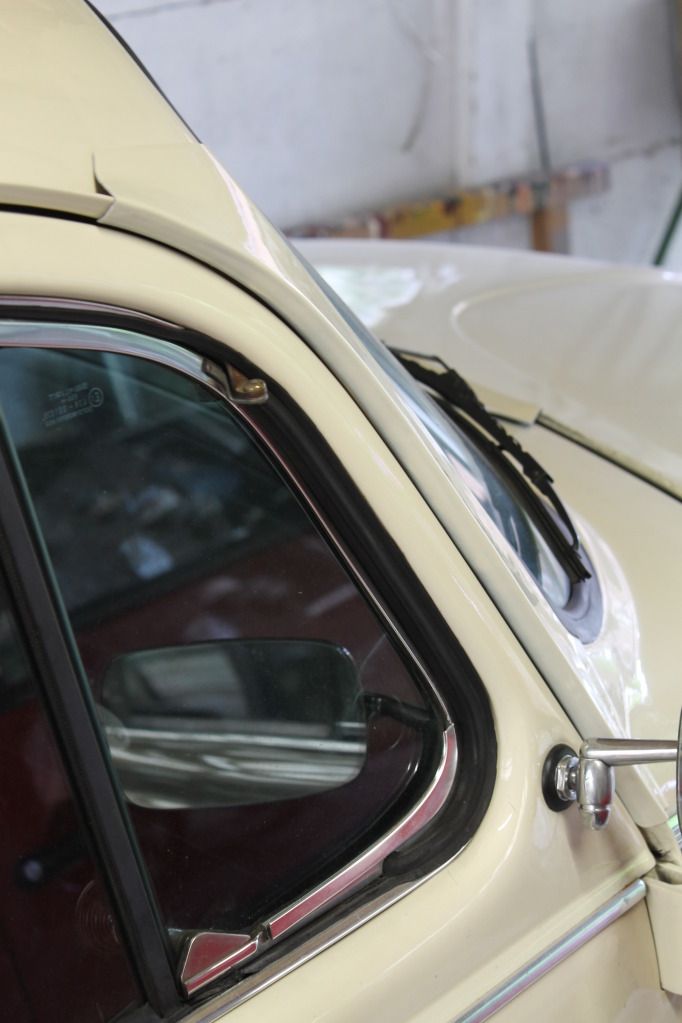

Did some aero upgrades:
http://i174.photobucket.com/albums/w...engaten002.jpg
http://i174.photobucket.com/albums/w...ynamica003.jpg

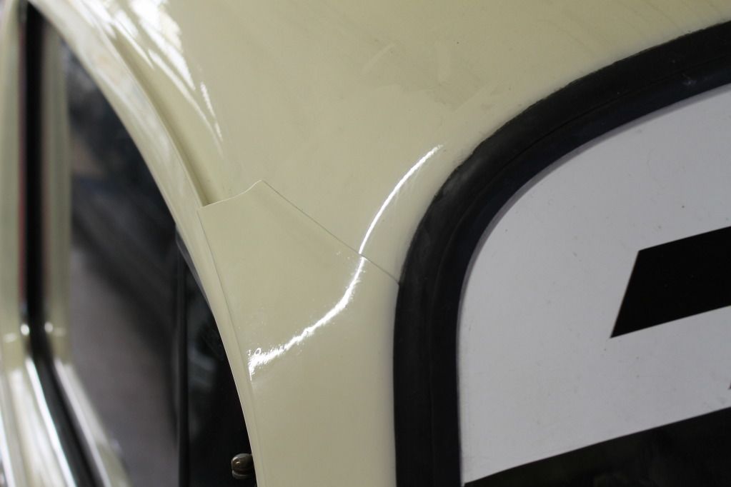

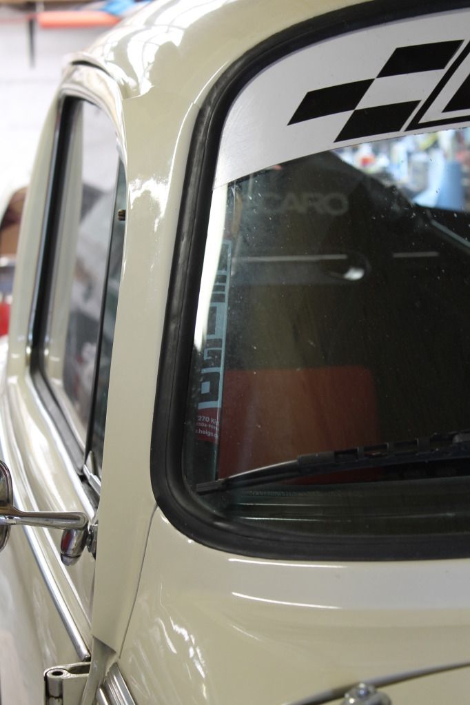

and from Gerrelt his awesome 'Ruf-style' A-piller 'raingutter wind deflectors':
http://i174.photobucket.com/albums/w...ynamica006.jpg
http://i174.photobucket.com/albums/w...8.jpg~original

Cool stuff. I would like to know how the front end feels at speed after the mods.

I understand. 'Unfortunately', I also will try to get a little (about 1 degree) extra caster from some adjustable top strut plates which John from www.mebejo.nl will try to make for me in the next two weeks. Plus a realignment to follow.
So, there will be two major changes that will influence straight line stability and the fender gills will be hard to judge on their own...
Sorry..:o
70Turbobug July 20th 2012 01:07
The car will be quieter at high speed, especially with the rain gutter covers.That's a good indication that the aerodynamics is working.I don't think it will change the stability very much,but should allow a couple of extra Km/h top speed and as mentioned less aerodynamic noise.

Since I seriously want to try to run 10.99x at Santa Pod this year (1/2 september at VWAction), all those little things should help some ;)

Front fender grills are just for airdinamics and better stability? i was thinking of better brake cooling...
You get more and more body mods. Some plans for running boards, mirrors, bumpers? easy weight savings are posiible there. But then you moving out away from original look.
