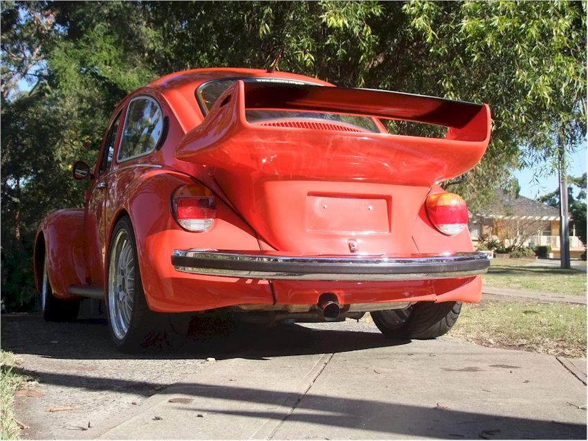

my big arse wing, yet to test it
http://i1184.photobucket.com/albums/...7.jpg~original

You know i run a big wing at the back and dont reach the same speeds as you, mines geared for 116mph@7000rpm.
i would not not race mine with out as it makes thats much difference. I ran it at north wheld drag strip and ran 14.00 [no quicker than it was running with the wing] the run was fine but when i lifted off at the top end [only 86mph] it tryed to swap ends on me. I drove straight back to the pits and bolted it back on.
It may look ugly and out of place but it works and works well, the front spolier/splitter along with the rear wing made a 4 second improvement at Prescott hill climb which is under a mile long.

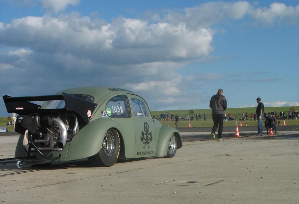

This is more like what I think will work well: big side end plates and higher placed horizontal plane:
(tnx to CSP for the pic)
http://i174.photobucket.com/albums/w...o.jpg~original

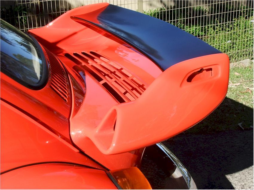

I guess I'll chime in since I've got the largest rear wing around :lmao:
I've found that even at 60-70mph when the bug was at the limits, those limits were lower without the rear wing on my car. Over 100mph got sketchy very quickly going into braking zones because the rear was already sooo light. With the wing the car stays planted and the faster you go the more you notice the stability. Since your intercooler relies on airflow over the back window I'd suggest running a single or dual element wing, even with the top of the back window and over the vents vertically. That's how I've got mine setup and I can speak for it's effectiveness.
http://i93.photobucket.com/albums/l4...i.jpg~original
