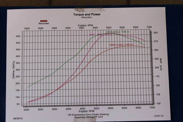

Just got back from Dyno-day (BTW 564 Nm = 418 lbs.ft) :):
Bug@5speed(US) September 29th 2012 16:52
Wally is that wheel or adjusted at engine regardless very impressive and unbelievable.
Congrats
Wally September 29th 2012 17:07
Thanks; thats corrected to flywheel-hp. A healthy totally stock 1584cc T1 with just cheap header exhaust made 55 hp and another stock 1600 with electronic ignition made 52hp, so the dyno seemed very well calibrated.
I think it turned out to be about 15% correction iirc, so its about 400 RWHP for you guys ;-)

70Turbobug September 30th 2012 11:54
Wow! 564NM!! It seems the new cam did make a difference.300NM at around 3600rpm! I bet it pulls like an elephant on crack....
Well done Wally!!
judgie October 1st 2012 03:20
is the small dip at 4000rpm the cam coming on? my n/a engine has the same small dip at 4000rpm as it comes on cam. very good numbers and i hope we can match your numbers with our new engine.
Wally October 1st 2012 04:15
Calling that a dip or even a small dip is somewhat eggagurated perhaps, but I think I understand the spot you mean.
But no, thats not the 'cam coming on' imo. Cam comes on much sooner then that, as does boost. I'am sure I can tune that out if I wanted to, but it would be for visual pleasure only. Its not like you feel that minute change in rising rate hp-climbing ;)
I think the engine is now 'perfect'. Early super high torque and very high hp when you step on it some more. It does everything you throw at it. I wouldn;t know what to change or what would make it better. It also picks up from 1200 rpm onwards in 3rd gear (mine is a long one too) crawling through town.
So, I was thinking of selling the engine and all ancillaries that make it work (for way less then the parts cost alone) to finance my new '36hp Challenge' -love and I would also love to see the Apfelbeck-project through someday.
