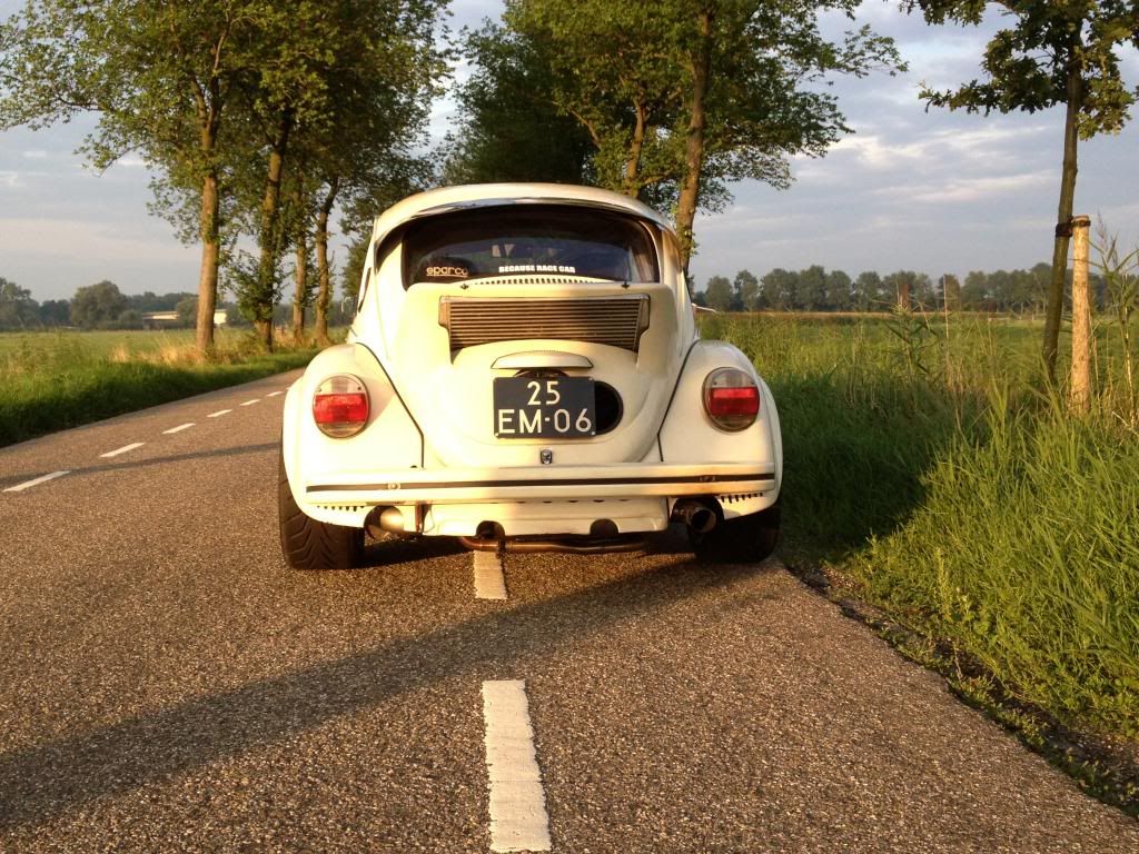

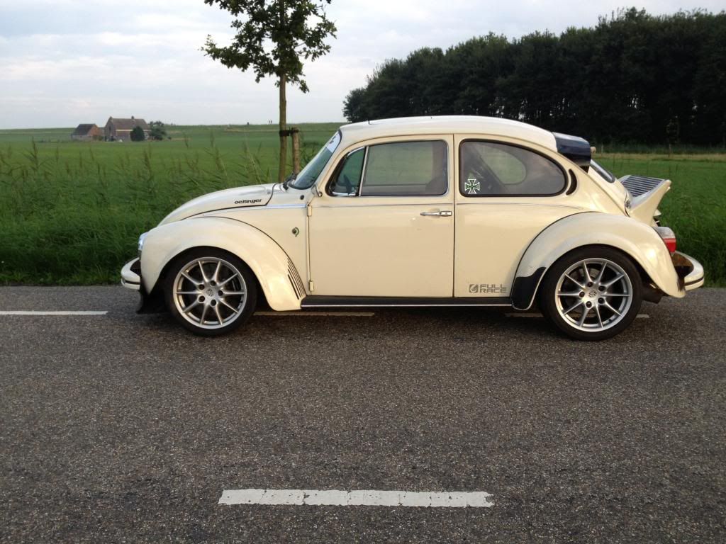

Current pictures ;-)
http://i174.photobucket.com/albums/w...b.jpg~original
vw1303 August 19th 2013 16:15
Looks awesome Wally!
What rear spoiler is that? Sorta looks like Dr Holzapel(sp?) one on that race bug.
Wally August 19th 2013 16:52
Yeah, its a one-off Gerrelt made me, but it took so much time, that I'am not sure if he wants to make another anytime soon...
volkdent August 20th 2013 01:28
Any thoughts on what the front fender slots and the "wing" did for you? I'm really interested in the front fender slot feedback, not sure I could pull of the rear window wing but I'd love to know how it works.
Wally August 20th 2013 02:59
Sorry Jason, I can't tell what effect the fender slots in itself have or had. Neither with the roof extension as I only drove 10 miles or so with it when the current 1192cc type 1 compound turbo engine seized...

Humble August 22nd 2013 13:44
I'd love to get details on the roof spoiler and the rain gutter panels you made.
