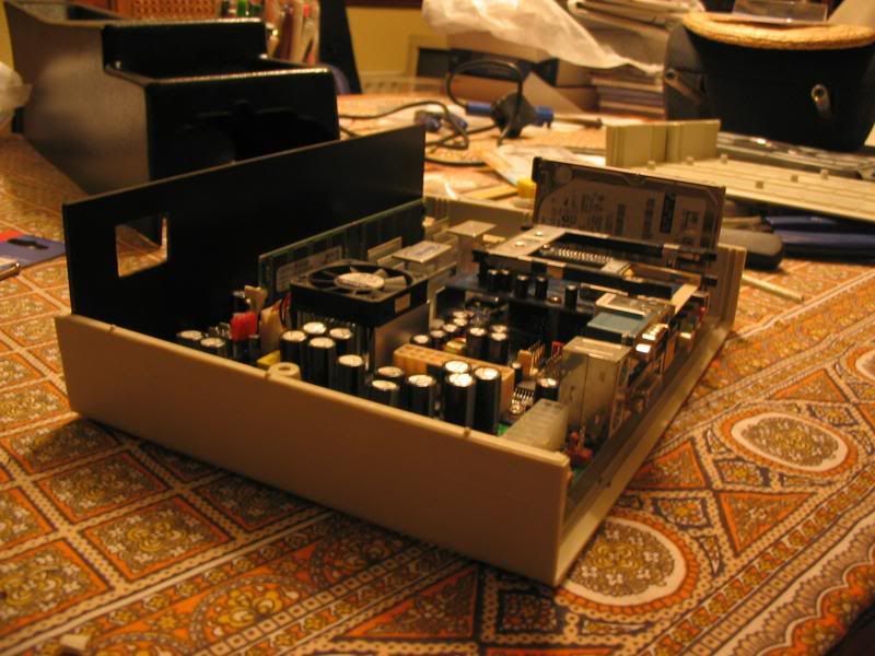

al_kaholik October 31st 2011 14:33
I looked at this years ago and everyone told me I was mad it was not necessary and it was completely OTT...
http://i61.photobucket.com/albums/h6...6.jpg~original
http://i61.photobucket.com/albums/h6...k.gif~original
http://i61.photobucket.com/albums/h6...2.jpg~original
Its still on the back burner - my dad had it in his Passat GL5 for a bit
