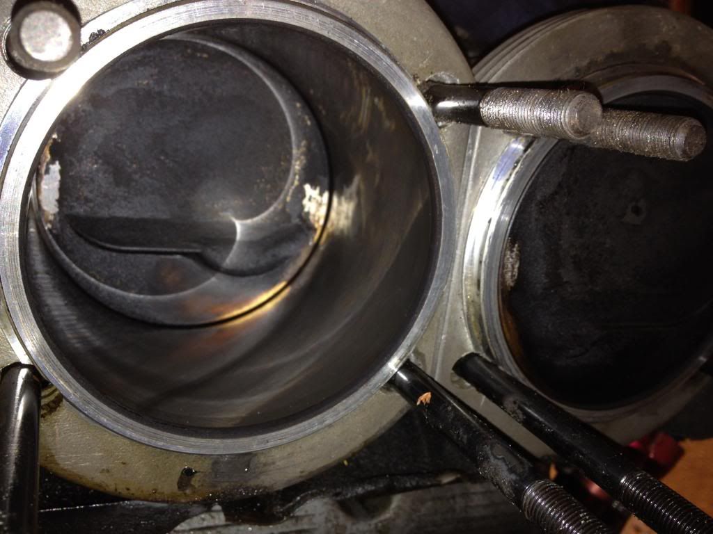

Wally January 24th 2014 11:25
http://i174.photobucket.com/albums/w...f.jpg~original
70Turbobug January 24th 2014 12:19
Thanks Wally! They look pretty good. How many Kilometers are on them? I wonder how they would hold up under boost.
Wally January 24th 2014 12:25
Dozens of hours of trackdays. And I really mean a full trackday, so hours in a row of continous 'Nigel-driving' (his foot is heavier then mine), mostly with passengers onboard as well.
Twice his V-belt of the alternator/cooling did come of and a full lap was done before noticing...the engine was soo hot, it pinged at idle...
New belt, exhaust bolts reattached (they came out because of the heat) and it started directly and went on for more laps and track days...
They have been tortured I just want to say!
spannermanager January 24th 2014 12:42
Its during 'events' like the overheat that quality stands up to be counted, cast pistons, or even poor quality forged ones would have seized or collapsed completely.
Wally January 24th 2014 15:53
Yeah, I agree spanner. His heads weren't fractured either. It didn't came as a surprise that most exhaust studs and a few rocker studs were loose though...
Only after having witnessed that (his engine keeping running so well like it did after all the torture), I was confident enough to consider a set of billet heads for the street for myself. And further strengthening the believe in how important alu cylinders are in shedding heat.

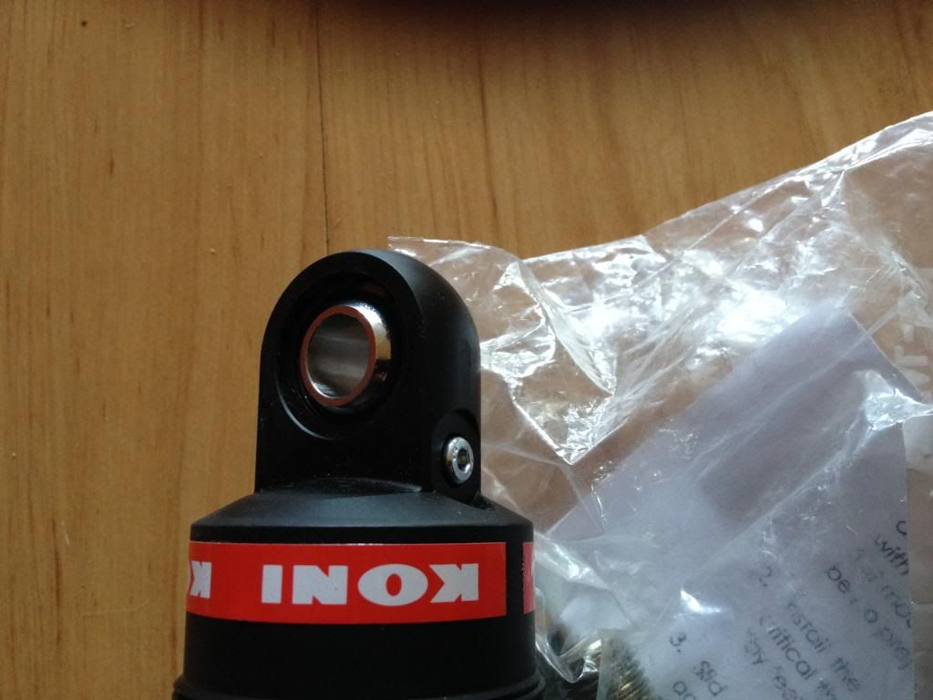

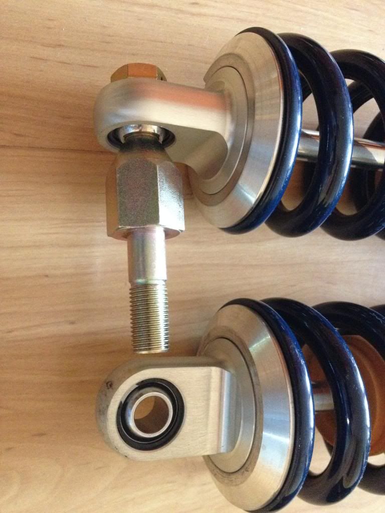

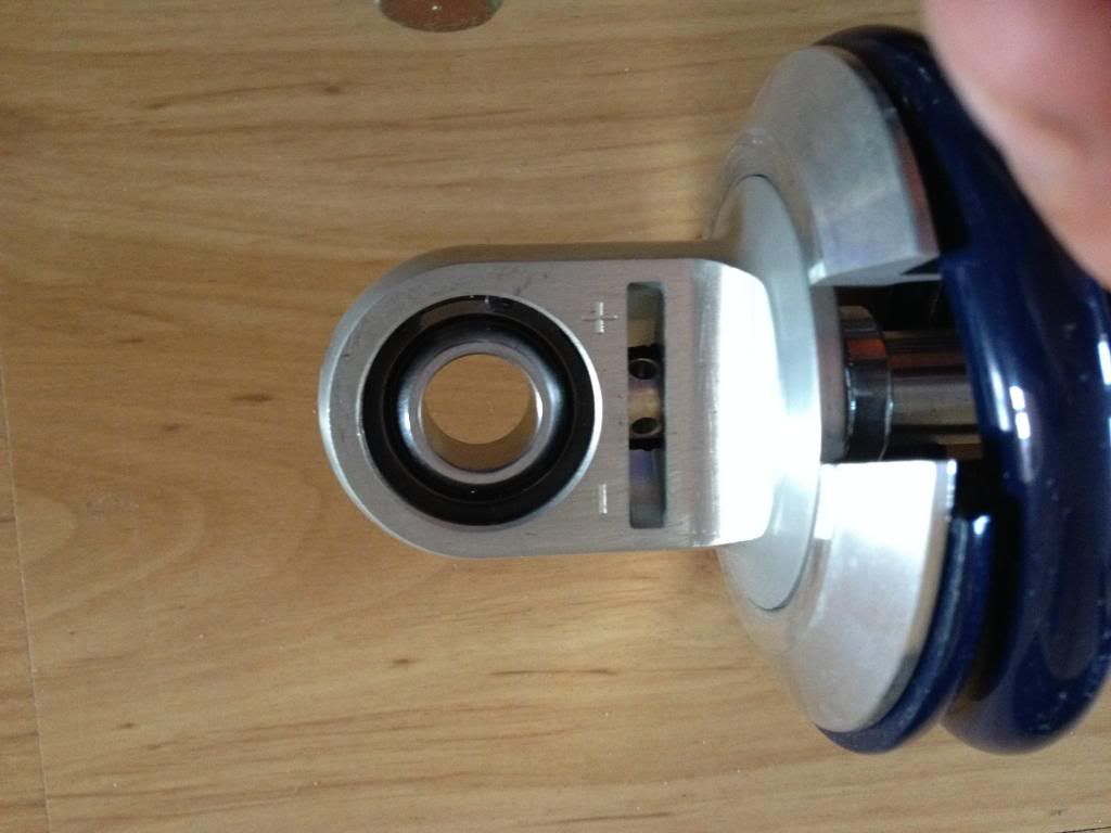

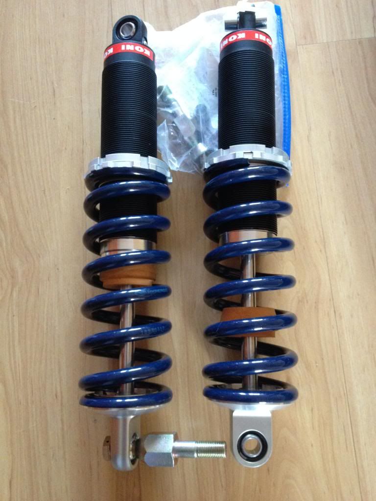

After long time saving and a very long waiting time, my new Koni coil-overs arrived: up-side down aluminium bodied beauties with top and bottom ball-joint (sp?) attachment points. Hopefully they function as well as they look the part...
http://i174.photobucket.com/albums/w...b.jpg~original
owdlvr June 1st 2014 13:25
Nice! You're going to be quite happy with those I think. If I ever build a "proper" Germanlook, ie one used on tarmac exclusively, it will with be Koni's at all four corners.
We use a loop of Bicycle tube to keep dirt out of the adjustment slot. Easy enough to move it to the side for adjustments, but keeps the dirt out.
Wally June 1st 2014 13:31
Tnx for that excellent tip Dave!
