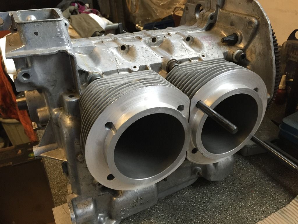

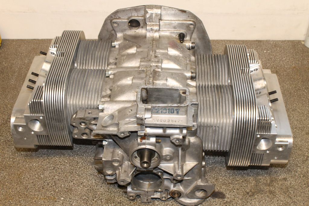

Wally July 17th 2016 03:54
I see I need to update a bit here :)
Finally got the cylinders machined to fit the heads. I kept wall thickness as big as possible and ended up with almost 9mm wall in the 98mm bore!
First trial fit with heads and cylinders test-assembled:
http://i174.photobucket.com/albums/w...h.jpg~original
70Turbobug July 17th 2016 10:14
Looks fantastic!
effvee July 18th 2016 05:13
Wow,it look fast.

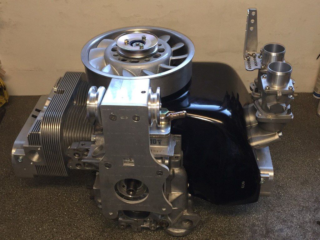

Wally August 13th 2016 12:58
The (Pauter) rods and straight cam timing gear are ordered, so I should have all parts for the long block in a month or so :)
effvee August 13th 2016 13:17
Wow, didn't know, they allowed porn on this site :D. Very nicely done.

Bad bug August 13th 2016 14:26
Walter is this a ortech shroud.
Wally August 13th 2016 16:06
Yes, its an Orratech system. It wasn;t designed for type 1 exhaust port heads though, but thats easy.
