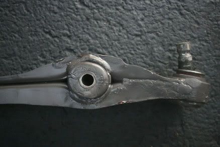

can anyone give advice on pressing in/out ball joints on my '79? i went to 3 places here in bowling green and no one could do it, including the Caterpillar dealer whose huge pneumatic press couldn't budge it! four Cat mechanics couldn't figure it out, but they did manage to bend the end of the arm about an inch.
don't mind the crappy paint job. i shined 'em up so they might be more careful and i haven't replaced the painted-over bushings yet.

You'll have to replace them at this point, they're too beat. Did you use penetrating liquid like WD-40 for a week or so before your attempt?
wrenchnride247 September 21st 2007 20:30
Ouch! :eek: That arm is bent! You might want to source another set of trailing arms. The camber will be out of spec, and your new ball joints may bind at that angle. I restored a '79 Vert for my father-in-law five years ago, and his ball joints pressed out OK. I have a ball joint press with correct receiver tubes so no stress was put on the arm itself. I don't remember the arms having that much angle. (they were straight IIRC, not angled down like that)

yeah, that arm's done. luckily they didn't try to remove the second ball joint. nothing on my car had been replaced since '79, including the brake lines, so i'm sure the ball joints have never been off.

i'm just not sure what to try differently on the next two arms, since i went to the people with the biggest presses around, to my knowledge, and all i got was a bent arm. :disagree:

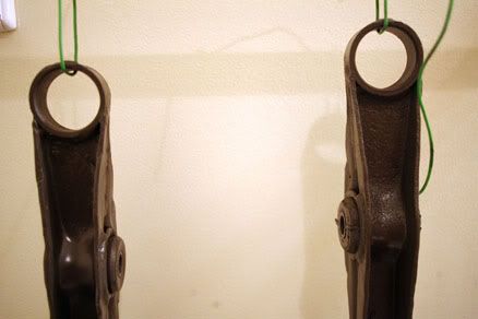

well they're out! i didn't get to try the coke trick because i couldn't get arms until a couple of days before i took 'em. the local machine shop heated them until the ball joints fell apart and then had to cut out the races (or whatever that'd be called). those suckers were stuck!
