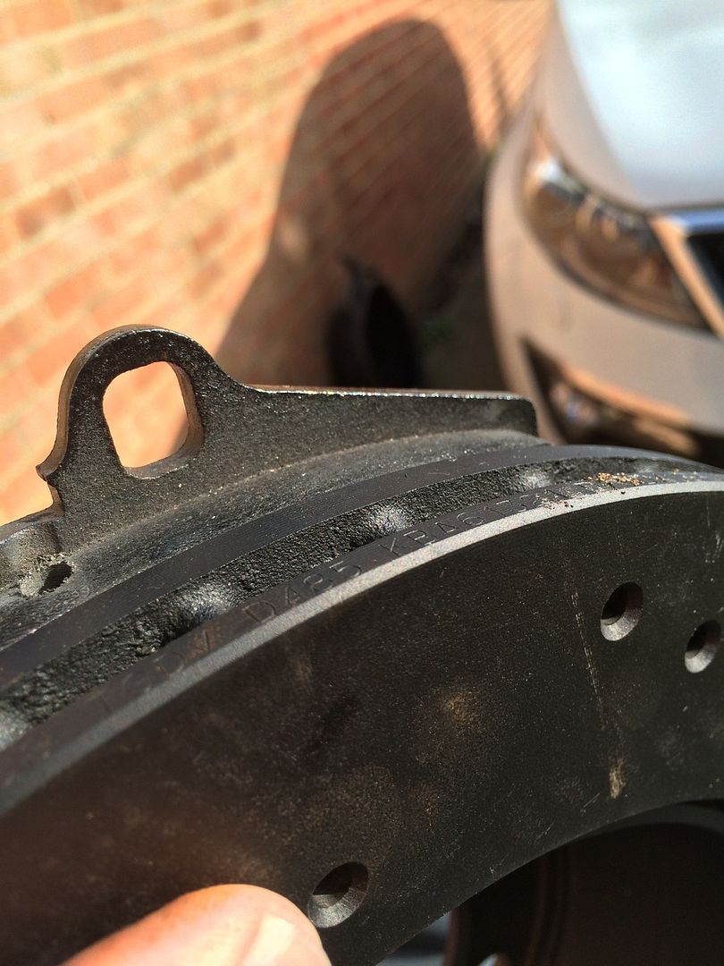

effvee I uploaded some photos.
My calipers are not yet attached. I put them on just to see but for the rears there is no room for the whole brake pad.
Front:
http://i60.tinypic.com/20ucqx2.jpg
Back:
http://i59.tinypic.com/23usny1.jpg
Top (see the overhang, about 2.5mm):
http://i58.tinypic.com/r1ejia.jpg
kai4130 please report back.
addition: The Boxster rear rotor will not clear the handbrake shoes and hub and the Boxster S rear rotor has a bore of 98mm instead of 103mm that we need, so it requires some machining there. xD It also has a height of 67mm instead of 71mm.

Finally have my car back and all the hardware required to fit these brakes. Had an email exchange with Lanner and I can confirm that both me and my mechanic can't eyeball size any thing for **** :lmao::lmao::lmao:
I have used Lanners brackets and hardware, 944 NA Disc brake arrangement, 944 NA Disc , 987 calipers and pads.
it was very easy to swap everything out and Lanners brackets make it a bolt on affair. I did shave some metal off from the inside of the outside pad however I don't think it was really necessary.
