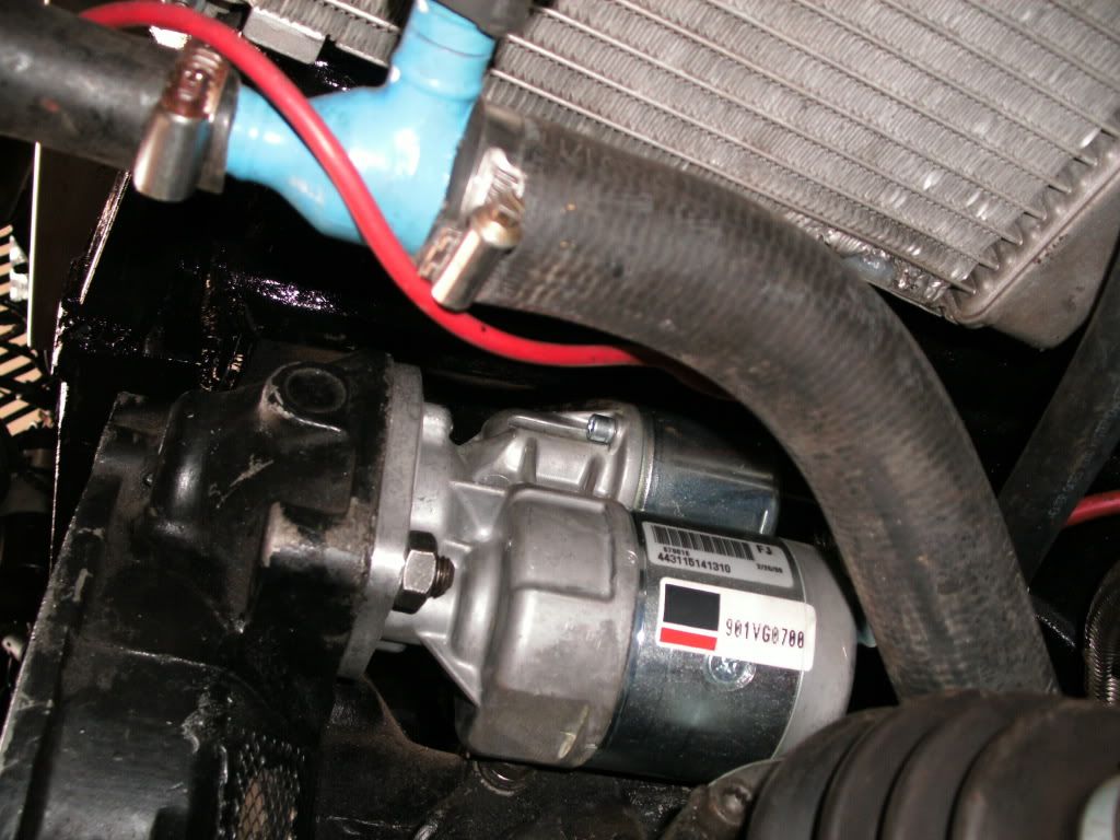

volkdent May 14th 2010 16:02
I had mine custom made, it fits behind the spare tire well and in front of the frame head, only possible with the suspension I have.
http://images.thesamba.com/vw/gallery/pix/399334.jpg
Ducting is a HUGE part of cooling, and even though my radiator is relatively small, it hasn't been a problem with cooling, mostly do to ducting, as the radiator never sees clean air tucked up under the front end.
http://images.thesamba.com/vw/gallery/pix/241582.jpg
http://images.thesamba.com/vw/gallery/pix/680177.jpg
Excuse the ugly gun barrels... but this scoop gathers up a lot of air and forces it through the rad.
http://images.thesamba.com/vw/gallery/pix/247656.jpg
The other issue not mentioned here is BLEEDING the system. If there are air bubbles trapped it doesnt matter how big the rad is or how well it is ducted. Here is my bleed area on the high point up front.
http://images.thesamba.com/vw/gallery/pix/247653.jpg
Here's where I ran the coolant lines. They are in air flow so they aid in cooling, are easy to get to and protected
http://images.thesamba.com/vw/gallery/pix/266772.jpg
This is how the lines are currently attached, in the previous pics I had just mocked them up. This method is really simple and effective, I used a Dremel and a cutoff wheel from the inside to create the slots to run the hose clamp through.
http://images.thesamba.com/vw/gallery/pix/680175.jpg

volkdent May 20th 2010 19:05
If the seam between the apron and floor of the tire well is cut, then the metal bent down to act as a duct, a lot of air can be forced/gathered.
Then the cool air has to be sealed/ducted to be forced through the rad.
Finally, the area behind the rad on the back wall of the spared tire and below the gas tank has to be swiss cheesed or at least opened up enough to allow the hot air to escape. A push fan can be added to the front of the rad, or if the rad can be placed away from the back wall, a pull fan behind, to get the airflow if not travelling.
You'll end up with a much more subtle look than the common "nostril" effect of cutting holes in the hood, much more sleeper. The area in the spare tire well is large enough to get a large radiator in, and a custom aluminum with enough water volume should keep it happy.
The 2 keys are:
- sealed ducting to trap and force any airflow through the rad and allow it to escape out the back side
- making sure you've completely eliminated any trapped air in the coolant line.
http://images.thesamba.com/vw/gallery/pix/682110.jpg
Here is one in action. It doesn't have enough ducting in my opinion, but they've cut the whole area out behind the rad. They went with the in-betwee aproach to air inlet by cutting out the front of the apron instead of the hood, but it's still obvious compared with just adjusting the floor of the tire well. He's running 280hp BTW.
http://germanlook.net/forums/attachm...2&d=1220296940
