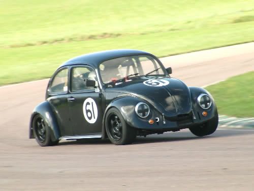

spannermanager January 8th 2011 16:32
http://i254.photobucket.com/albums/h...2.jpg~original Here is my beamer baiter on a qualifying lap. My mental data logger says i pull something over 1G on control road tyres, its harder to add lock on this l/h turn as my arm is too heavy with G!:lmao: . this season i am moving up to race tyres with updates to the setup. here you can see the main weakness of the t/b front suspension with no camber recovery in roll, the rear roll is soft here to keep away from excessive over steer, but is now addressed for this season with softer t/bars and stiffer ARB... i hope;)... best regards, Spanners.
Sandeep January 8th 2011 21:10
Now that's a great picture !
Do you have some links / specs on your car available ?
spannermanager January 9th 2011 14:57
Thanks Sandeep,:) i WILL get my albums sorted into order and post up a link to it, the car is constantly changing and will always have a development plan. its nothing special spec' wise, and no show car, its raced hard, and has had many fights, even a 1/2 roll, and its still alive!
My mantra with this car is to keep it as original VW as possible, apart from complying with various rules, this makes for quick and easy repairs, one BIG advantage of a beam if you do shunt it, all at affordable £££.. and it annoys the hell out of Porsche drivers:angry:. briefly, as in the pic taken in 2006, it had a T1 1835 with about 145 hp, 421 exhaust, 10.8 cr, dry sump, and , wait for it, a Scat CAST crank,... T1 IRS box with all the tricks but a free diff, 100 mm cv's.
the beam uses split torsion bars and is 1" wider than stock, adjusts for corner weighting, 22mm front ARB, 6 pot Tarox front brakes, VERY light, stock bug calipers on the rear, car weighs 710kg wet in aircooled spec.
Its put on some weight now, as the biggest change for this season is the motor, it now has a 2.5 ltr OKRASA wasser boxer, just waiting for a break in the weather really, to get it out for testing..... Best regards, spanners.
