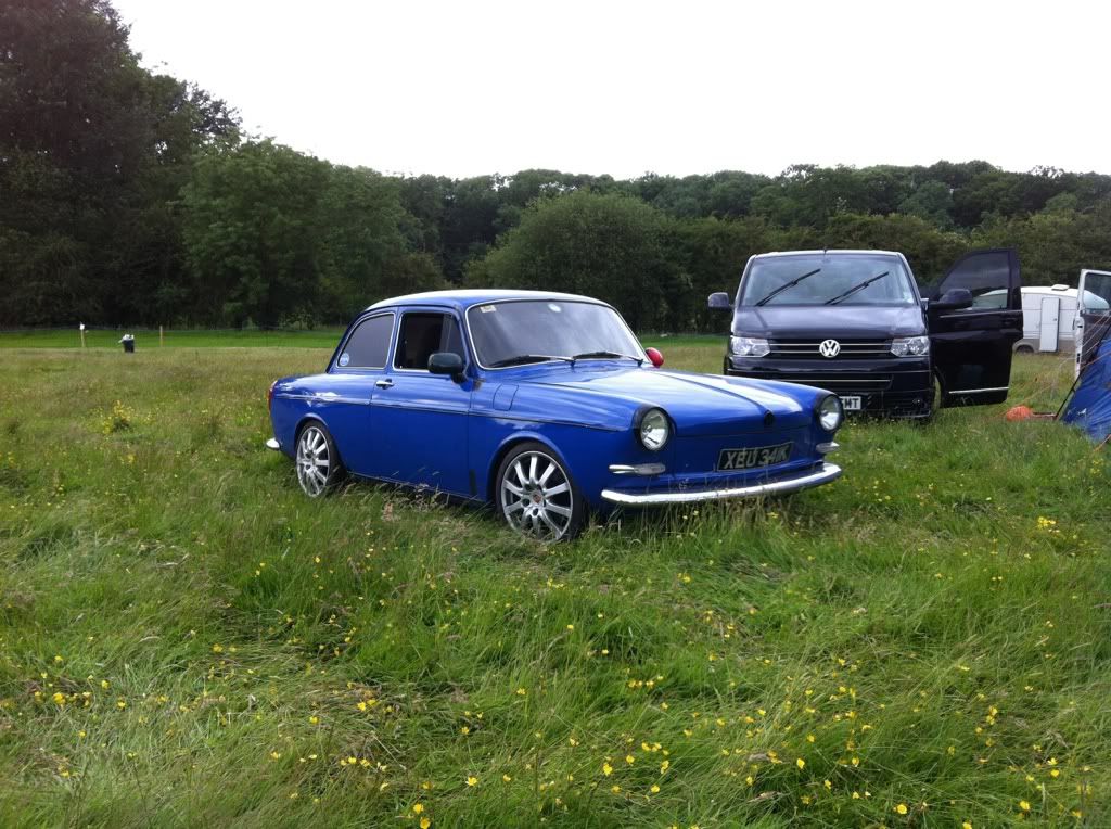

I want to go 2 liter subaru turbo with porsche g50.
I have a 1303 with a cage,and the brakes and suspension is complete and its got 18 inch rims.
I know who I want to do the engine and gearbox workand have found a good subaru engine builder who I am more than happy with.. I need to give him an idea of how I want the power to be delivered for street use,ie not sudden bursts of power when the turbo kicks in that will throw me in a ditch.Any input from those members on here who have driven beetles on the street with 300 -350 bhp would be apreciated. I can apparently have five maps with the aftermarket ECUs so i gues that covers most situations ? I just want to ask advice on drivability, turbos clutches ie porsche or subaru hydralic ? adapter plates, etc basically a parts list.When buying a g50 what else should I try to get with it, drive shafts ? any advivce on shifters for the G50 ? drive shaft setups ?
It might seem that I am asking members to reveal all in one thread but I have done tons of reading and research on here over the years and I thought it woul be a good idea to get a thread together with lots of info in one place.I think it would also be interesting to see peoples different ideas of there ideal setups.Also any other pitfalls and problematic areas and things to be aware of
I would like to thank in advance all those involved in the site and members for keeping me interested and motivated in this great hobby of tuning/modifying of these amazing cars.:) AND YES I WILL GET THERE ONE DAY SOOOOOOOOOOOOOOON :(

So parts list so far
ej20 closed deck block with 92.00mm (Std bore) Wossner forged pistons
ACL main and big end bearings
Std size crank (rear thrust position)
Williams H beam forged steel connecting rods with arp bolts
High pressure oil pump
Cometic 1.2mm steel headgaskets
Version 4 STI cylinder heads
After market ECU
bosch high pressure fuel pump ,lift pump,swirl pot
rjes shallow sump
Porsche g50 short nose
Kennedy adapter plate ?
any suggestions on clutches apreciated, ie subaru porsche
