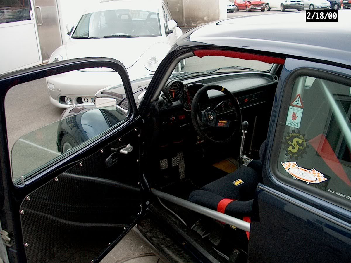

Just added some photos of my ride!
I will change them during the assmbly process. Please let me know what you think!

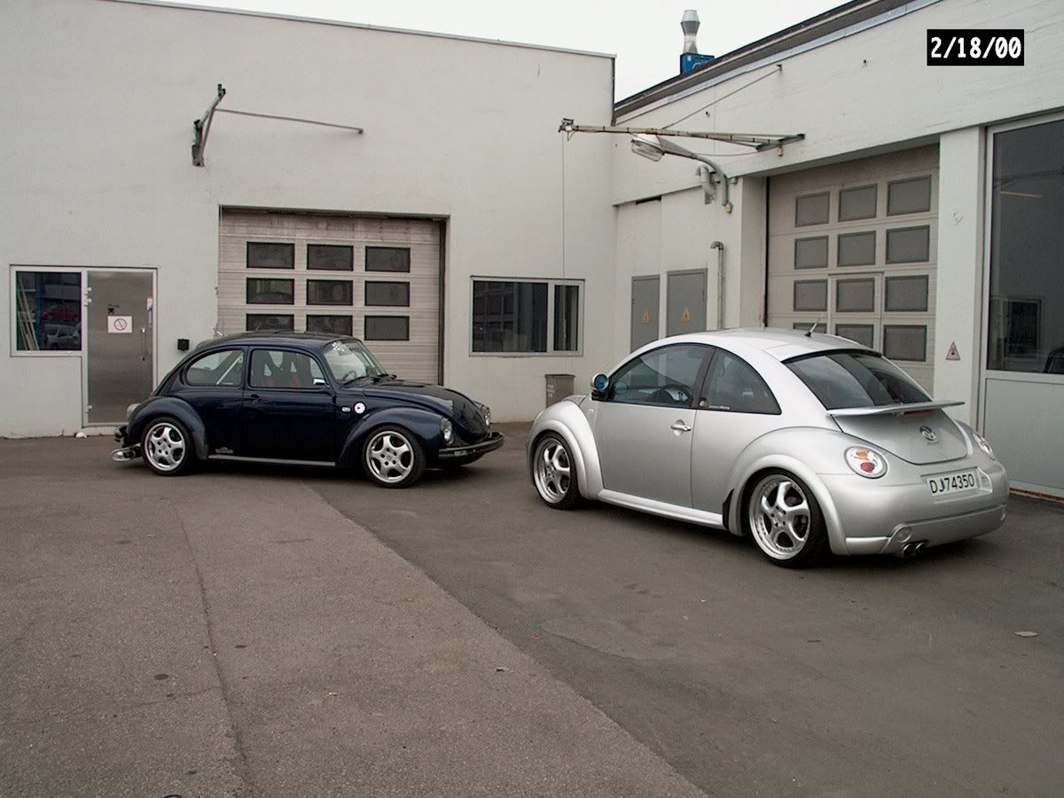

Just changed photo #2/4

New photos with the rollcage installed!

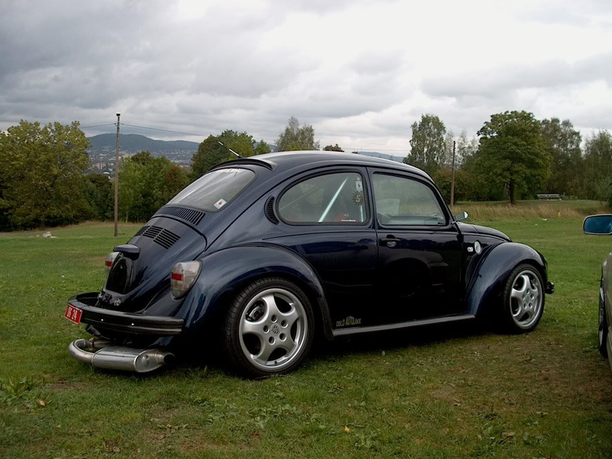

Just updated all my photos!
The car is almost finnished, and the first testdrives were really fun!
Let me know what you guys think...

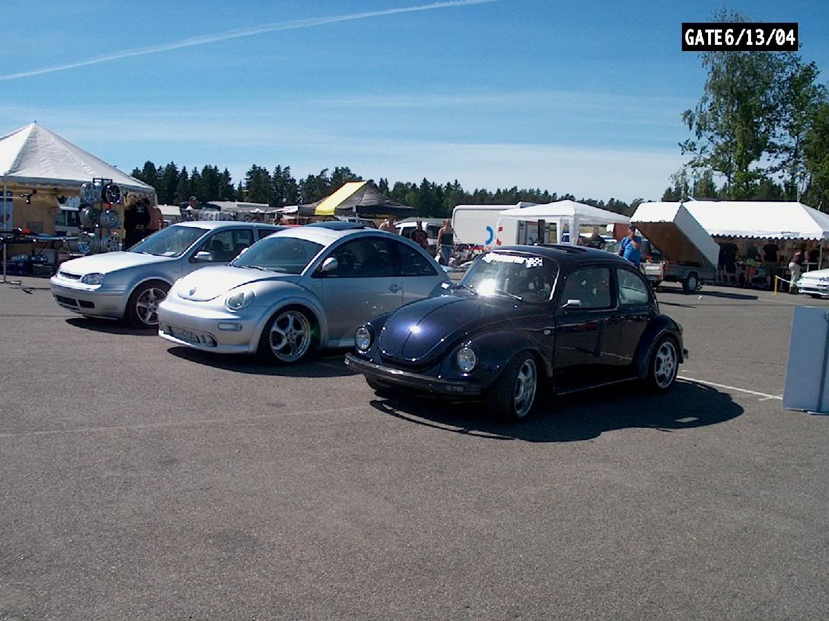

So I havent been here for a while, but here are some photos taken this summer of my two cars.

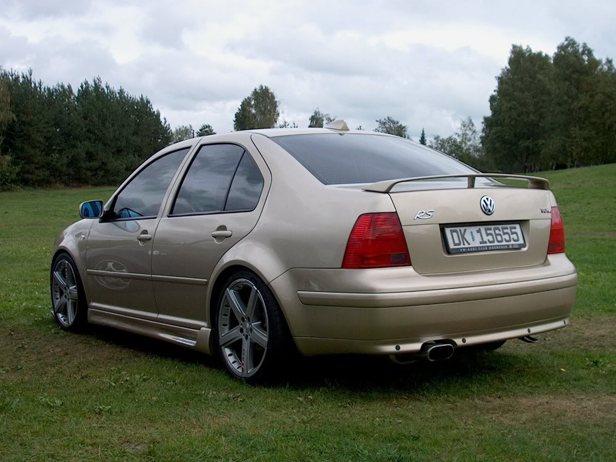

And the last ones for today, pictures of my friends Bora (Jetta) 150TDI 4 motion
