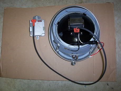

ydeardorff March 2nd 2004 20:32
HID bulbs
1 Attachment(s)
I scored a set of HID halo projector beams online for 150 bucks. These are designed to go in a 1991 civic. I am taking them apart and cutting them down to fit in my car. Should look very nice when completed

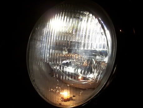

GRMNLK February 18th 2005 01:32
As requested...
these are when first turned on...
http://img.photobucket.com/albums/v3...5.jpg~original
And when warmed up...
http://img.photobucket.com/albums/v3...9.jpg~original
